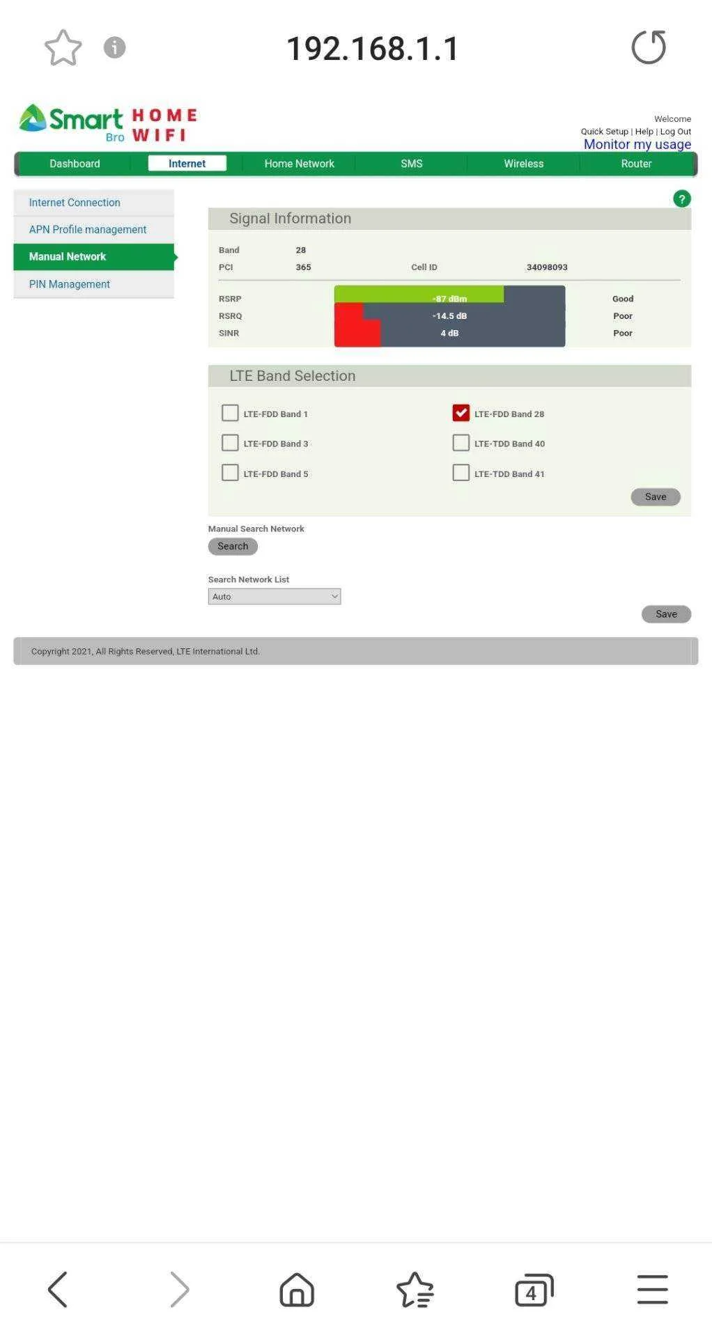

PLDT Boosteven R281 (Band Locking)
Eto applicable sa bagong order lng na Smartbro R281 from Smart store.
Kung ang habol ay telnet, ssh access at easy bandlocking.
To gain Telnet and SSH access flash ninyo R281 stock firmware ni boss Jeroum.
Kapag may access kana makaka pagopenline, manual bandlocking at change imei kana.
Para nmn sa Easy Bandlocking flash nio yun tutorial ni Boss Jhowel na Unbrick recover.
Mareretain and Telnet at SSH access at magkaka Bandlock na WEBUI ng Modem ninyo.
Unli reset yan di mawawala. Flash at your own risk.
Baka may video tutorial ka master..
unahin mo iflash yung kay Jeroum > set telnet/ssh then flash yung kay Jhowell para may bandlock.
Di na kc ako nag openline habol ko lng yung telnet, ssh ska bandlocking.
Kapag may telnet, ssh madamekana magagawa like openline saka change/remove imei.
