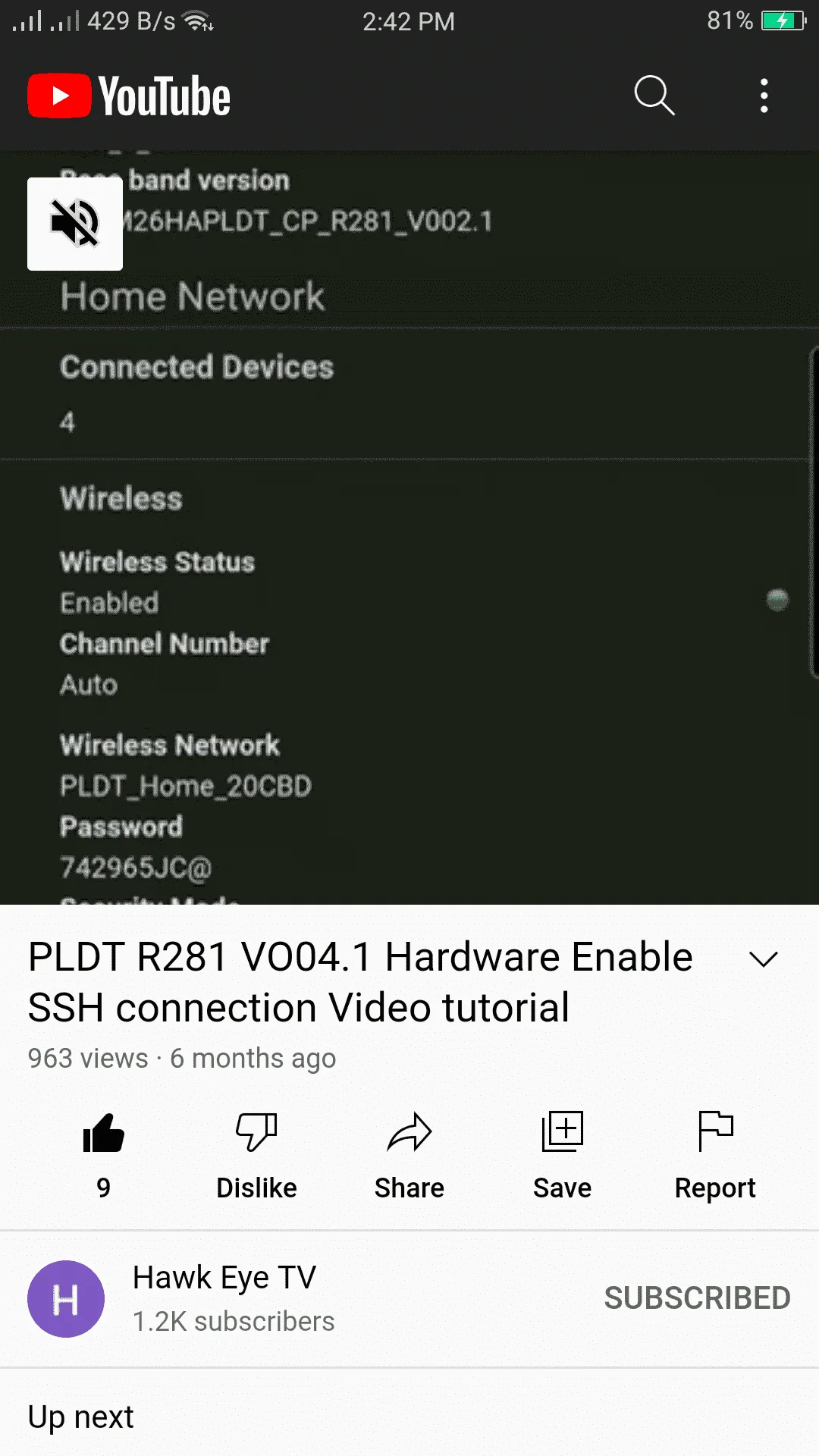

Can someone help me how to enable telnet on stock version V002/ V004
Pm me Bro, munting tulong ko sa u
Baka ma banned ako kung post ko dto naSa Yt Lodi Hawk Eye search mo na lang bigay ko tittle
PLDT R281 VO04.1 Hardware Enable SSH connection Video tutorial
Eto na video Tutorial Lods, Salamat kay Teacher Hawk Eye
Download na hehe:
