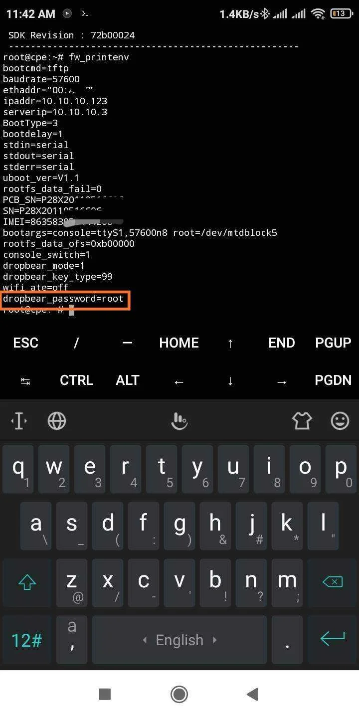

ganito na lang gawin mo pag katapos mong irun yung command na.
Code:
ubus call router set_dropbear_info '{"dropbear_mode": "1","dropbear_key_type": "99"}'
then eh change mo na yung default password ng ssh
Code:
fw_setenv dropbear_password yourpass
pag ka tapos reboot mo lang at tapos na
kahit ilang restore factory reset hindi mawawala yung password
