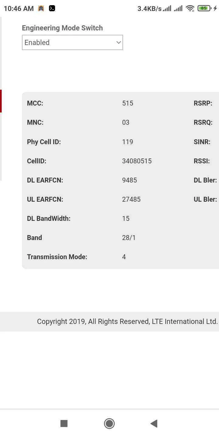

Yes Lods. There are 2 Bands that does not have Carrier aggregation yet Band 28 and Band 41. Mine is currently lock at Band 28.
all bands for r281 may carrier aggregation. depende po sa tower nyo kung supported obviously walang ibang bands yang may 28 kaya di nag CA. pwede po mag 28/3 or 28/1 if binabato din ng tower nyo yon. sa 41 naman if supported tdd lte pwede po mag 41/41

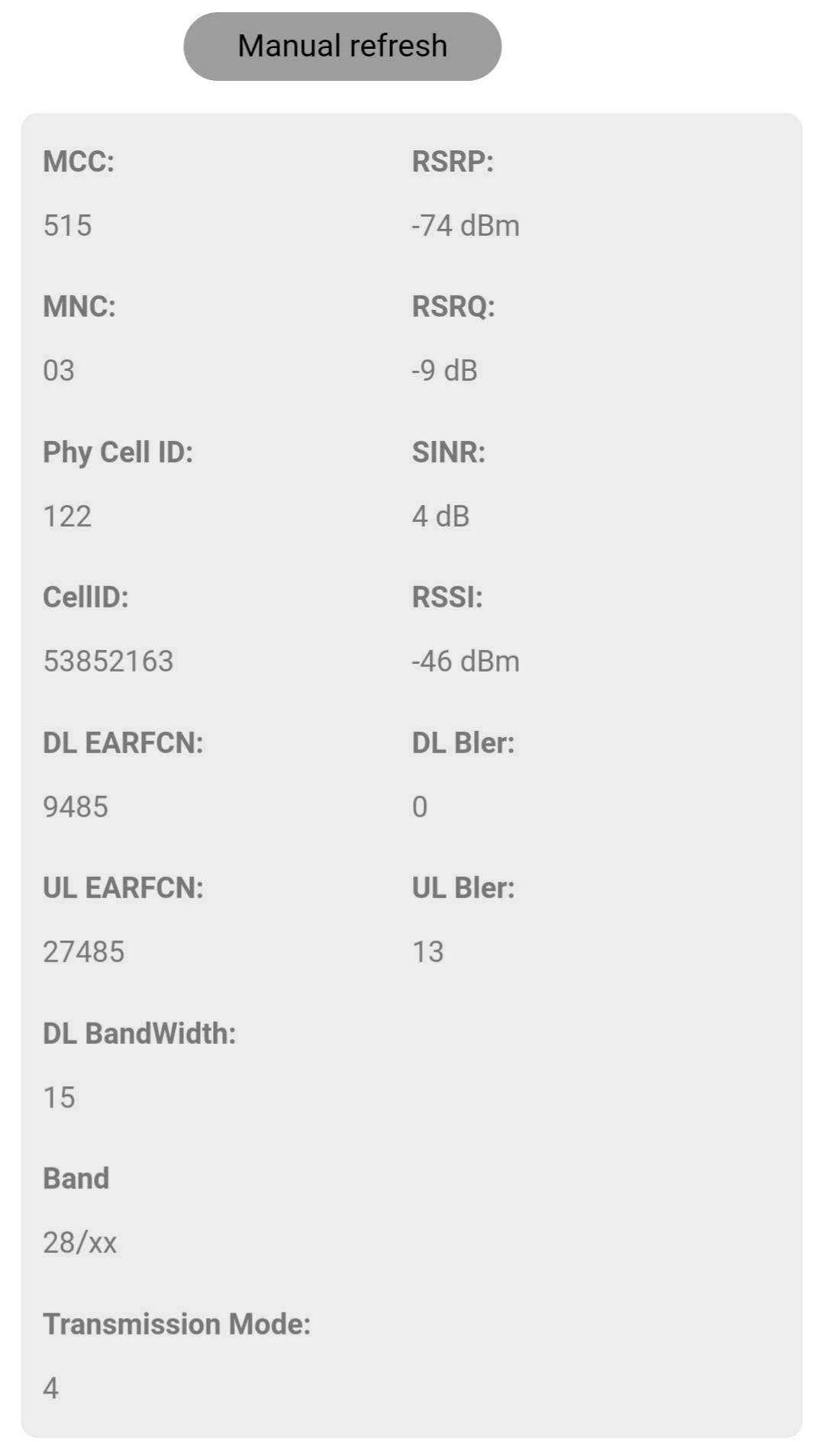

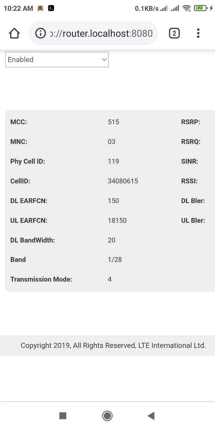

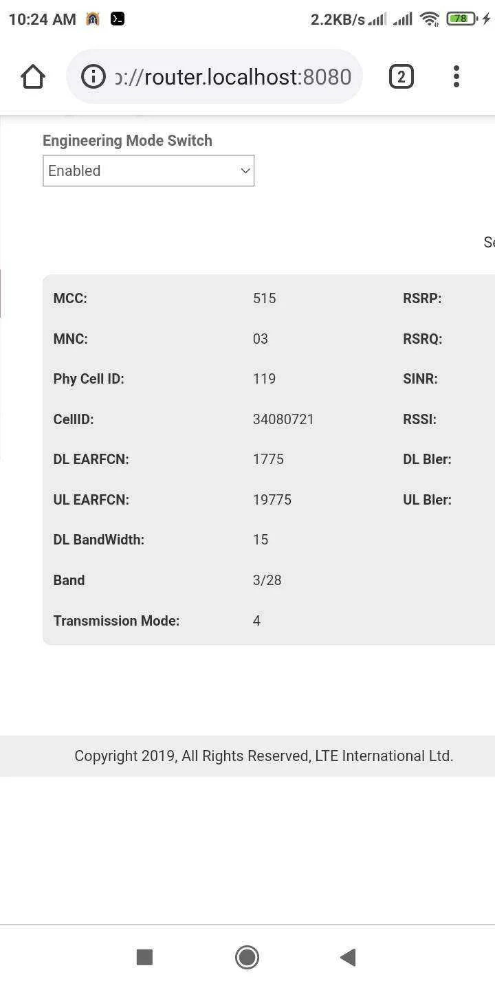

Lods try mo naman i lock sa Band 28 freq 9485. Modem mo naka lock sa Band 1 freq 150 at Band 3 freq 1775. Pa try naman Band 28 freq 9485 or check mo ano freq ng Band 28 sa inyo. Thanks
