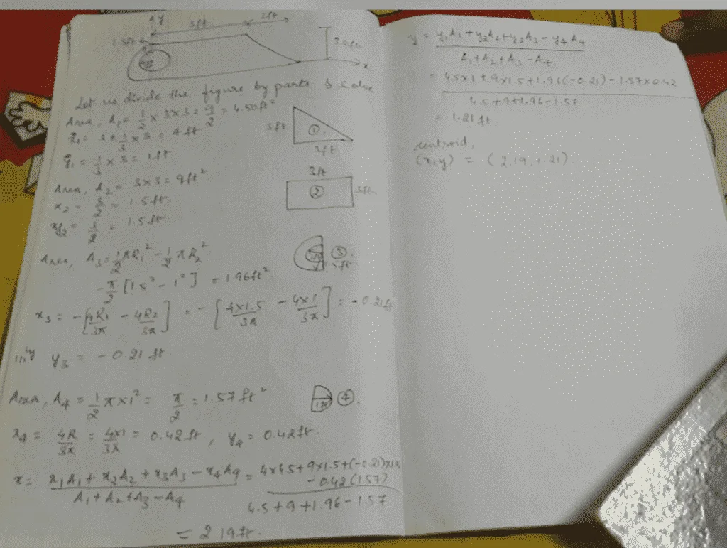

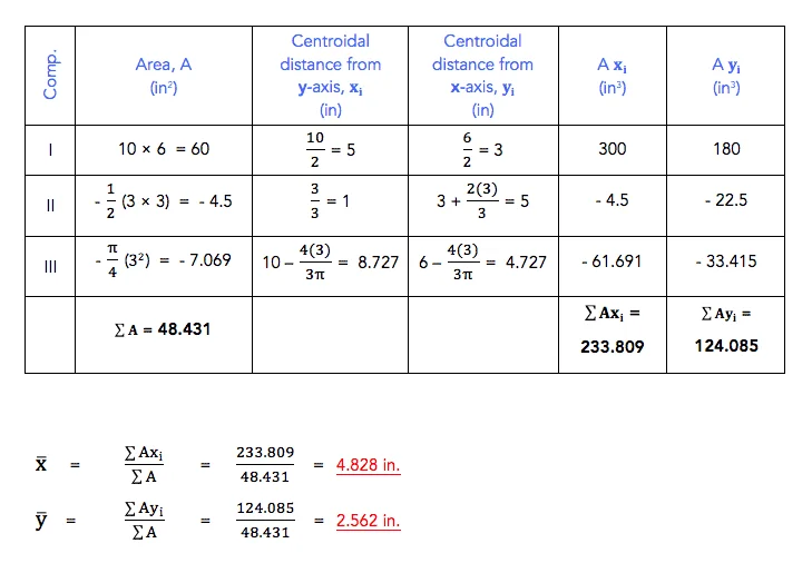

Sa may mabubuting puso jan pa unlock nman nito mga lods🙏🙏🙏
Çℎḙḡḡ Links:
https://www.Çℎḙḡḡ.com/homework-help...osite-area-measure-outcomes-e-q15340735?hcb=1
https://www.Çℎḙḡḡ.com/homework-help...e-centroid-x-y-composite-area-q12152859?hcb=1

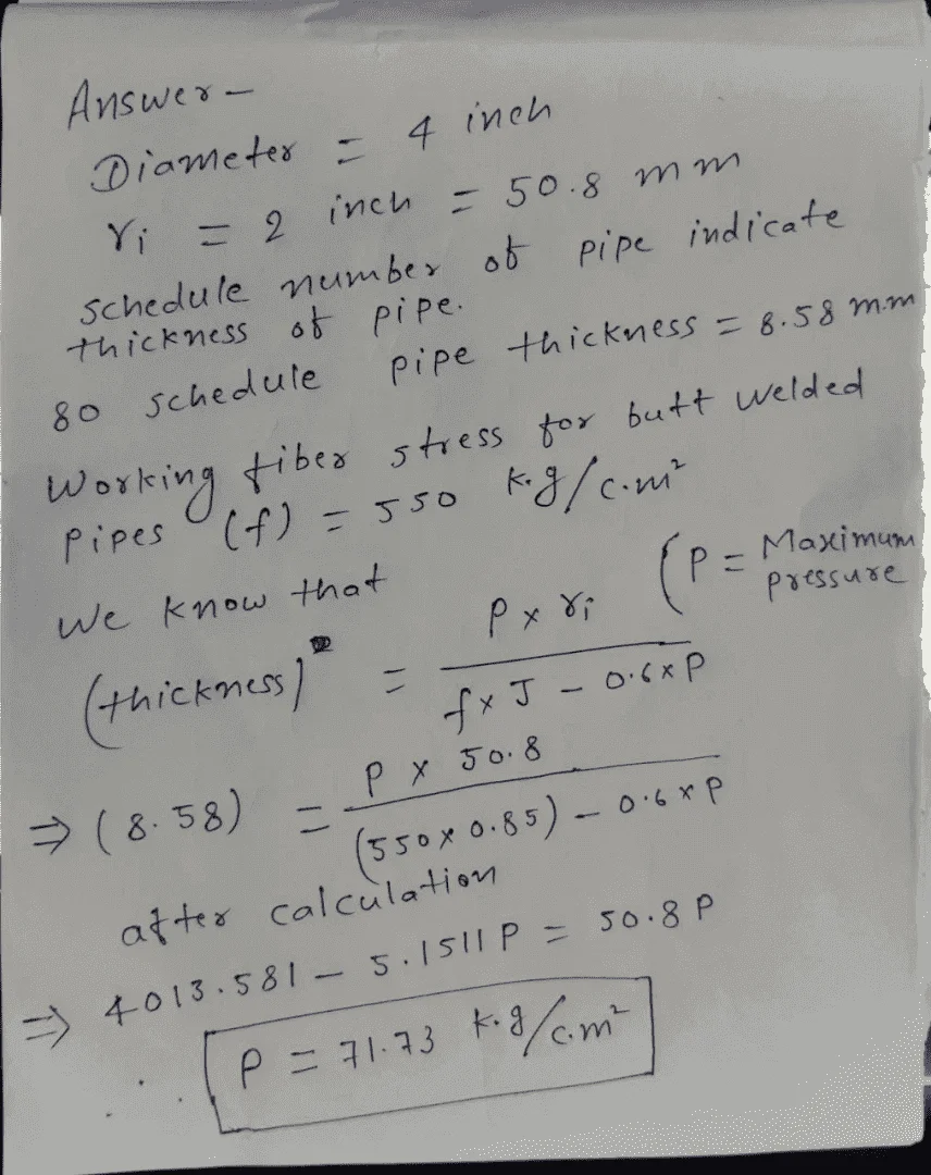

https://www.Çℎḙḡḡ.com/homework-help...ressure-steam-pipe-joints-****-weld-q75076964
pa unlock 🔓 nmn po, need lang po. thanks in advance po.
