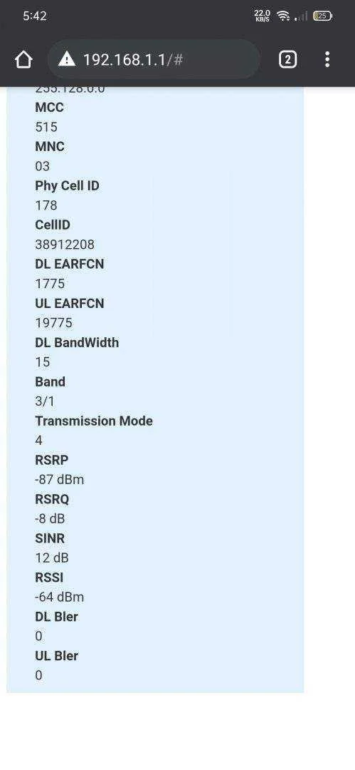

[XX='EugeneKey, c: 1121994, m: 1668473'][/XX] ubus call cm set_cell_lock '{"mode":"2","act":"3","band":"3","freq":"1775","cellid":"178"}'
Sir is this the right code to lock band 3/1?
[XX='EugeneKey, c: 1128027, m: 1668473'][/XX] Yes sir but the second band is my problem. Usually band 3 is the first in my area like 3/1 and it has a speed of 150 mbps. But when it switches to band 3/28 then i get lesser speed. Any idea how to maintain the 3/1 band?
[XX='Daigo26, c: 1128294, m: 59978'][/XX] if with freq 1775 router use 3/1 and with freq 1350 router use 3/28, then you should lock to freq 1775, to do this try to execute this command:
ubus call cm set_cell_lock '{"mode":"1","act":"3","band":"","freq":"1775","cellid":""}'
with mode 1 it should be lock to freq, not to the cellid

Sir I have the same problem in band 1 as you suggested, I used mode 1, it works for around 5 mins then the same problem occurs. as I open the admin ui it is stated that I am connected to band 1, freq 150, pci 406 but no internet connection.
