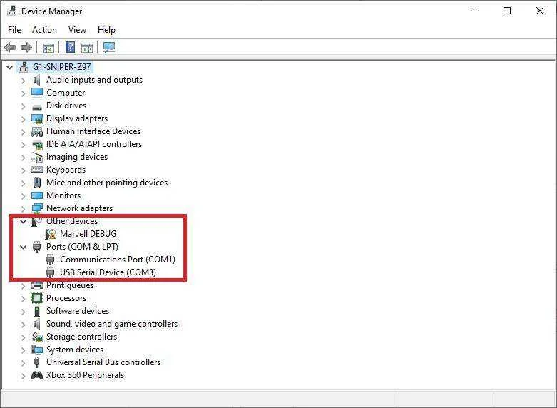

Last week pa nag auto-update yung PLDT R281 Boosteven modem ko after ng major update ng Windows 10 Version 20H2.
May missing Marvell DEBUG driver sa Device Manager, hindi na compatible sa Huawei Modem Terminal.
1 week na din ako naghahanap ng solution, wala pa rin akong makita, kahit driver update ng Huawei Modem Terminal wala din ako mahanap.
Anyone has a solution or fix, please post it here. Thanks!

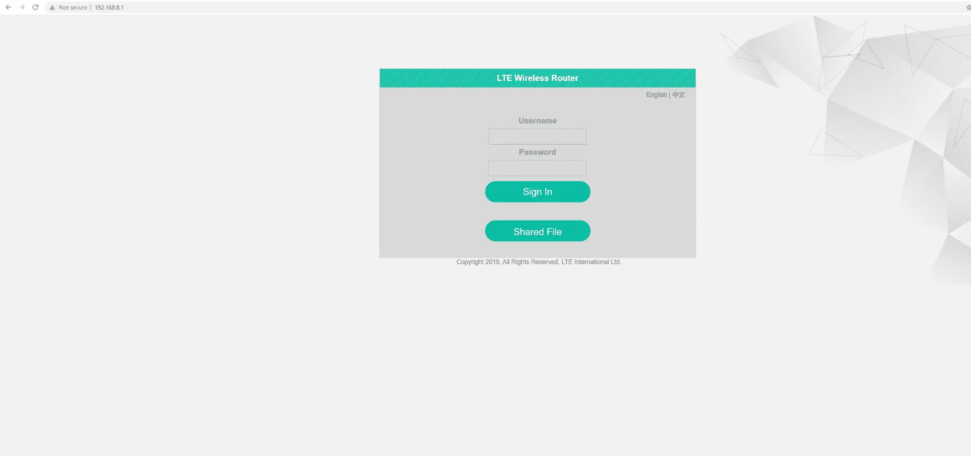

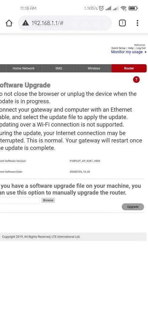

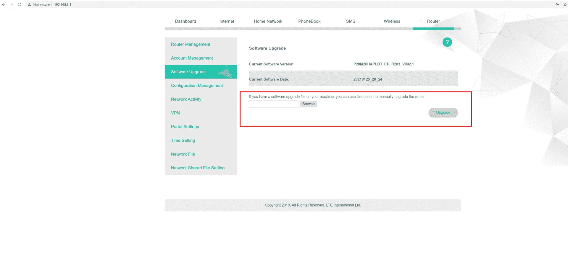

I found out this one.
Take out the sim card then connect the router to PC using micro usb.
Access 192.168.8.1 with
User name: admin
Password: admin
We can see the upgrade function. It means if we have the previous software version we can roll it back.
Login.webpDB.webpBut, I think it is hard to have one since it is not public releasing.
hello po.
If okay lang sana maghingi ng configuration mo?
Bale punta ka sa login ng pdlt>Router na Tab>System Setting>Configuration Management>sa baba meron export configuration file. Ittry ko lang sana, baka sakali marestore yung modem ko.
