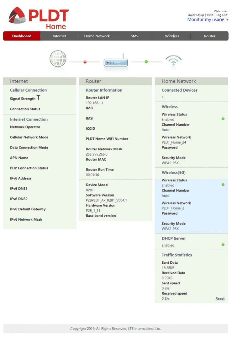

❓ Help PLDT Home R281 nag update ng Software Version (v004.1). Openline di na gumagana.
Nag update ang PLDT Home R281 and hindi na gumagana yung openline na AT+CLCK="PN",0,123456,16
Error na ang nakalagay.
Also, openline na sana ako kaso after the update RED na ang signal. Kaya nag system restore ako planning na i-openline ulit kaso error na yung AT+CLCK="PN",0,123456,16

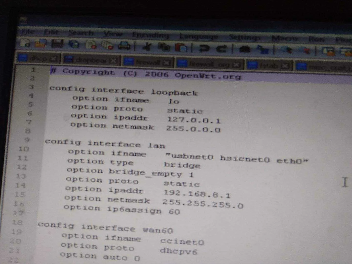

So I decided to see how the router works a bit. I was able to get root access to 192.168.8.1 via ssh when connected via usb.

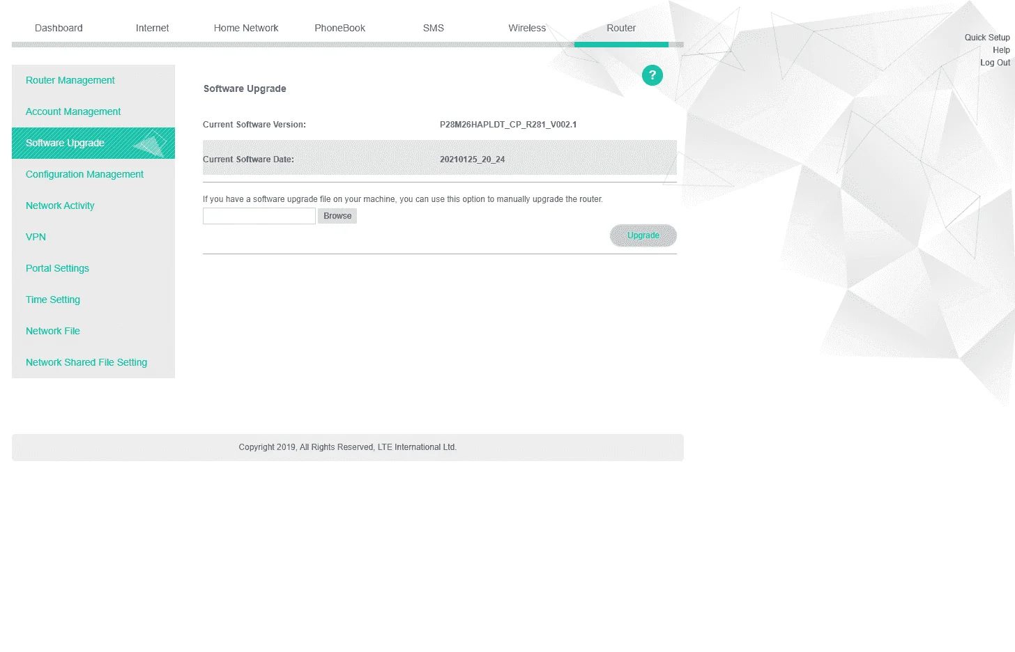

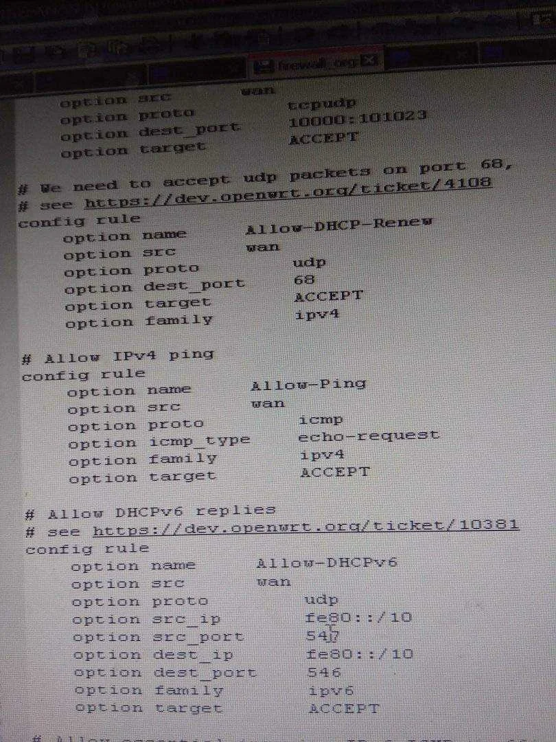

Ok, I got root access to openwrt, but it seems I cannot change nothing. As far as I understand, two different configs are used, and from the debug we cannot access the main one. If you connect to 192.168.8.1 via usb, you will see that the interface is different and the service firmware = P28M26HAPLDT_CP_R281_V002.1

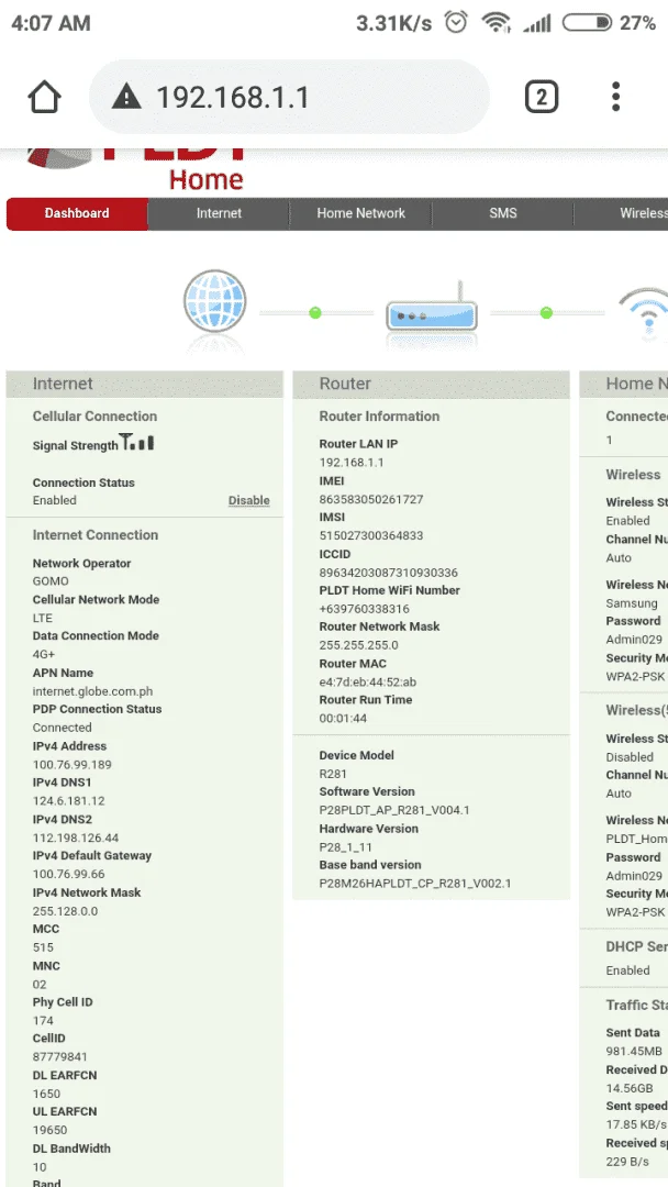

The main firmware if you connect to the router via WiFi = P28PLDT_AP_R281_V004.1
As you can see, these are different firmware and having access to the service firmware, you cannot change the main one.
How it is physically organized, I do not know, perhaps it works through some kind of virtualization, two firmwares simultaneously work in isolated containers.
The router is arranged like this, the WiFi router with OpenWRT and external LTE modem on a Marvell PXA1826 chip is connected via PCI-e
The service firmware only allows is to access the LTE modem device and send AT commands to it.

It's not frimware, it's config for service Openwrt. It gives nothing, I checked all these files

A couple of weeks ago it auto-update to v004.1 but the baseband was still on v002
I tried and still able to perform AT commands without issues, until it stucked o bootloop.
Now, it cannot read PLDT SMART Sim or other network sim, the LTE modem seems malfunctioned, but I can still access the web ui and there's no baseband version listed.
Are you have access to 192.168.8.1 WebUI if you connect via micro usb? And what version is it? v002 or v002.1?
No, cannot access WebUI at 192.168.8.1 via micro usb... :( The modem keeps restarting after it boots up a few seconds. I think it got soft brick when it tried to auto-update its baseband version?
But my other R281 modem with software v004.1 and baseband v002.1 - I can access the WebUI at 192.168.8.1 via micro usb.
