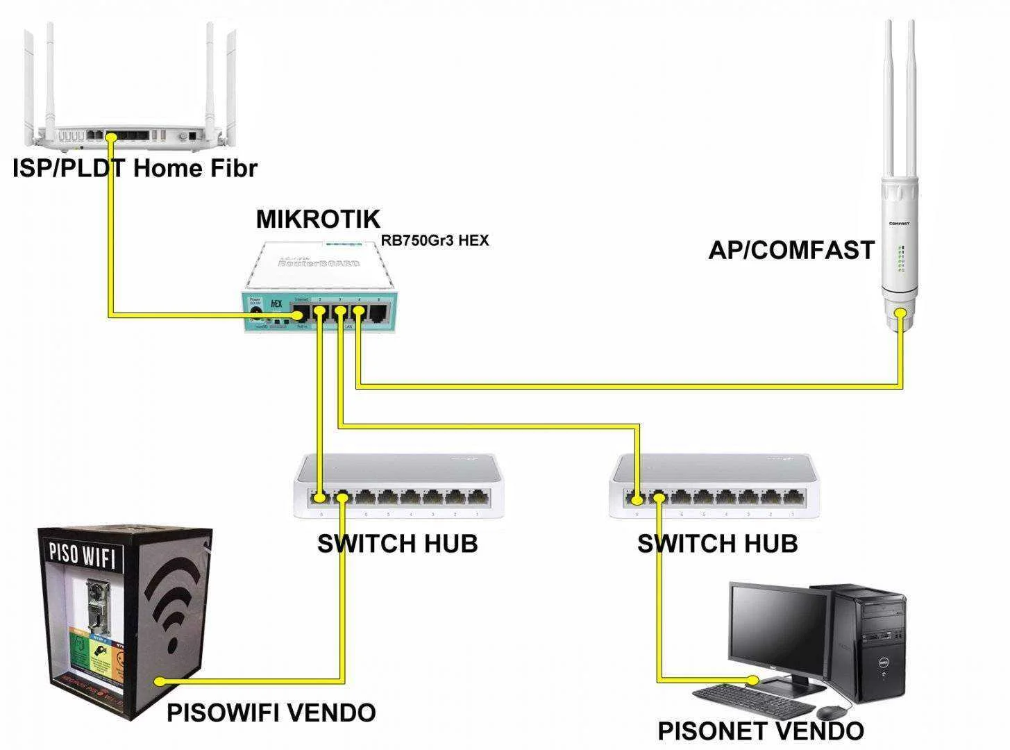

Hello po. I was wondering if there is someone that could help me. To achieve this kind of layout. Ano po ba yung first thing to do? :(Vendo machine - next level.webp
1st step, mag-decide ka kung bridge mode yung pldt modem/router o hindi. Bridge mode setup is a little bit complex vs non-bridge. Advantage, iwas double NAT.
Kapag hindi naka-bridge mode, magdo-double NAT yung network mo which is not good.
2nd step, allocate different IP subnet sa bawat interfaces ng mikrotik.
3rd step, enable DHCP on all interfaces except sa WAN port (yung connected sa pldt modem/router).
4th, setup your access control, eg firewall, bandwidth control etc
5th, optionally setup your own dns resolver.
Salamat po. parang mahirap yata ang pag config nito . without higher knowledge in networking
