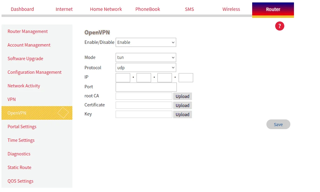

PLDT HOME V8 STOCK MODIFIED with bandlocking + OpenVPN
____________________
UPDATE**
ChangeLog * update OpenVPN 2.4 to OpenVPN 2.5_rc3 *update OpenSSL 1.0.1j to OpenSSL 1.0.2
WEBGUI
r051.com or 192.168.1.1
pass
pldthome
OpenVPN
r051.com:81 or 192.168.1.1:81
default login
admin
admin

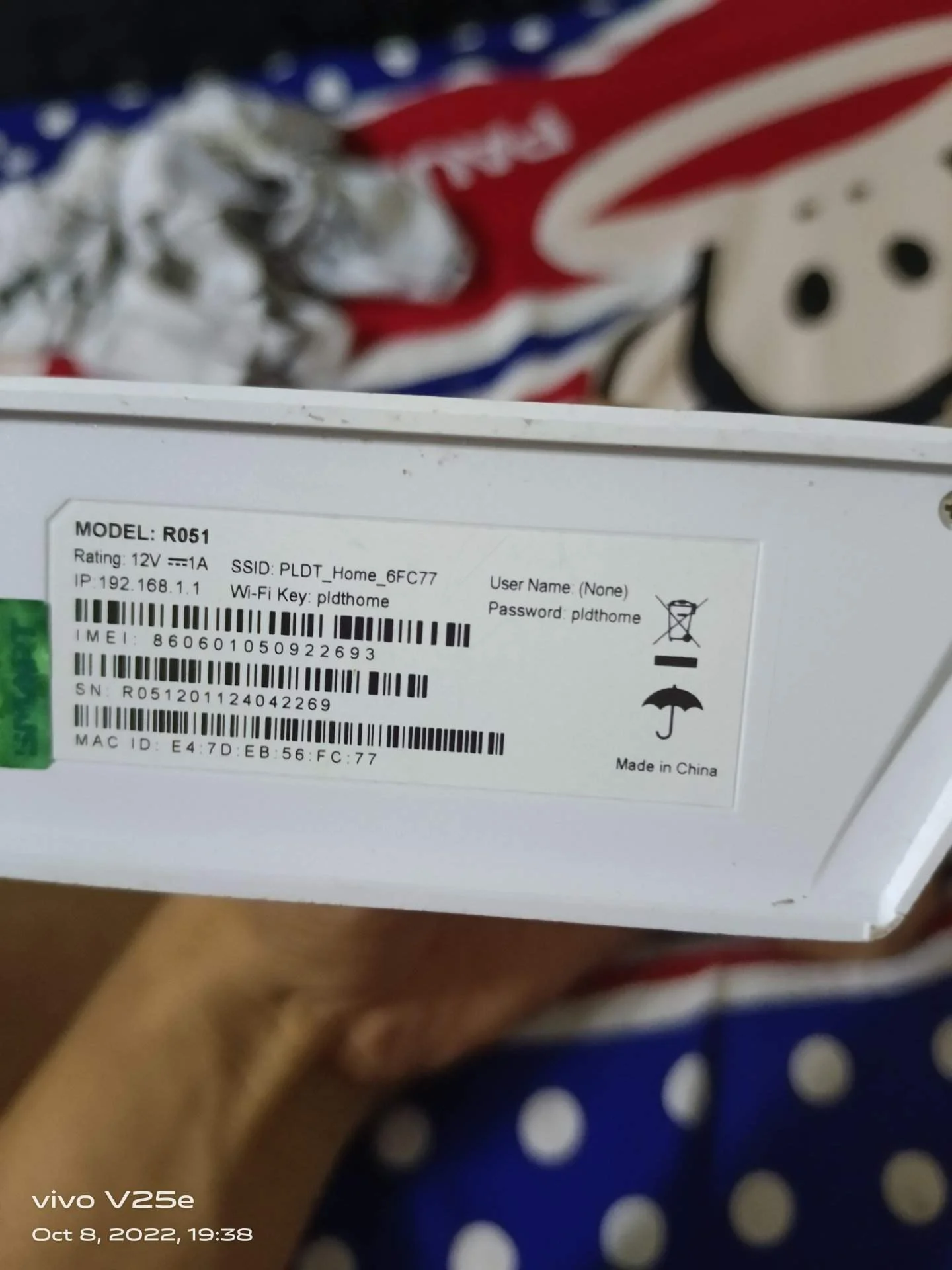

not working ts may firmware kasi ni paps jeromelaliag yung r051 ko
pano ka ba nag flash boss via web upgrade or tftp?
Baka po pwede paonpenline
i flash monalang yung firmware boss
