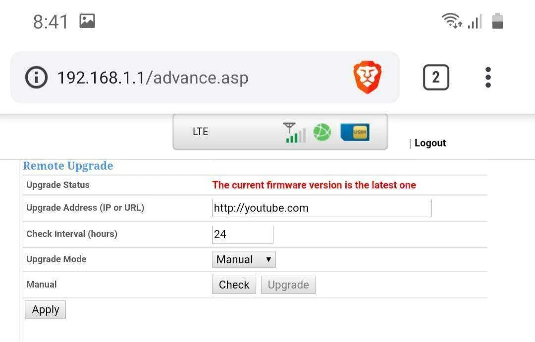

Bumabalik siya sa latest version dahil sa advanced settings ng FX-ID3 mo di mo napalitan yung update setting niya at bumabalik talaga yan dahil auto update yung software niya by default, dapat palitan mo yung link sa update option ng ibang link para disable yung auto update ng pldt mo. At kung maguupgrade ka dapat wag mong ifactory reset baka di mo namalayan na pati yung settings ng update panel niya bumalik sa factory default ulit. Sana makatulong.
Ano po kaya problema, kahit anong bago ko sa advance settings like adding new apn or enable band selection, bumabalik lang sya sa defult and nabubura yunt new apns, napalitan ko na naman yung url ng upgrade address. My firmware is 1.2.4, eto na yung naabutan ko, siguro nagupgrade nung pag on ko yesterday (kakaacquire ko lang secondhand). Thanks!20201024_204203.webp

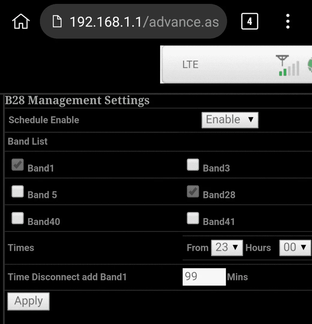

May idea kayo bat walang internet kapag mag select ng band sa b28 management? Pero pag nagreset and naka disable b28 may internet naman di nga lang maka select ng band. 🤔

Ano po kaya problema, kahit anong bago ko sa advance settings like adding new apn or enable band selection, bumabalik lang sya sa defult and nabubura yunt new apns, napalitan ko na naman yung url ng upgrade address. My firmware is 1.2.4, eto na yung naabutan ko, siguro nagupgrade nung pag on ko yesterday (kakaacquire ko lang secondhand). Thanks!View attachment 998198
Regarding APN, niwait niyo po bang lumabas yung settings have been saved? Medyo matagal kasi lumabas yan. Pag oo, set niyo yung APN under network setting, tapos baba kayo sa may remote upgrade, select your apn set as default and save. Regarding band, downgrade ka muna to 1.0.1 tapos set it on your preferred band (may tutorial sa 3rd page ng thread re: this) tapos upgrade mo to 1.2.4. Hope this helps.

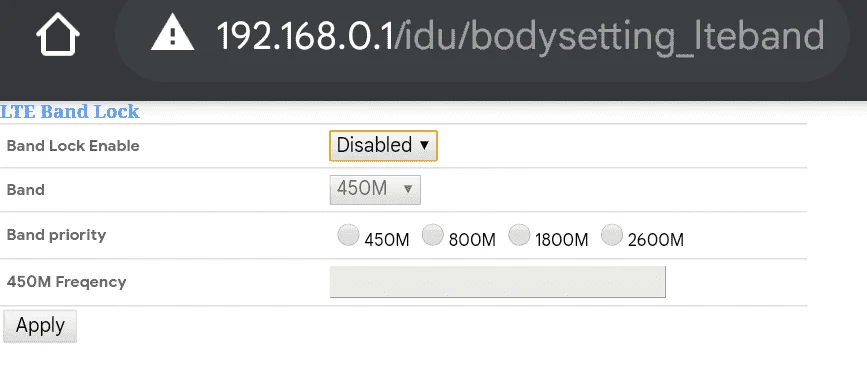

I like this green theme more than the red. And this also presents more webui settings than the v1.1.0 so you don't have to hunt for them. 😊 The only caveat is that 'B28 Management' is missing under 'advance.asp', but you can have this back by using this url path 'idu/bodysetting_lteband.asp' 👍
