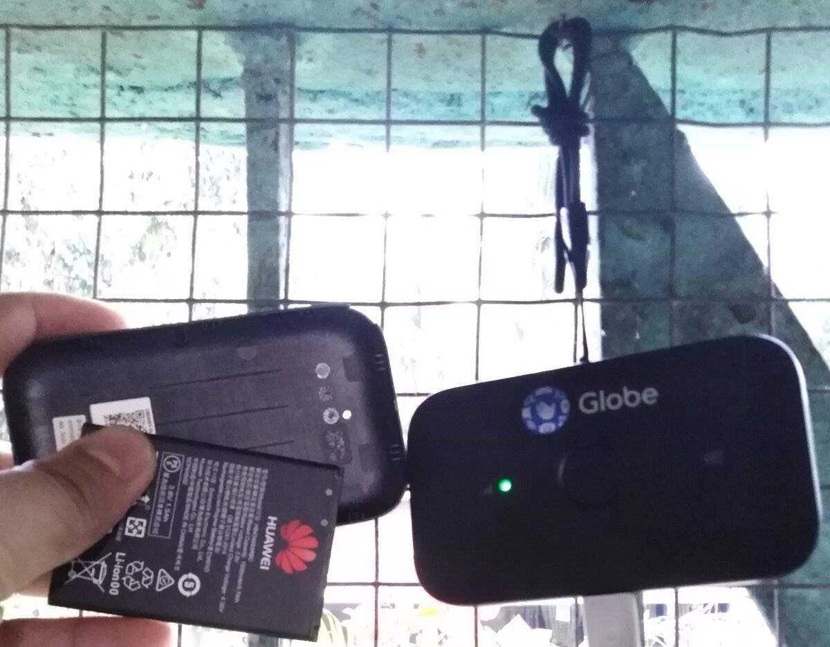

pinag apply ko ung code na withouth battery mag function parin.. pero not working... ehhh
pano po ba.. nung pinag alis ko ung battery nag led flash green both battery and wifi indicator?
my way po ba na withouth battery mag oon ung pocket wifi ? please help me.. bloated na ung battery.. tig lagyan ko lang rubber tas tinali ko sa wifi hahahaha .para hindi na mahulog malaki na ehh nanganak na
Eto ang command via telnet.
Enabled
atc AT^NVWREX=50364,0,4,01,00,00,00
Disabled
atc AT^NVWREX=50364,0,4,00,00,00,00
Via dc unlocker.
Enabled
AT^NVWREX=50364,0,4,01 00 00 00
Disabled
AT^NVWREX=50364,0,4,00 00 00 00
