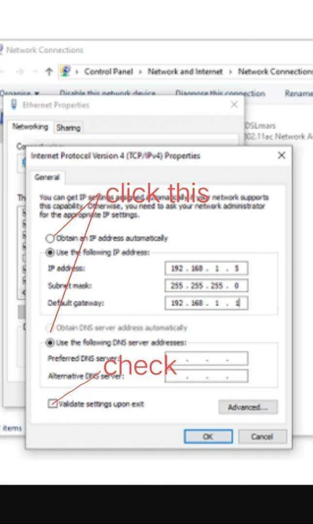

boss, pano po yung B593s-22 na unidentified network?, kahit gawin static di na po napapasok yung portal nya sa browser
Try mo itong nasa picture.
Open cmd (run as administrator) type:
Ipconfig /release (then enter)
Ipconfig /flushdns (then enter)
Ipconfig /renew (enter)
Wait for 1min. To check the ip of the modem, go to cmd (run as administrator) again. Type:
Ipconfig /all (enter)
Hanapin mo yung gateway nung adapter kung saan nakasaksak yung modem mo.
