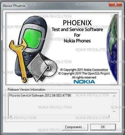

  • Phoenix software, You do not have permission to view the full content of this post. Log in or register now.

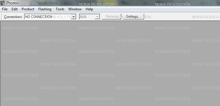

  1. Connect your device via USB cable and make sure it’s turned OFF. Run Phoenix software. Select “NO CONNECTION” as connection type.

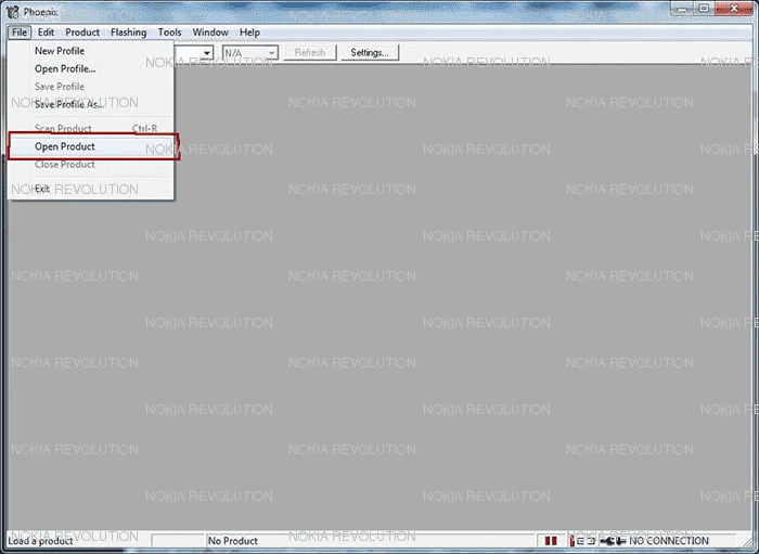

2. Click File then select “Open Product”

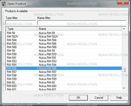

3. A window will appear, select the device model and the corresponding product code of your phone. To find your product code – Press *#0000# on your dialer while your mobile device is on.

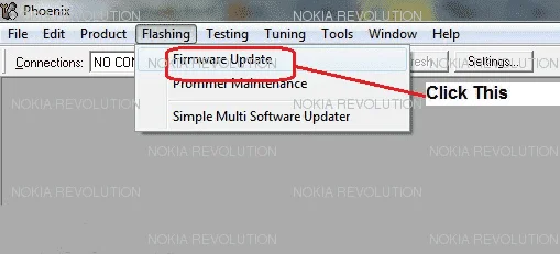

4. elect “Firmware Update” option in “Flashing” menu.

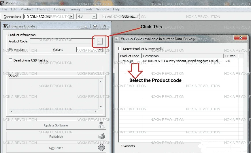

5. Press “…” button on the top-right corner of the window to select the language pack/product code You want to use on your flashing. Click on the product code /language pack that you have selected and press OK button.

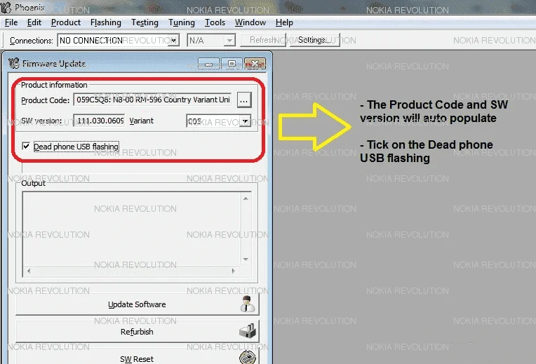

6. It will now show the Product code you have selected. Tick the “Dead phone USB flashing”.

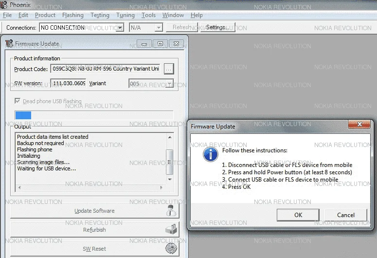

7. Click on “Refurbish”. Then you’ll get a pop-up window, follow the instruction. If it did not work, best option is to Disconnect the USB cable from your device. Press and Hold the Power button of your phone for 8 seconds. Once it vibrates, release the Power button and immediately connect the USB back into your phone’s port. Then you should see the flashing starts.
  1. After some seconds of flashing, it will pause and prompts for the same instructions as above. Do the same trick as mentioned in Step #7.
