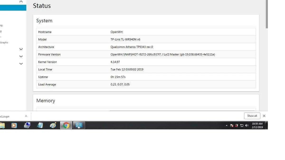

CFW RELEASE: BUILD DATE: FEB 11, 2019
NO RAM EDITION
Instruction:
1. Flash
a. use factory bin file kung naka-stock tplink firmware pa kayo
b. use sysupgrade bin file for those user who are already on openwrt firmware
2. Go to Luciwebgui You do not have permission to view the full content of this post. Log in or register now.
3. Click Services -> Openvpn
4. Pili ng server na gagamitin, click edit change nyo username and password
kung wala pa kayong ssh zild vpn account check this thread https://phcorner.org/threads/675886/
5. Click enable tick box, save and apply
sa akin po mang-gagaling yung cfw bin files na ifflash. ifflash mo yung using tplink fimware upgrade page.
sa ngayon relax ka lang habang ina-antay mo yung router mo. wag ka muna mag-isip isip ng mga kung ano ano.
magbasa basa ka lang ng thread post from page 88 to 84, i think sapat na yun para maka-kuha ng mga ideas
about this cfw.
