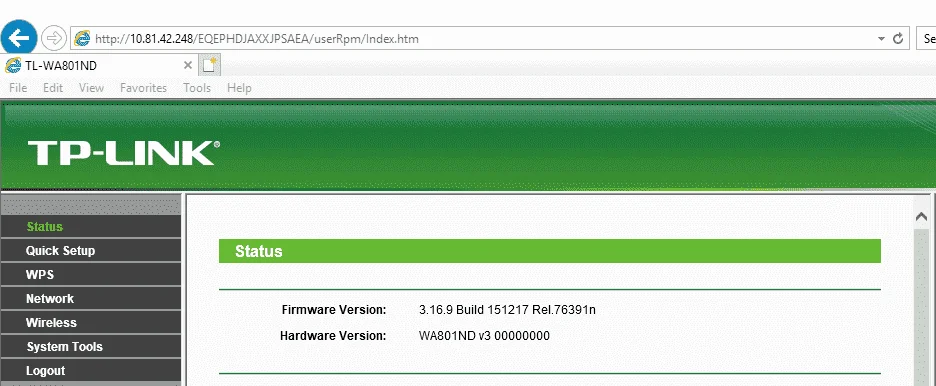

sensya na sir. late reply. busy lang talaga. pasilip silip lang ako dito sa phc. anyways about your router. i found out na naka-locked na pala firmware ng ganyang router starting from version 3. Nag-tataka kasi ako kung bakit nag-eerror sayo yung cfw build ko since sa pagkaka-tanda ko nung binuild ko yun eh wala naman akong na-encounter na error sa image builder kaya nag-search ako openwrt page and here is the info that i got...
"Since v3 hardware, TP-Link has started shipping with the new locked TP-link firmware. Investigation into this locking mechanism is still in progress, but the device does support tftp flashing. To use this feature, press and hold the reset button while powering on. The device will use the ip address 192.168.0.86, and attempt to load a new firmware from a tftp server at 192.168.0.66. The v3 is looking for the file: wa801ndv3_tp_recovery.bin. Rename your openwrt-ar71xx-generic-tl-wa801nd-v3-squashfs-factory.bin file to wa801ndv3_tp_recovery.bin, confirmed working as of trunk r49037. "
sir subukan mo yang procedures na nilagay ko diyan.
may cfw builds are targeted for tplink router that has unlocked bootloader. check mo kung gagana yang procedures na yan.
