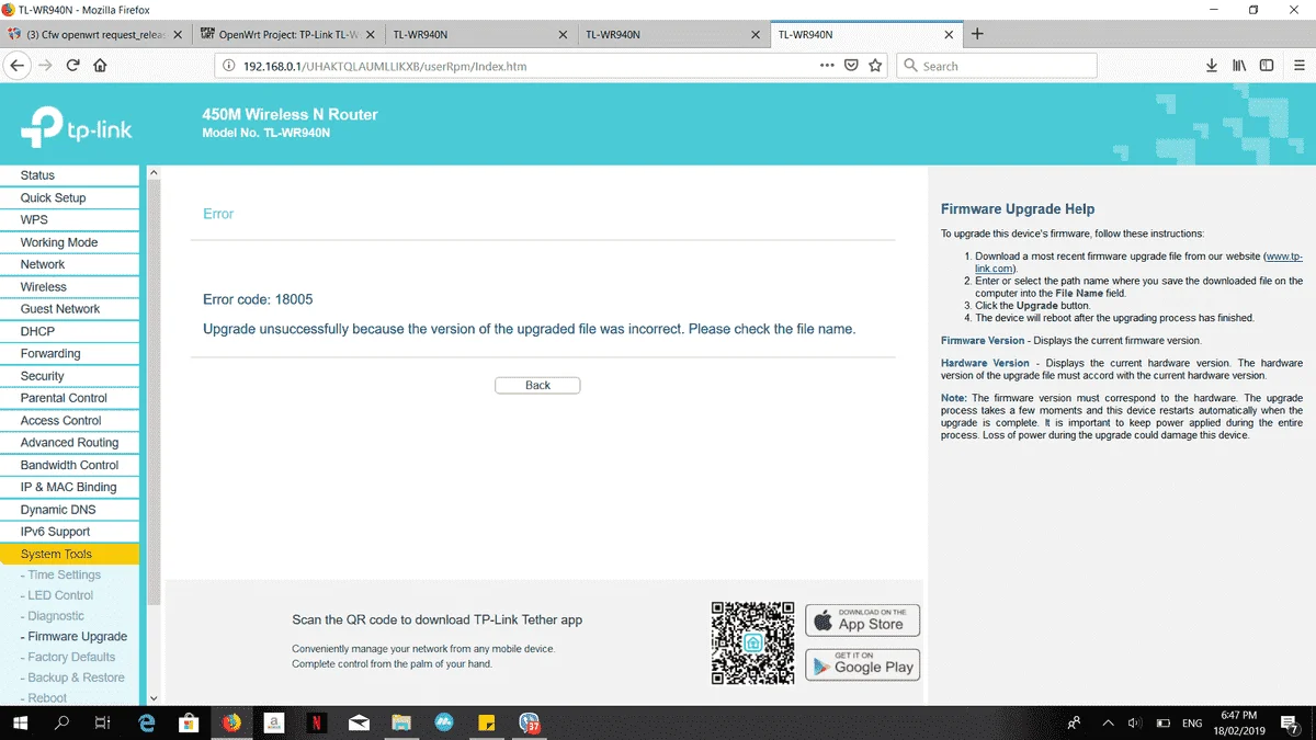

sir good evening nag try ako mag upgrade ng firmware thru web.pero lagi ito sinasabi..see screenshot..lahat na yata ng firmware nasubukan ko na..stock pa lang firmware ko
tplink wr940n v6
tplink wr940n v6
Pag stock tp link pa ang firmware yung may factory ang iflaflash

INSTRUCTION:
1. Flash
a. use factory bin file kung naka-stock tplink firmware pa kayo
b. use sysupgrade bin file for those user who are already on openwrt firmware
(uncheck keep settings on firmware upgrade option to avoid errors)
