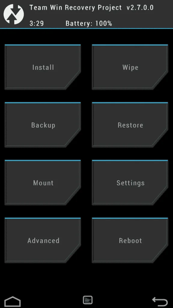

To boot into recovery use your recovery combo buttons. If you don’t know which buttons to press, to access recovery, You do not have permission to view the full content of this post. Log in or register now.. On most devices it is Hold Vol Down + Power for 5 seconds. Once you are in recovery, you should see something like this…
image001-576x1024.webpThis is TWRP! Woot!
You do not have permission to view the full content of this post. Log in or register now.And this is ClockworkMod! Double woot!

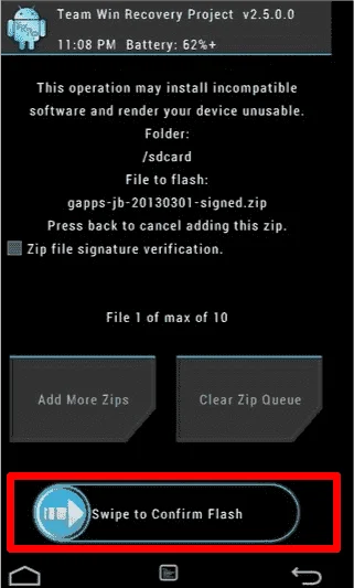

Once you have selected your ROM file. Proceed to flash the zip…
image101.webpApply update in TWRP
You do not have permission to view the full content of this post. Log in or register now.Apply update in ClockworkMod
image032.webpFlash the file with TWRP
You do not have permission to view the full content of this post. Log in or register now.Flash the file with ClockworkMod

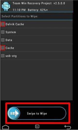

Step 4: Clear Cache
After the install is complete, back out and clear your cache…
image013.webpWipe with TWRP
wipe.webpWipe with ClockworkMod
