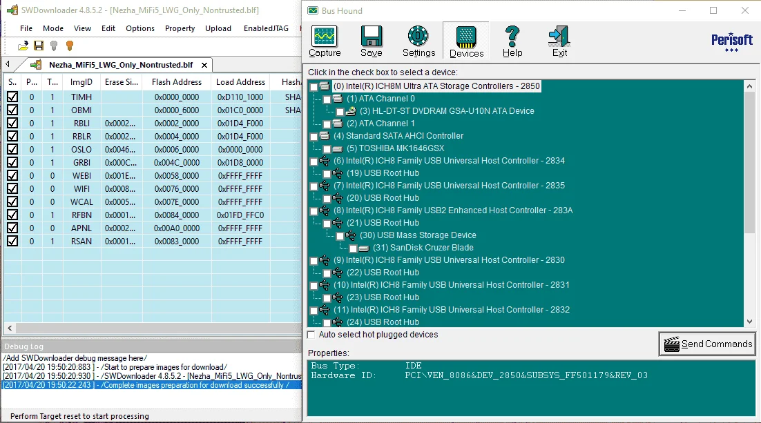

Run an instance of SWDownloader and try burning any firmware to any M028T device as this will put the device in download mode which is what we need.
After that, open BusHound and go to the device's section. Tick on the Marvell WTP device together with the "auto select hot plugged devices" checkbox as shown in the images I've provided.
That's it. You'll be ready to start capturing.
Now just plug any flashable modem and make sure you tick the 'Erase All Flash' option.
That's what I want captured.

You can complete the burning process. As long as the Erase all flash option is checked, it'll be good.
Hit the "Save" button next to "Capture", this will save the captured output as a text file.
Type anything on the comment section.. something like "successful_burn", select the "text file" radio button then hit save.
Type "successful_burn" under file name and choose any writable location to save the text file.

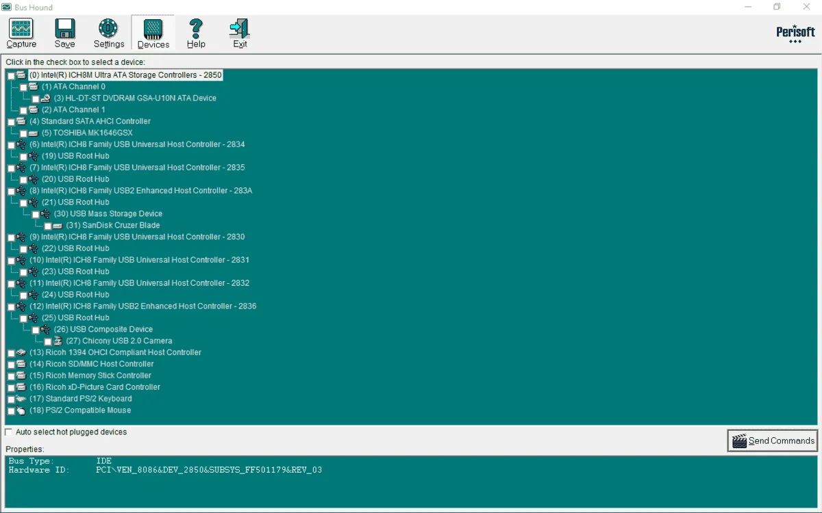

Sorry if I seem daft here but I can't seem to locate "Marvell WTP device" under the Devices option while SWD has been put to download mode too. Must I connect the device before the "Marvell WTP device" will be available?

Yes.. the device has to be connected. Do this, flash the device like you normally would.
And while it's burning the firmware, go to the devices tab of Bus Hound and locate it (the Marvell WTP device)
Make sure to tick the "auto select hot plugged devices" checkbox so that it's selected automatically the next time it's plugged.
Then go again and flash the firmware for a second time, this time, go to the capture tab and select run on the lower right corner.
You should see some output.
