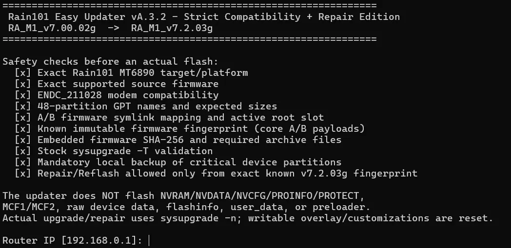

FIRMWARE UPDATER V7.00.02g --> V7.2.03g (BETA)
Download Link: You do not have permission to view the full content of this post. Log in or register now.
KNOWN BUGS for V7.2.03g:

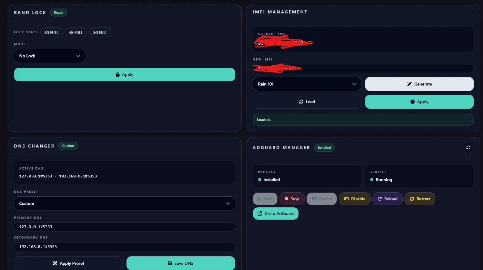

After ko mag-update from V7.0.00.2 to V7.2.03g, nawawala ung last known bandlock settings upon reboot. However I managed to fix it in my unit kahit i-factory reset ko pa.
If this also happens to you, I'll send to you the band lock fix files if mag-work din sa inyo and all users who use v7.2.03g.
Sample Screenshot:

Hi Sir, Update lng nag upgrade na sya pero stuck sya sa waiting for stable ssh connection, then nag force closed yung script

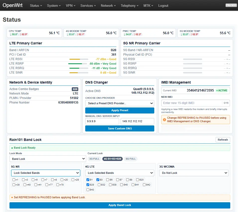

May way ba para ma-enable force CA sa the101 under 4g para maging 4g+ at dumami ang anchoring bands ni 5g nsa?

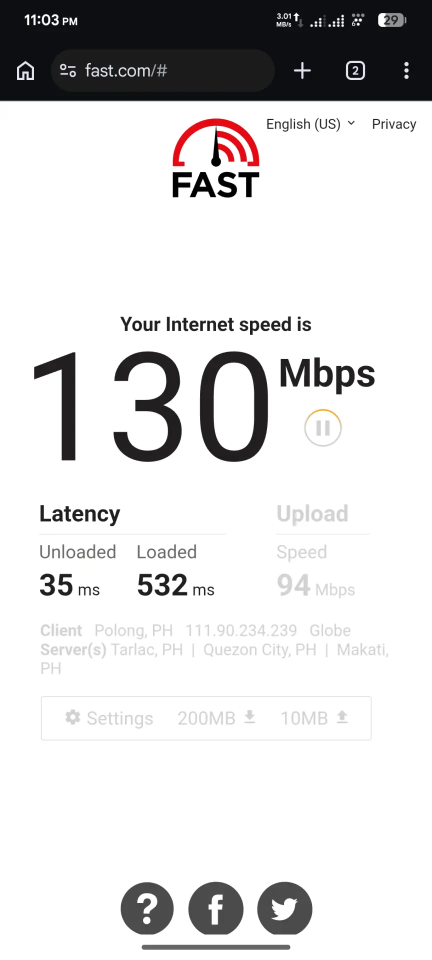

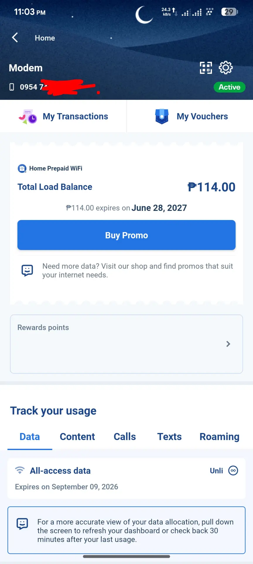

Famsurf unli999 nga pala. Chambahan at need ng patience. Akala ko sa stock sim at gomo lang magagawa, pwede rin pala dito.
Under 4g only lang yan. Nachambahan. Haha. Try ko under 5G NSA

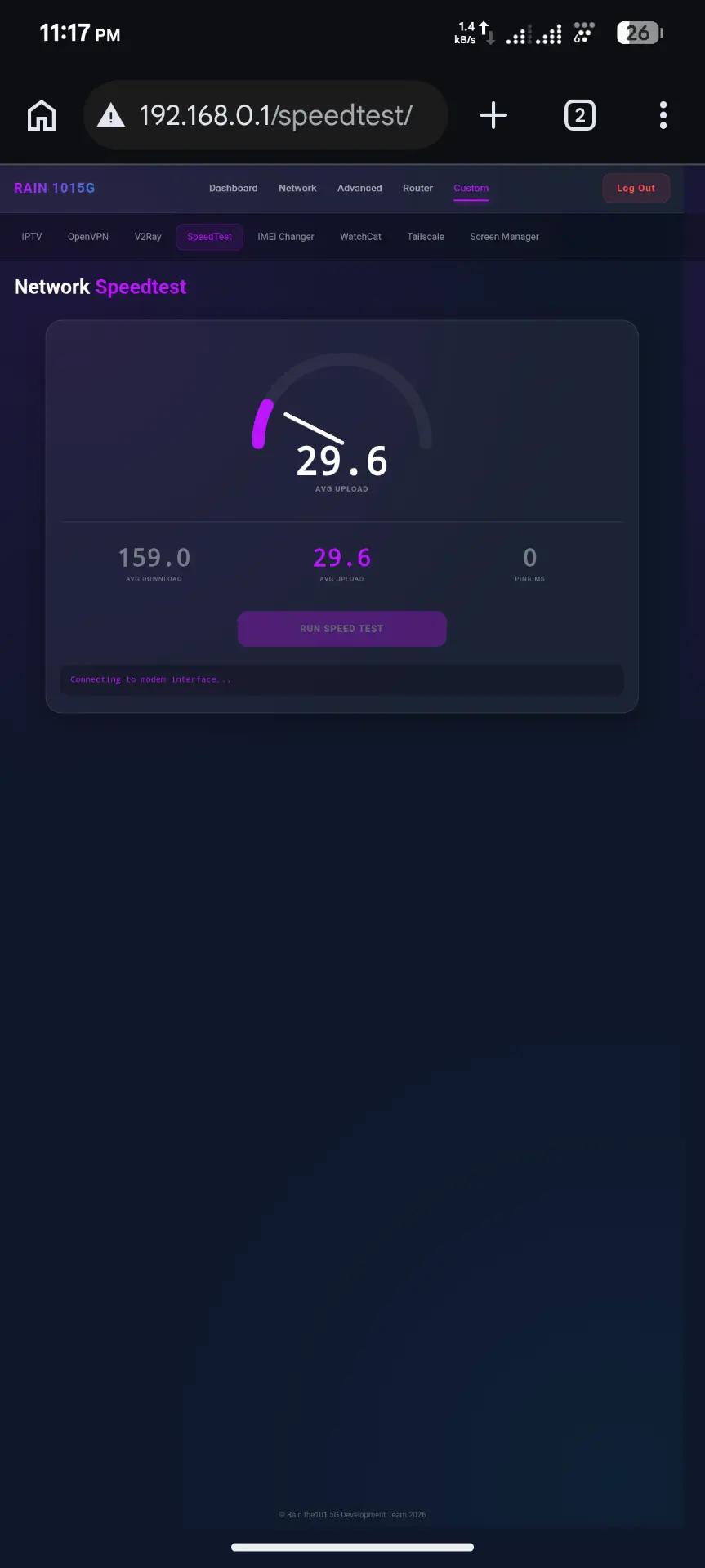

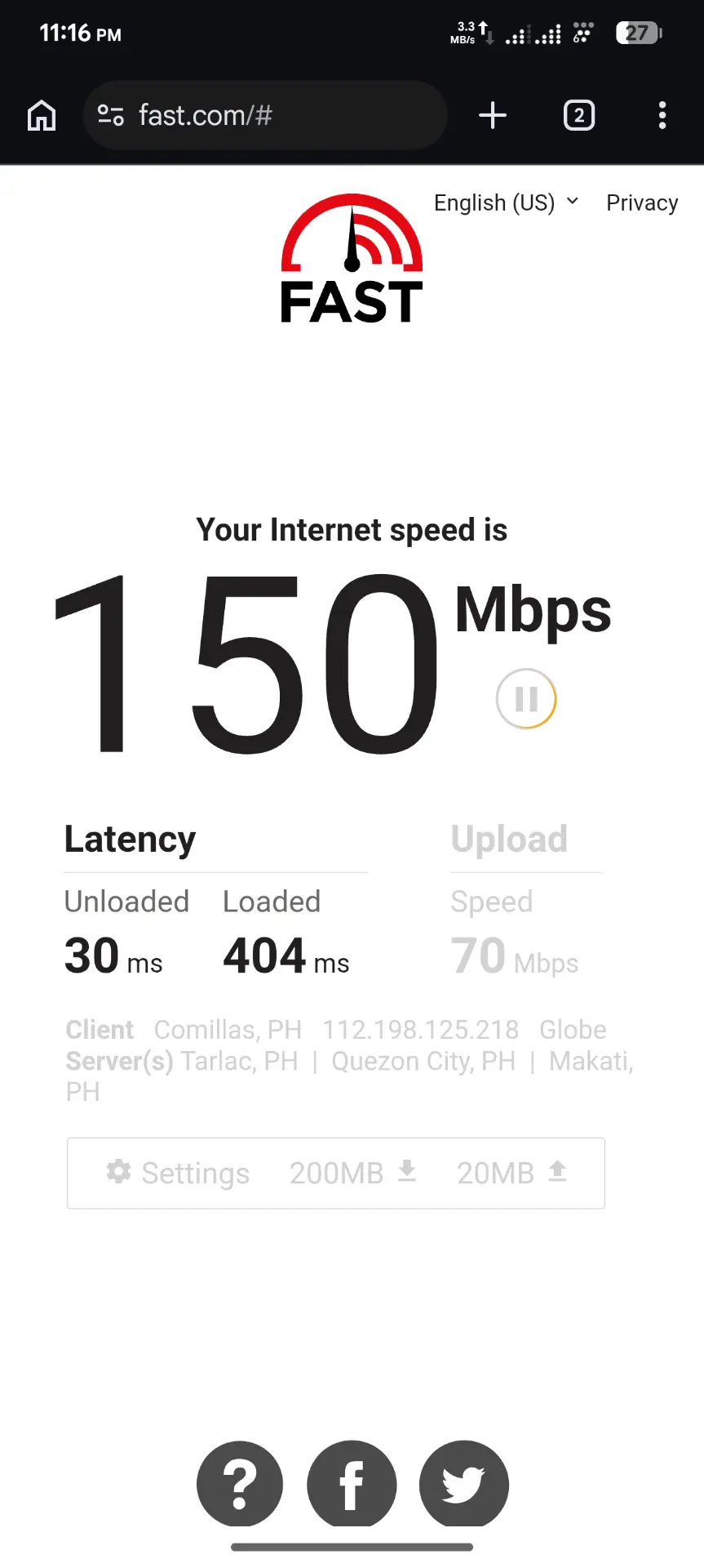

Update. After many minutes of switching under 4g and 5g nsa to trigger CA. Di talaga ma-bypass 40mbps speed ni at home sim under 5G mode. Taliwas sa gomo at stock sim.
Sa 4g mode lang siya na-ba-bypass. Need ng maraming lte bands sa location though para kumagat tas may speedtest na umaandar para kumagat.
