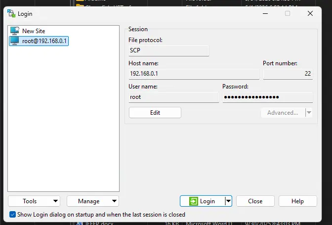

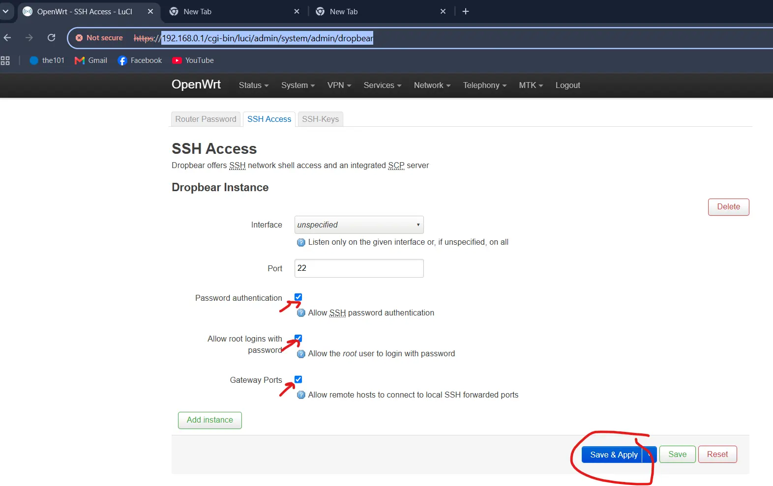

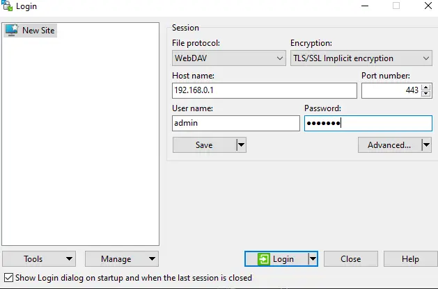

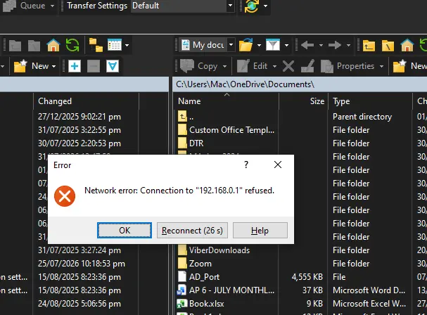

Bossing,
di ko masundan yung instruction,
Done to download Winscp,may nagprompt
ginwa ko is, nilagay ko host name, tpos admin credentials, kaso ayaw gumana, BAD ip daw,
tinary ko din yung root, kaso, ayaw,
tama ba tong ginagnwa ko? sensya na baguhan sa mga ganito, salamat
tapos root sa username then yung password credentials mo

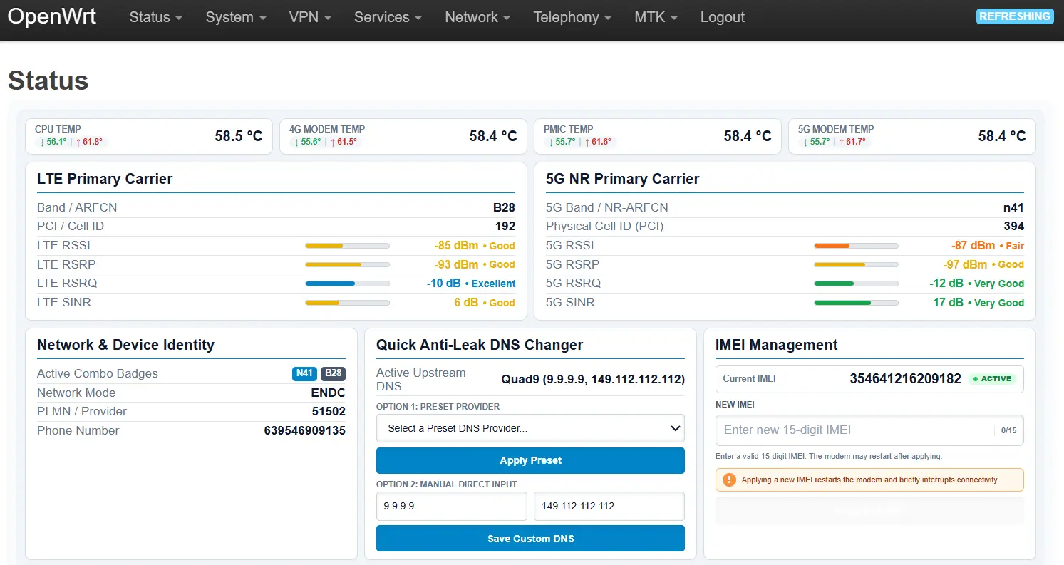

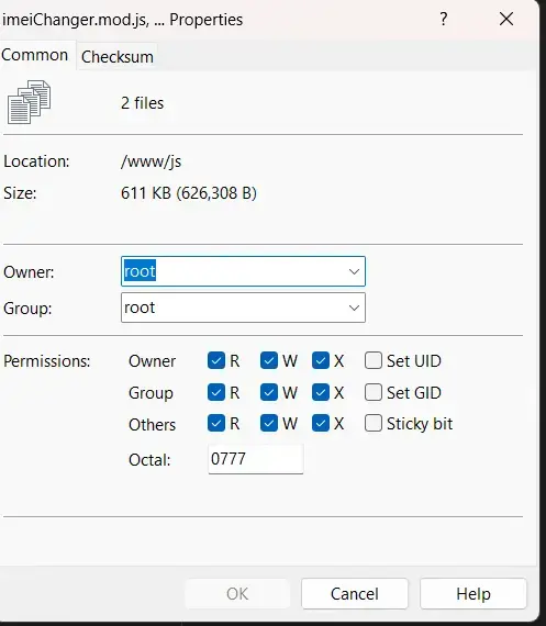

IMEI Changer for v7.2.03g
Instructions
1. Use winscp for file transfer
2. Download files, copy and paste sa directory below:
Directory
/www/js
/www/cgi-bin
3. Change each file permissions to work (right click - properties)
4. Clear Browser Cache
5. CTRL+SHIFT+R Openwrt Browser
6. Reboot (optional)
SS
Download: You do not have permission to view the full content of this post. Log in or register now.

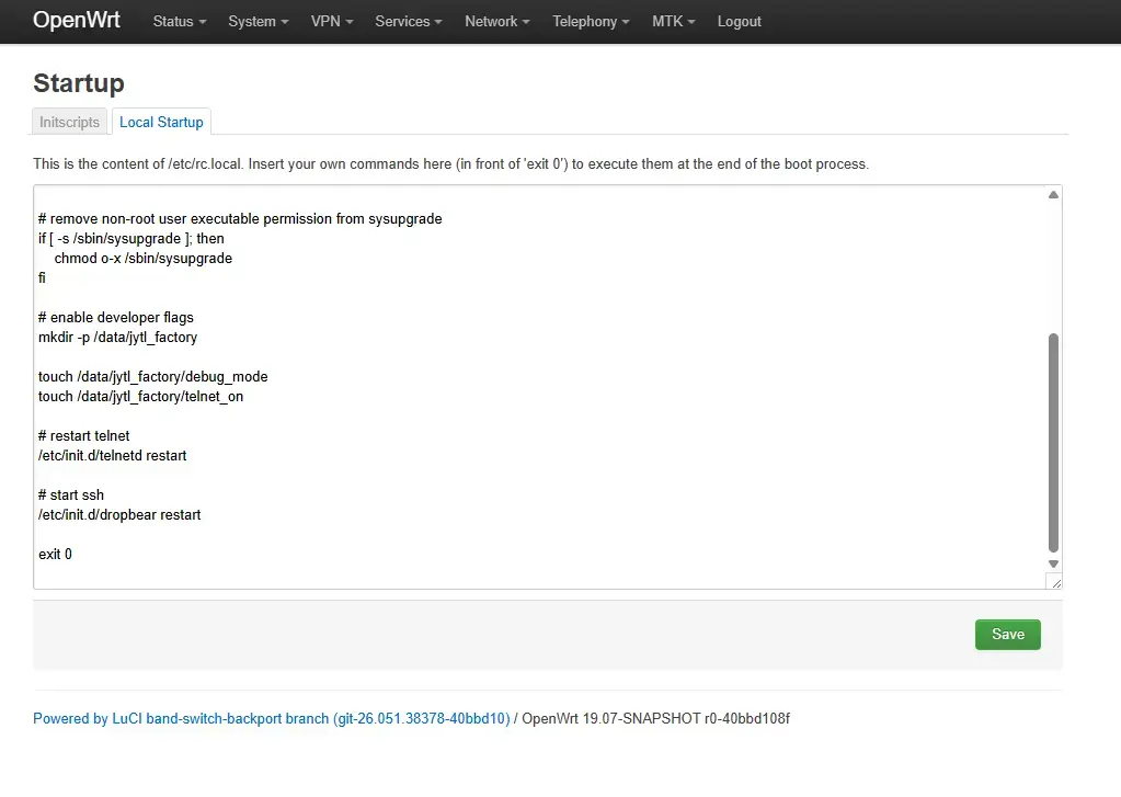

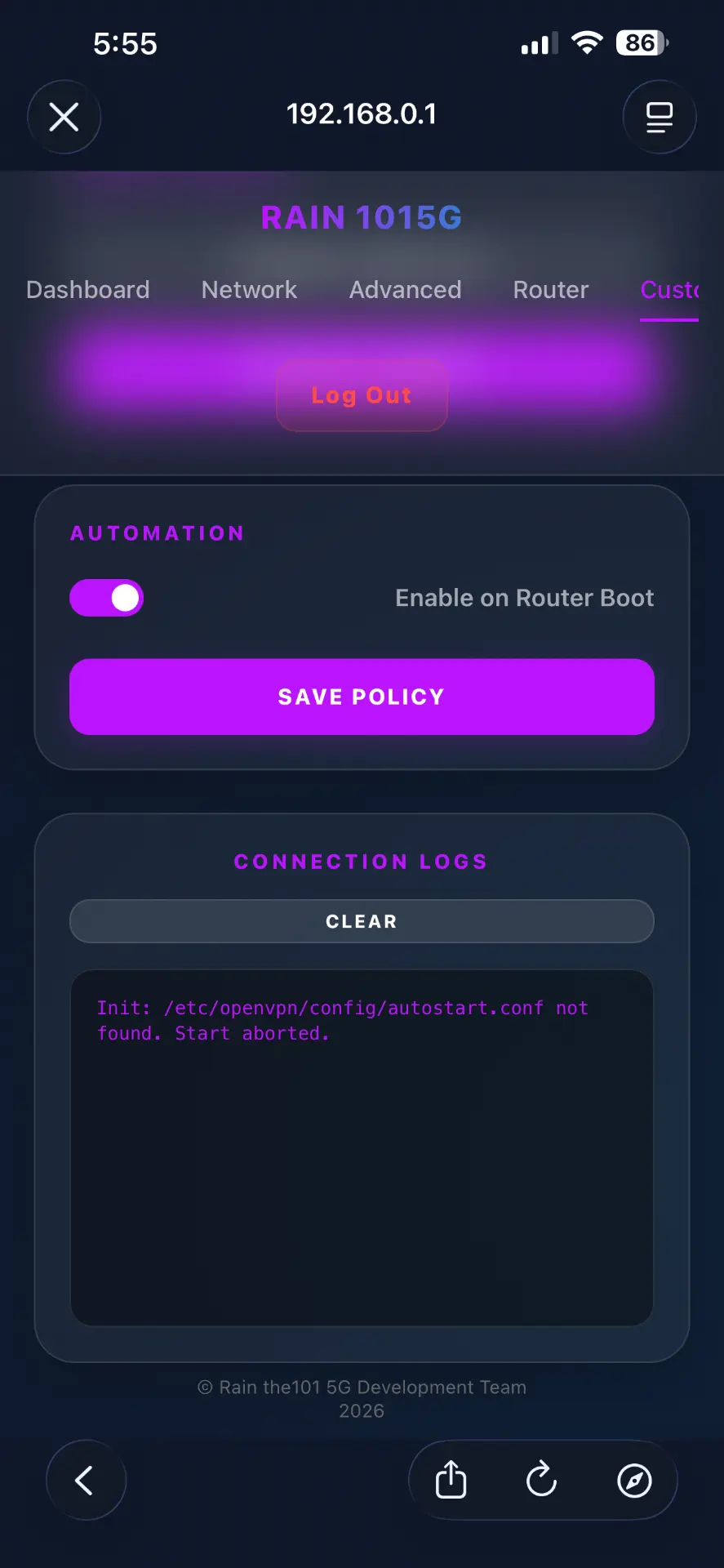

Sir napansin ko sa v7.2.03 Bandlocking pag Reboot po Modem nawawala Bandlocking na Set ko.Pano maayos yun Sir?
punta ka dito sa startup add mo yung line sa baba para no need na mag restart ng dropbear kada boot ng modem
