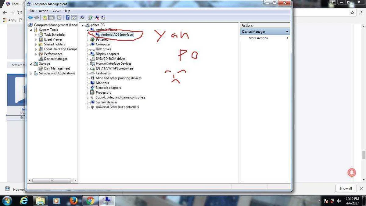

may solution pa ba ang yellow light only?? or nka 2g lg sya.. no signal sa 3g at 4g kahit anong sim 2g lg tlaga... sana my mka sagot :)
hahahayzz,..tignan mo ang connection mode baka naka lock sa 2g preferred..
pasukin mo admin..

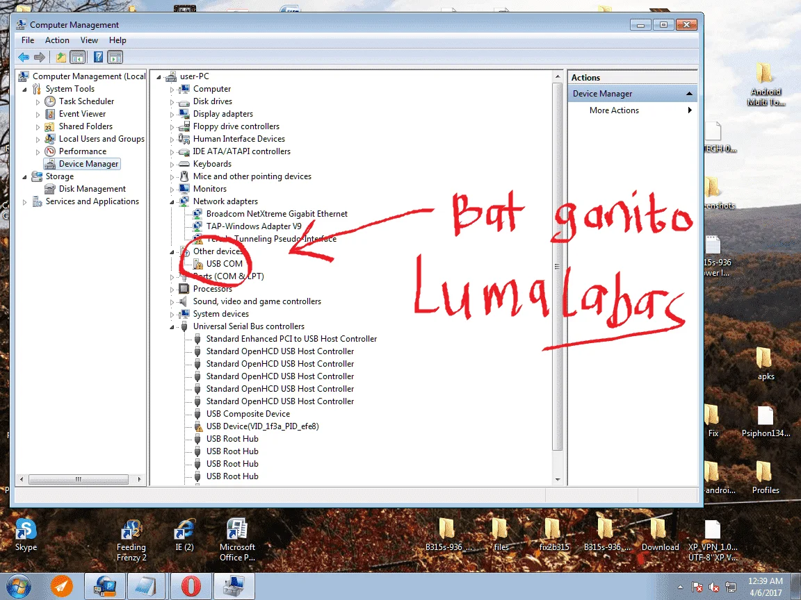

ayyuuun tip ko para sa mga working pagkatpos ng fastboot pero pag reboot white led ulit pagkatapos mo pong ifastboot magboot nayan diba, open ka huawei toolbox tapos open line mo via telnet.
DAGDAG KAALAMAN MGA IDOL DYAN WORKING DIN PALA SA OLD 936 ..MODEM.. TESTED NO WORRIES BASTA SUNDIN LANG LAHAT NG NASA TUTORIAL... HERE
Plug flasher baklasin mo yung modem tingnan mo yung pic pag dikitin mo yung 1&2
Plug Power pag d umilaw bitawan muna OK NA .
pero kung umilaw ibig sabihin d nag dikit yung dalawang bilog ulitIN MO JUMPER MO
Plug USB ----PLUG USB
1. Open Balong USB Downloader
- Click Detect
- Locate usblsafe-b315.bin
- Load
- Pag 100% na IILAW NA YUNG LED LIGHT NYA STEADY LANG GUYS ..WAG MO LANG I CLOSE HAYAAN MO LANG SI BALONG.. THEN..
2. Open Firmware Folder
- Click go_hdlc
- Enter LANG PARA MAG EXIT DAPAT OK LAHAT NG RESPONSE
3. Open Huawei R215 Flash
- Locate 3G PC UI Interface (select)
- Flash
- Locate .hmf file
RECOMMENDED KO LANG MAS MAGANDA YUNG MIDDLE EAST FRIMEWARE..NASA TAAS YUNG MGA FILE GUYS..
-Antayin na may nakasulat na Done/Remove battery and put it again..
-AT DAPAT GUYS OK LAHAT NG RESPONCE SA FRIMEWARE HA
- Close
TAPOS REBOOT
.. TANGALIN MUNA YUNG JUMPER MO..
TAPOS SUNDIN MUNA YUNG TUT. SA TAAS WORKING 101% MABUBUHAY MODEM NYU ..TESTED SA NEW MODEM B315S-936 AT OLD B315S-936 DONT FOR GET TO THANKS ME ...
DAPAT GUYS LAHAT NG REQUIRED FILES DOWNLOAD LAHAT HA,,PARA GUMANA
