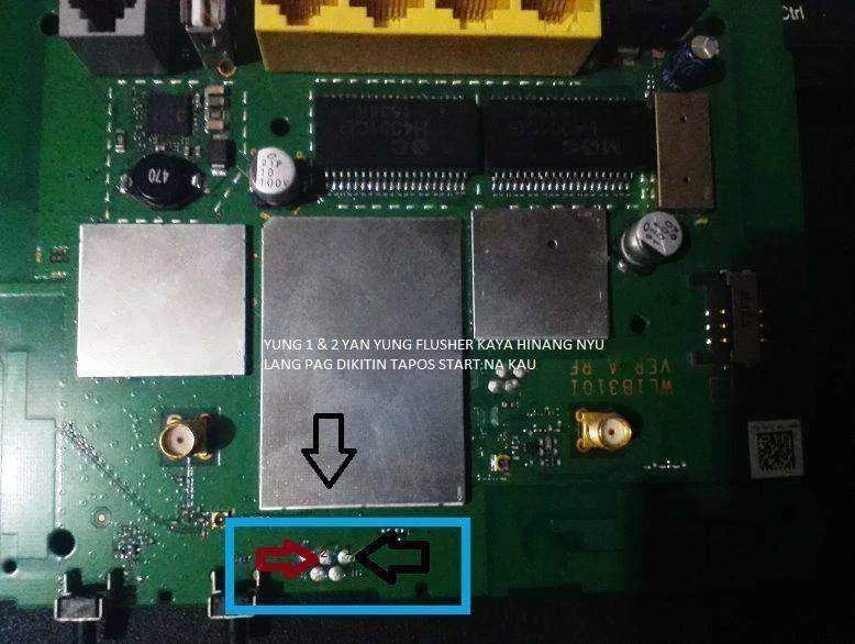

DAGDAG KAALAMAN MGA IDOL DYAN WORKING DIN PALA SA OLD 936 ..MODEM.. TESTED NO WORRIES BASTA SUNDIN LANG LAHAT NG NASA TUTORIAL... HERE
Plug flasher baklasin mo yung modem tingnan mo yung pic pag dikitin mo yung 1&2
Plug Power pag d umilaw bitawan muna OK NA .
pero kung umilaw ibig sabihin d nag dikit yung dalawang bilog ulitIN MO JUMPER MO
Plug USB ----PLUG USB
