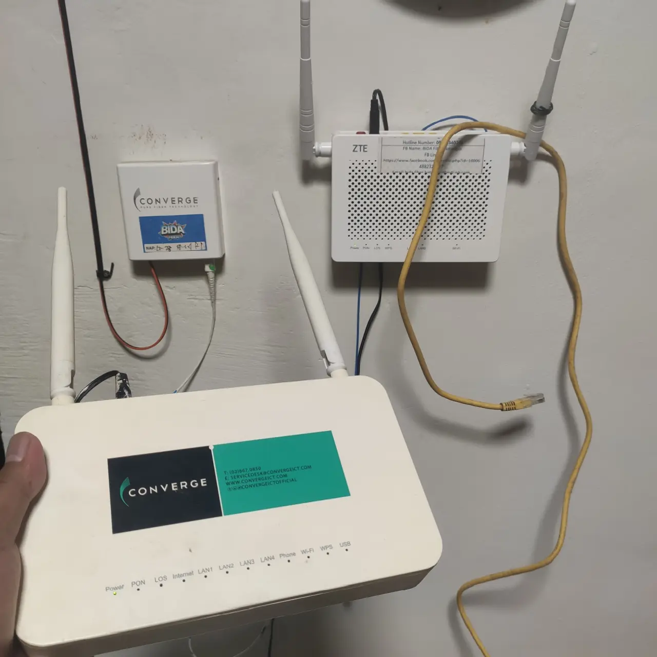

Currently Naka Converge Bida fiber ako with ZTE F679W modem, Sinubukan ko gamitin yung disconnected ZTE F670L ko dito pero wala syang internet, may paraan kaya para mapagana ko sya?
Kailangan ko kasi since kailangan naka LAN connection kami sa work, eh ung current zte f679w modem ng bida fiber hindi ma-open yung LAN kahit sa admin access...
Nag-try nako bumili ng Xiaomi 5g Wifi Repeater kaso bumagal sya at hindi stable ang connection...

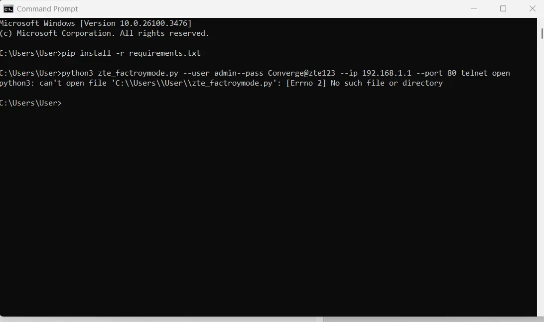

Hello boss tinatry ko na to pero di ko po magets ung no.2 san ko po kukunin ung iinstall?
can you explain po sana for like me na di gaano sanay pa

install po muna kayo ng python po... python3: You do not have permission to view the full content of this post. Log in or register now.
requirement cya para ma run ang script, pde nyo i remove afterwards kun di nyo na need

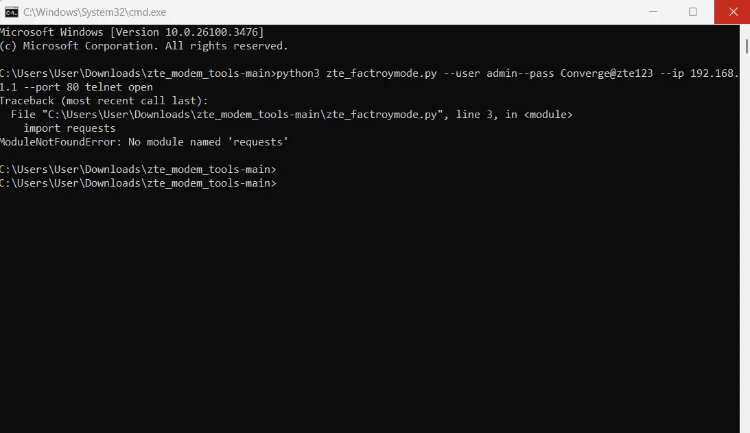

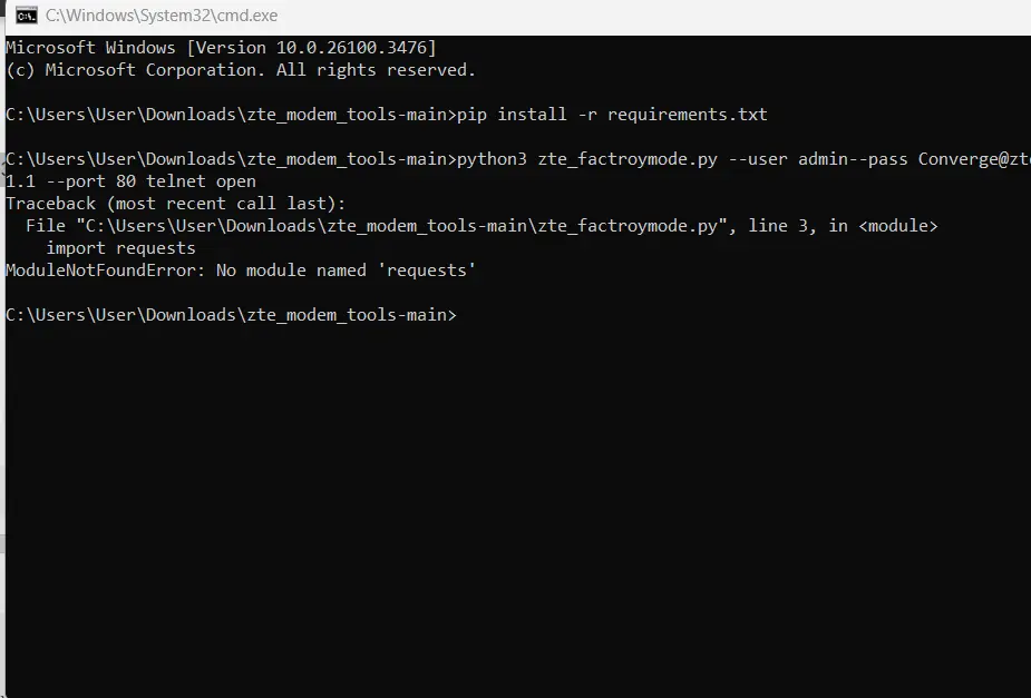

Kaka-Download and Install ko lang nyan master...ito na new error koline 3 error.webp

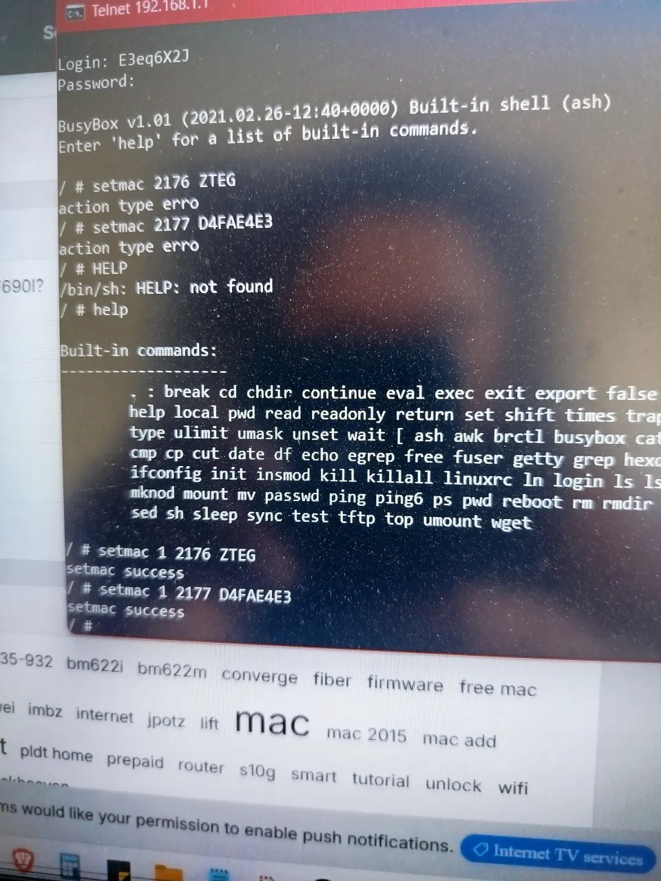

python3 zte_factroymode.py --user admin--pass Converge@zte123 --ip 192.168.1.1 --port 80 telnet open
then telnet to your modem, use the login generated
telnet 192.168.1.1
tapos un na
setmac 2176 vendorid
setmac 2177 serial
reboot
sa serial number ganito format S/N: ZTEG12ABCD576
Vendor Id = ZTEG
Serial = remaining characters
kopyahin mo lang ang vendor id at serial ng S2S mo
then next step kopyahin mo VLAN settings
ano output ng "pip install requests pycryptodome pyinstaller"?
try mo rin
pip3 install requests pycryptodome pyinstaller
if not
python3 -m pip install requests pycryptodome pyinstaller

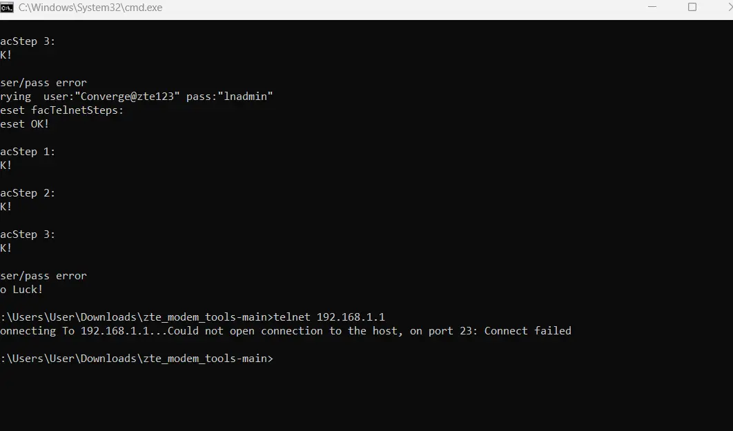

ok ung pinaka-huli na code, sa telnet nlang ako di makapasok "Could not open connection to the host, on port 23: Connect failed" na-open ko na nman ung Telnet Client sa Control Panel pero ganyan padin
^iscreenshot mo daw step by step
like ano na output ng
kailangan naka kabit ang Converge modem mo pag nag run ka nyan

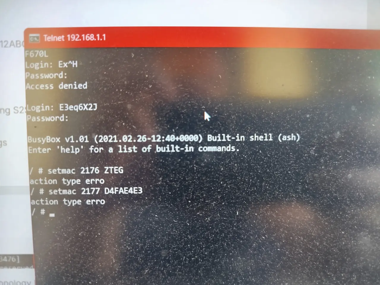

ang galing ahaha Wait po nakapasok nako sa TELNET

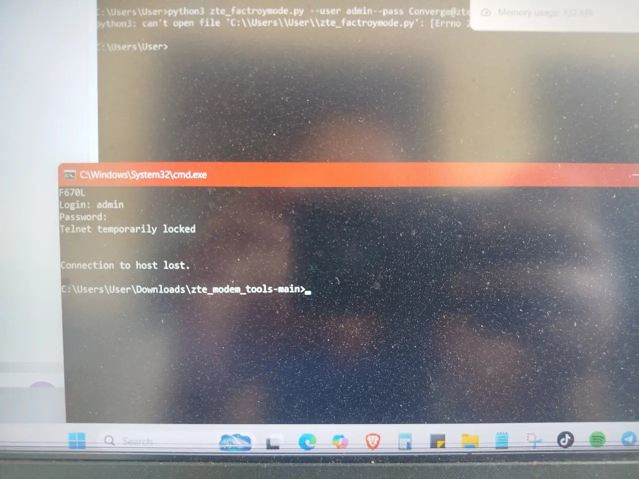

GG na temp. lock ako...ayaw kasi pumasok nung
admin
Converge@zte123

ung username and password sa telnet is ung output ng
python3 zte_factroymode.py --user admin --pass Converge@zte123 --ip 192.168.1.1 --port 80 telnet open
irun mo lang iyan ulit tapos ma uunlock na
parang user=xxxx&pass=xxx
or irestart mo lng ung converge modem
typo error dw po
reboot
pra ma apply

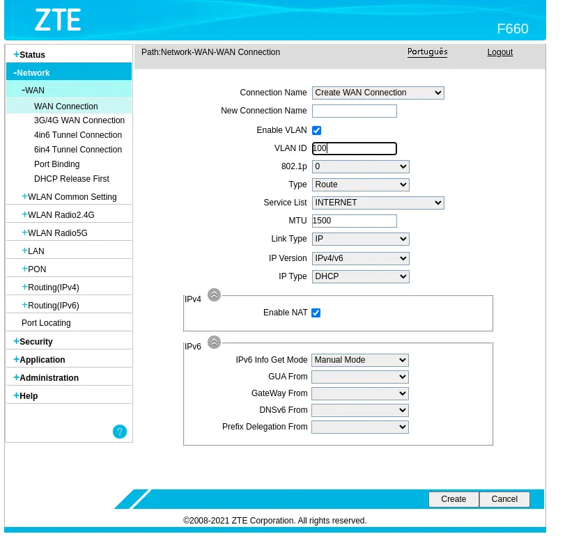

tapos kopyahin mo VLAN settings
i login mo sa web
username: admin
password: Converge@zte123
sample, critical info is ung VLAN ID ng S2S kopyahin mo sa Converge ZTE
di ako familiar sa S2S na ZTE na admin, pero try mo rin, ganyan din ata ang password nya..
basta ung Internet VLAN ID kopyahin mo
iba din VLAN ID ng TR069, ginagamit ni Converge ang TR069 for monitoring purposes, pero di cya requirement pra mag ka internet ka
ung Internet VLAN ID lang importante
