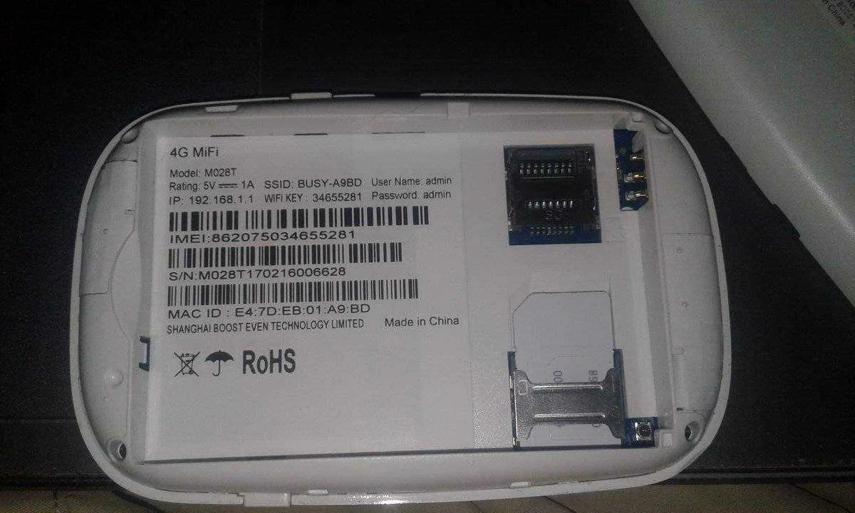

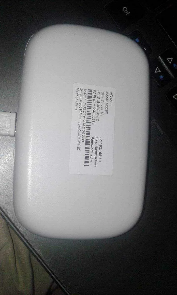

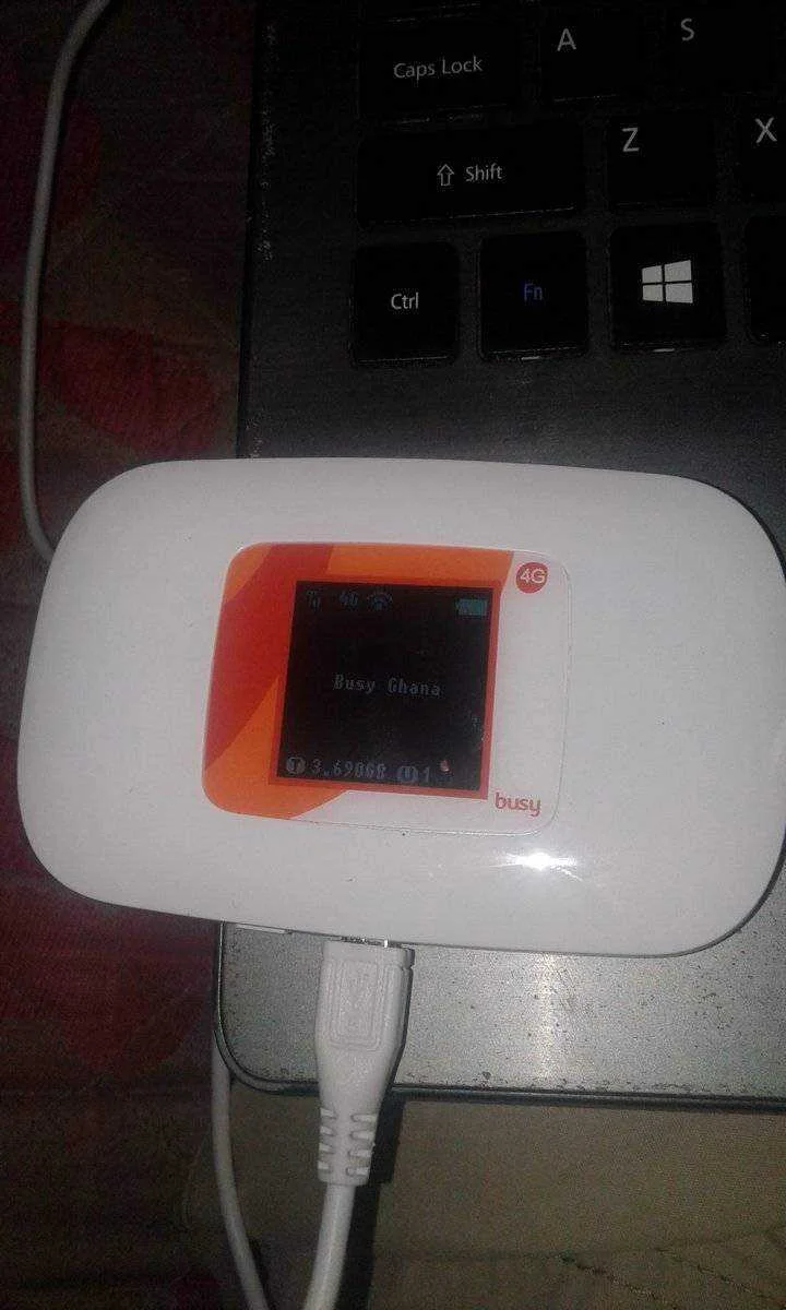

I have been trying to follow this tutorial to unlock my modem... but to no avail... all i get is an error that says FBF_VersionNotMatch...
My device is Busy 4G MiFi
Model: M028T
IMEI No: 862075034655281
if possible can anyone get me the unlock codes for this device... Here are images of the device
