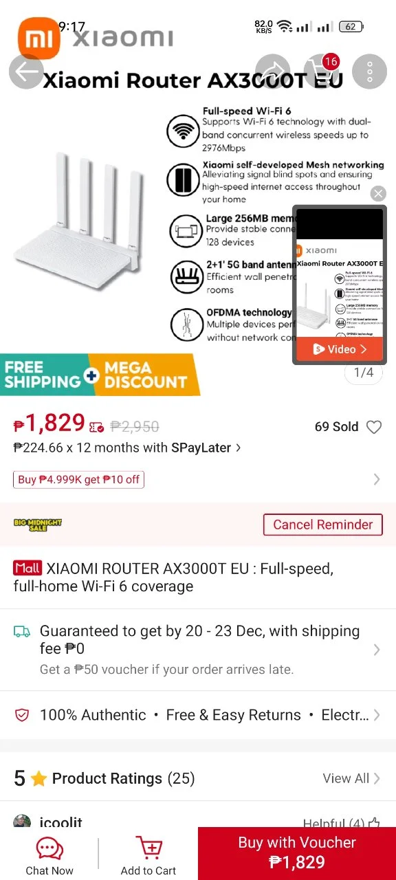

❓ Help Ito na ata pinaka murang Wifi 6 with Openwrt support
okay din naman Rujie sino naka try? at para san ba gagamitin ang OpenWrt? kasi nag p2p business ako. halos lahat more on Cloud Control lang .
anong ruijie? ung RG-EW1200? mahina ung CPU nya that's MT7621 and WiFi 5, for that price, just get this Xiaomi router instead kasi WiFi 6 + MT7981B + WED Support (Wireless offload)
Kaya lang ni RG-EW1200 is below 300mbps na speed over WiFi. Pero maganda cya if habol mo ung range at coverage kasi mas marami ung antenna, compared dito kay Xiaomi.
Sa akin personally need ko OpenWrt pra VLANs sa WiFi

sabagay po yes po coverage need ko kasi may mag rerecieved din na device from house pababa to router basic lang. pero since kapitbahay lang na susupplyan ko. sakto na yun kasi halos CP lang gamit nila po. control din po speed.

Nakapag order nako sir waiting nalang sa UNIT ko HAHAHA try ko ka agad yung link na binigay sa forum so far malinaw naman lahat nang steps may easy mode pa.
Check mo lang kung anong NAND Flash Chip yung makukuha mo at kung meron AN8855 hardware.
Baka kasi CN version ibigay sayo, hindi yung International version.
