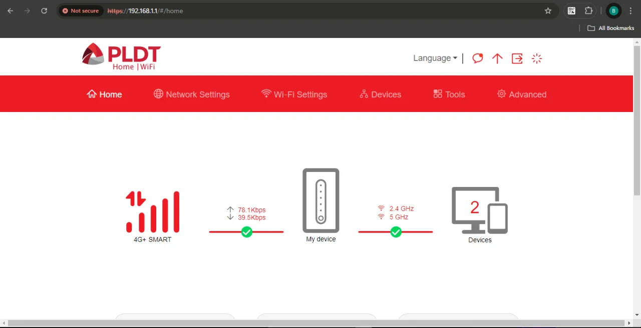

🟢 Smart PLDT HOME WIFI 5G+ H153-381 5G Problem
