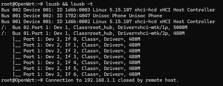

eth0 is the CPU port on the SoC where the switch is connected.
usb0/1/2/3 is the modem interface.

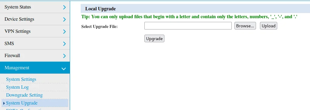

by the way, can i actually flash the firmware using the default webui of the zlt s12 pro router?
thank you XD
NO... you have to unlocked and have superadmin access on your router first.
Then you can follow the video tutorial/guide on how to flash this firmware on it.
You can find all their video guides on YT, just search for "ZLT S12 PRO" by "R1BNC"
thanks kaloyb. i do have superadmin access on it already.
i wonder if i still need to use the serial connectors thingy or i could just directly flash the sysupgrade file from the webui
You have to, since your router is still with the stock Globe firmware, its important to do a backup also since this firmware is still under development, so if something don't work you can always go back...
All guides are there on R1BNC's YT channel.

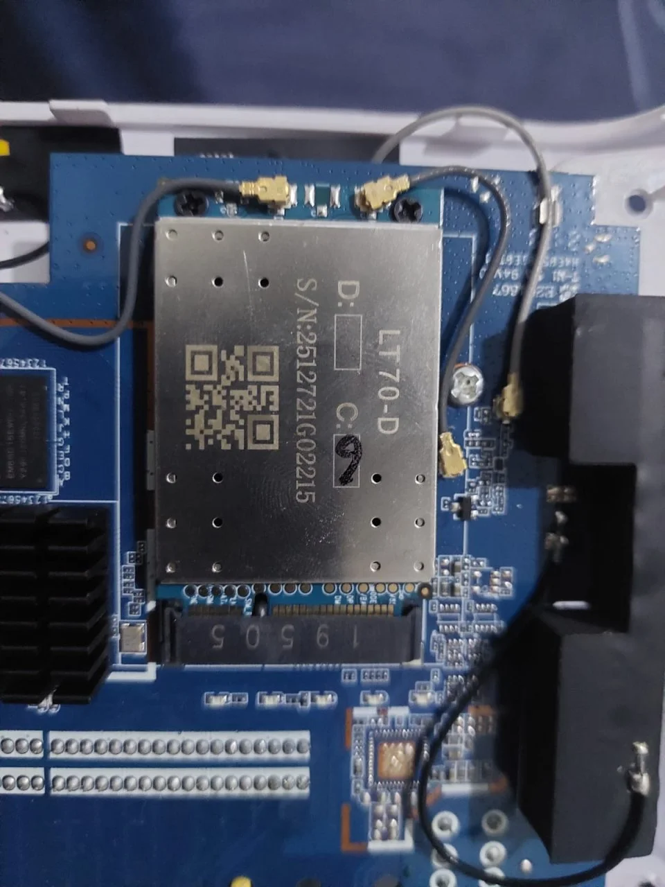

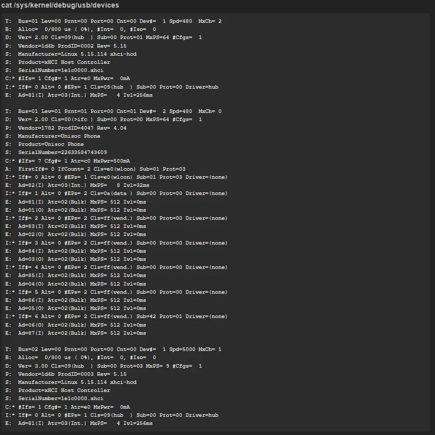

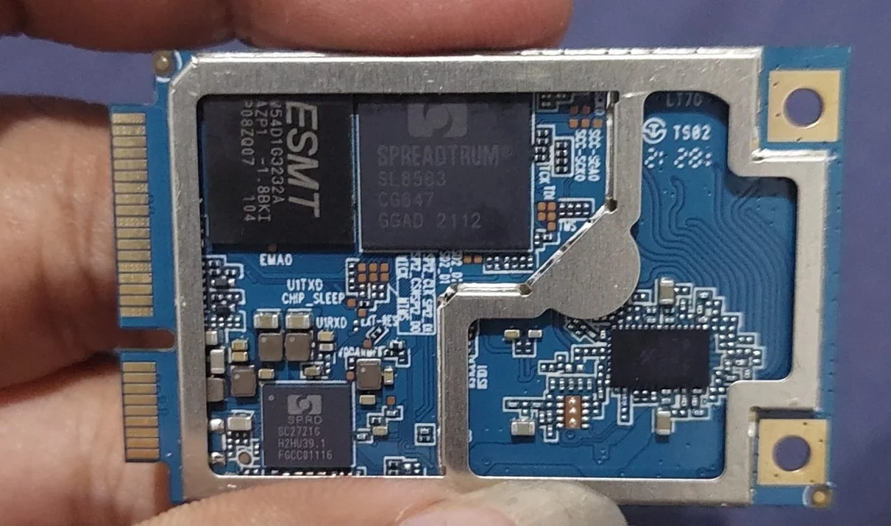

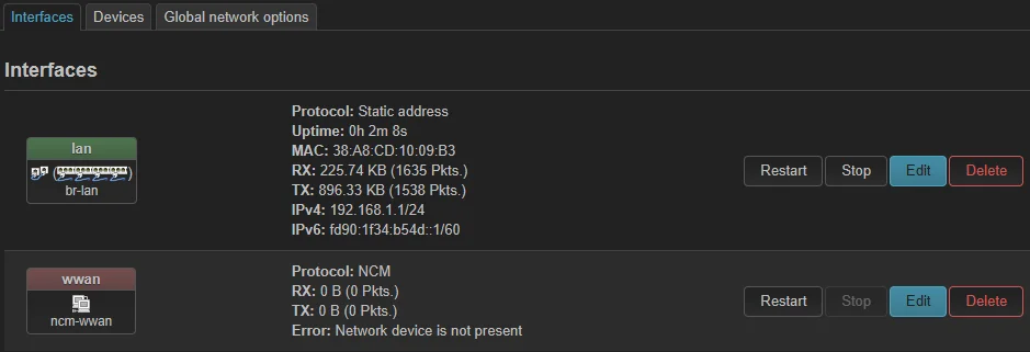

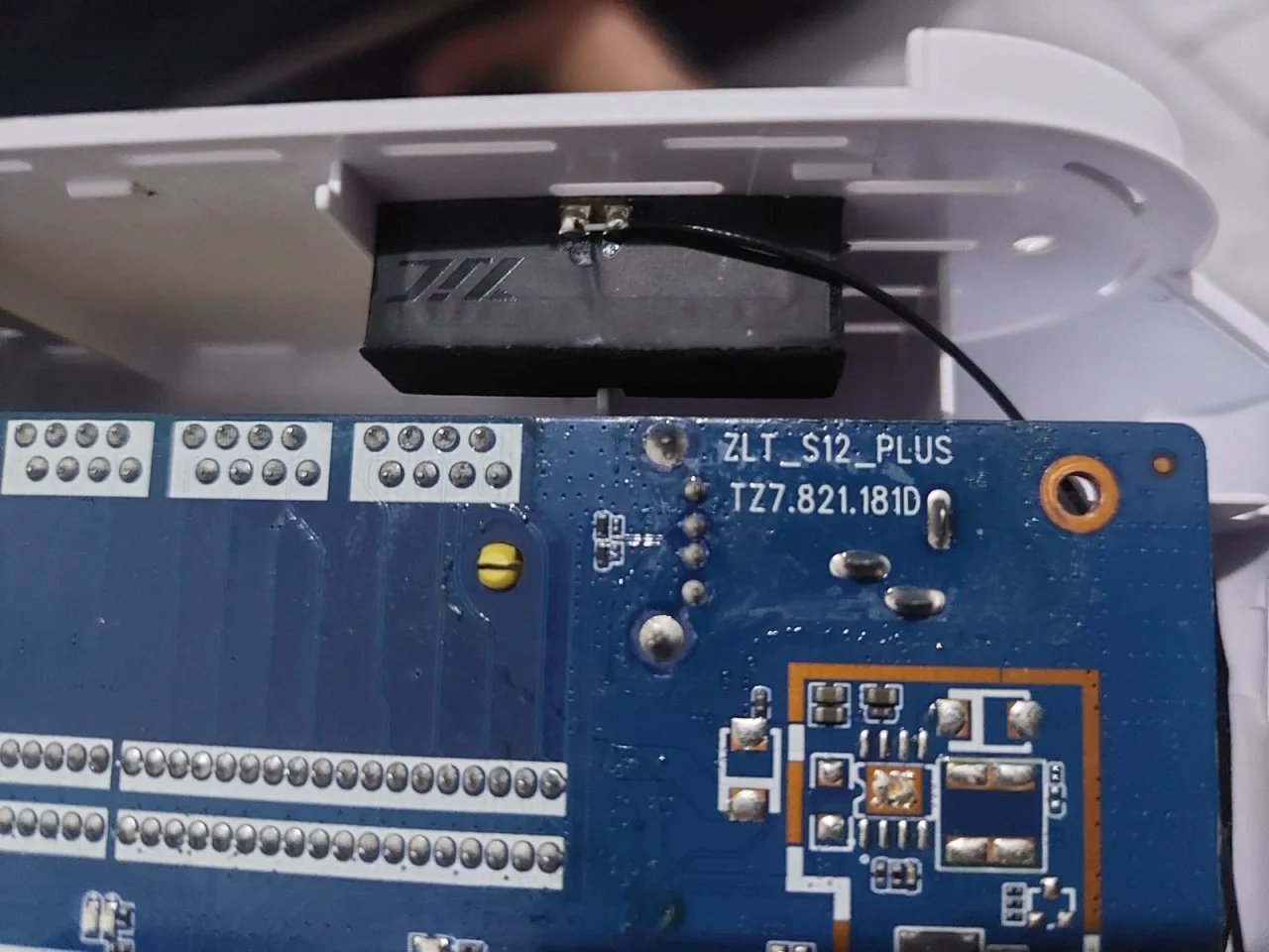

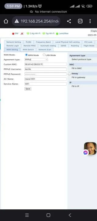

hei, im not from here but i have same router as ZLT S12 Pro i guess it rebranded to local brand, i think its still the same but maybe just have slightly different modem, would you help me to make the 4G/LTE modem works?
Screenshot 2024-10-16 220507.webpScreenshot 2024-10-16 221237.webpScreenshot 2024-10-16 221400.webpWhatsApp Image 2024-10-16 at 22.23.09_88fc51e8.webpWhatsApp Image 2024-10-16 at 22.23.09_4bddffc0.webpWhatsApp Image 2024-10-16 at 22.23.08_44af2449.webp
