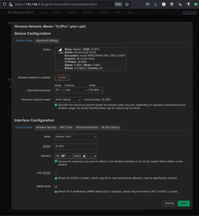

Trying out this firmware now:
Sorry, but newbie lang po ako sa OpenWRT...

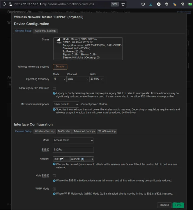

Don't know if na-enable/configure ko properly yung WiFi, pero continuous blinking yun status LED nya:

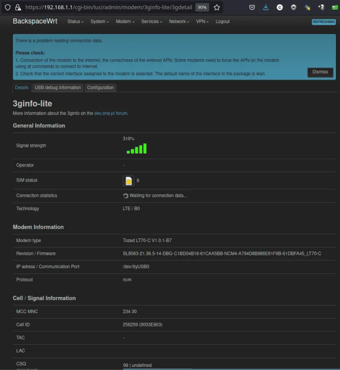

Then this is what I've encountered sa LTE modem:
LTE/Signal status LEDs also not working...

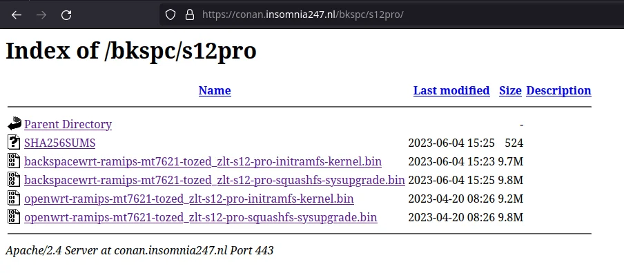

Please help... I don't have the usb to ttl module converter, but my router was already on OpenWRT...
How can I update/replace the firmware with this one? Thanks!
you can use the standard firmware upgrade in OpenWrt to upgrade. Just use the sysupgrade file provided :)
As for wifi, standard openwrt guides should work. The 3ginfo issue might be better to report at our Di-sco-rd server since that's where most members are active.
Yes, that's what I did, I uploaded the "backspacewrt-ramips-mt7621-tozed_zlt-s12-pro-squashfs-sysupgrade.bin" file here:
Tapos ganun nga po kinalabasan, kapag ini-"Enable" ang wifi, continious blinking indicator LED nya...

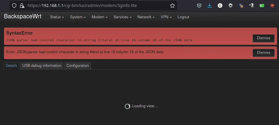

Kapag in-open yun 3ginfo... may errors po, as per previous post ko po.

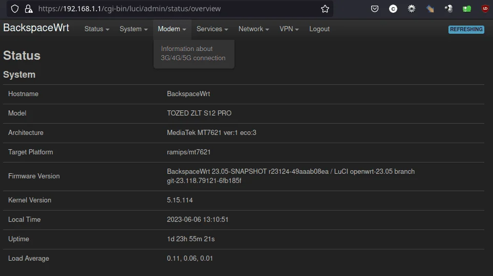

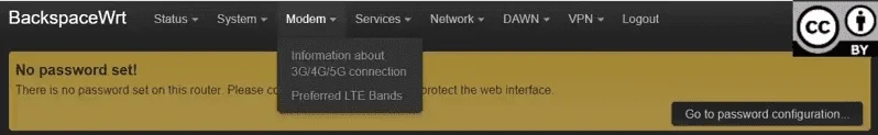

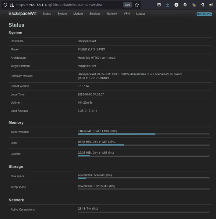

I notice also that the items on the menu after I upgraded is different from the one on the video tutorial:
Its missing the "Preferred LTE Bands" and "DAWN":

Trying this now... flashed several times and configured as per user guides on OpenWRT website:
  • WiFi router is working
  • couldn't get 4G/LTE modem to work (see error messeges from my previous posts)
I think the web configuration is not integrated/working properly with the 4G/LTE modem module, probably can be configured via command line, but unfortunately I'm just starting to learn OpenWRT so I don't want to mess around the command line.

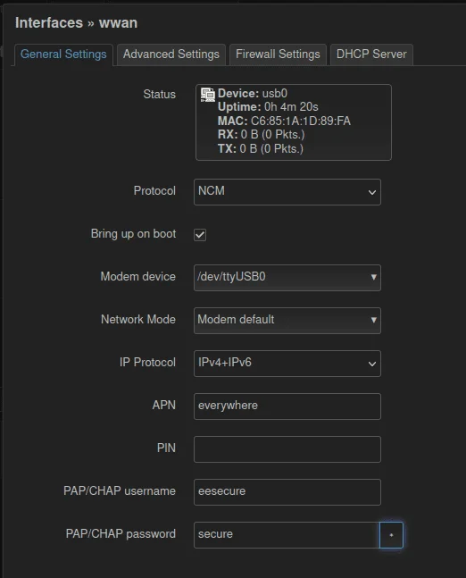

have you checked interfaces and debug info in 3ginfo if the modem shows up? You can configure the NCM interface to your liking. serial port is /dev/ttyUSB0
As for missing the missing menu, I removed modemband temporarily to resolve some issues. For DAWN, I switched it to use usteer since that's more reliable for kicking from 2.4ghz to 5Ghz in my experience. It doesn't have a luci menu. I update the builds I have on the link from time to time to fix or replace some things.
We're also gonna switch our downstream fork from 23.05 back to mainline since we're interested in some patches and backporting is a waste of time.
For the 3ginfo issue, would be cool if you can use dev tools in the browser and fetch the json returned to see what's the issue with the returned data. Some details are being shown so im guessing it just partly doesn't work. What firmware was your S12 Pro on before converting to openwrt?

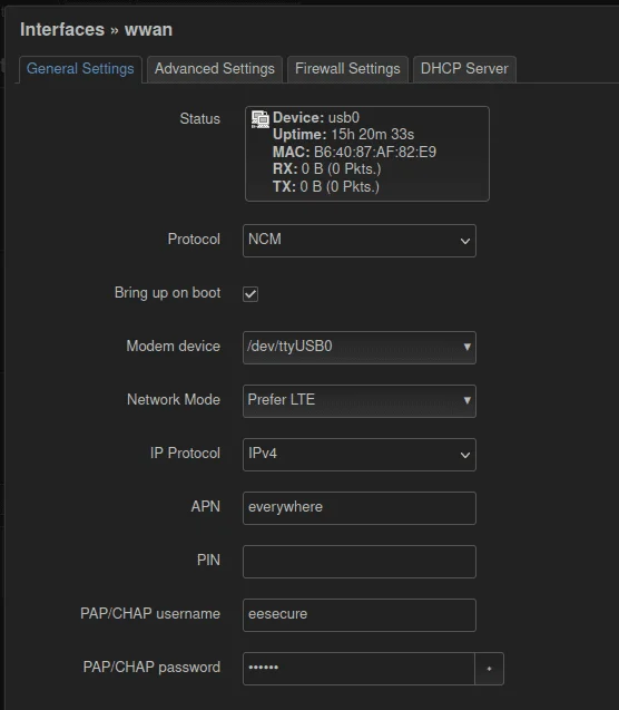

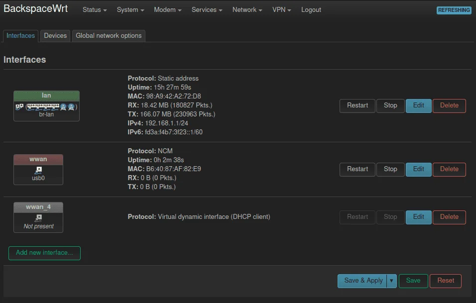

Interface configuration:
* what I couldn't find here is the option to set/enable "roaming"...
cat /sys/kernel/debug/usb/devices:​
T: Bus=01 Lev=00 Prnt=00 Port=00 Cnt=00 Dev#= 1 Spd=480 MxCh= 2 B: Alloc= 0/800 us ( 0%), #Int= 0, #Iso= 0 D: Ver= 2.00 Cls=09(hub ) Sub=00 Prot=01 MxPS=64 #Cfgs= 1 P: Vendor=1d6b ProdID=0002 Rev= 5.15 S: Manufacturer=Linux 5.15.114 xhci-hcd S: Product=xHCI Host Controller S: SerialNumber=1e1c0000.xhci C:* #Ifs= 1 Cfg#= 1 Atr=e0 MxPwr= 0mA I:* If#= 0 Alt= 0 #EPs= 1 Cls=09(hub ) Sub=00 Prot=00 Driver=hub E: Ad=81(I) Atr=03(Int.) MxPS= 4 Ivl=256ms T: Bus=01 Lev=01 Prnt=01 Port=00 Cnt=01 Dev#= 2 Spd=480 MxCh= 0 D: Ver= 2.00 Cls=00(>ifc ) Sub=00 Prot=00 MxPS=64 #Cfgs= 1 P: Vendor=1782 ProdID=4055 Rev= 4.04 S: Manufacturer=Unisoc Phone S: Product=Unisoc Phone S: SerialNumber=2032622D012013 C:* #Ifs=14 Cfg#= 1 Atr=c0 MxPwr=500mA A: FirstIf#= 0 IfCount= 2 Cls=02(comm.) Sub=0d Prot=00 A: FirstIf#= 2 IfCount= 2 Cls=02(comm.) Sub=0d Prot=00 A: FirstIf#= 4 IfCount= 2 Cls=02(comm.) Sub=0d Prot=00 A: FirstIf#= 6 IfCount= 2 Cls=02(comm.) Sub=0d Prot=00 I:* If#= 0 Alt= 0 #EPs= 1 Cls=02(comm.) Sub=0d Prot=00 Driver=cdc_ncm E: Ad=82(I) Atr=03(Int.) MxPS= 16 Ivl=32ms I: If#= 1 Alt= 0 #EPs= 0 Cls=0a(data ) Sub=00 Prot=01 Driver=cdc_ncm I:* If#= 1 Alt= 1 #EPs= 2 Cls=0a(data ) Sub=00 Prot=01 Driver=cdc_ncm E: Ad=81(I) Atr=02(Bulk) MxPS= 512 Ivl=0ms E: Ad=01(O) Atr=02(Bulk) MxPS= 512 Ivl=0ms I:* If#= 2 Alt= 0 #EPs= 1 Cls=02(comm.) Sub=0d Prot=00 Driver=cdc_ncm E: Ad=84(I) Atr=03(Int.) MxPS= 16 Ivl=32ms I: If#= 3 Alt= 0 #EPs= 0 Cls=0a(data ) Sub=00 Prot=01 Driver=cdc_ncm I:* If#= 3 Alt= 1 #EPs= 2 Cls=0a(data ) Sub=00 Prot=01 Driver=cdc_ncm E: Ad=83(I) Atr=02(Bulk) MxPS= 512 Ivl=0ms E: Ad=02(O) Atr=02(Bulk) MxPS= 512 Ivl=0ms I:* If#= 4 Alt= 0 #EPs= 1 Cls=02(comm.) Sub=0d Prot=00 Driver=cdc_ncm E: Ad=86(I) Atr=03(Int.) MxPS= 16 Ivl=32ms I: If#= 5 Alt= 0 #EPs= 0 Cls=0a(data ) Sub=00 Prot=01 Driver=cdc_ncm I:* If#= 5 Alt= 1 #EPs= 2 Cls=0a(data ) Sub=00 Prot=01 Driver=cdc_ncm E: Ad=85(I) Atr=02(Bulk) MxPS= 512 Ivl=0ms E: Ad=03(O) Atr=02(Bulk) MxPS= 512 Ivl=0ms I:* If#= 6 Alt= 0 #EPs= 1 Cls=02(comm.) Sub=0d Prot=00 Driver=cdc_ncm E: Ad=88(I) Atr=03(Int.) MxPS= 16 Ivl=32ms I: If#= 7 Alt= 0 #EPs= 0 Cls=0a(data ) Sub=00 Prot=01 Driver=cdc_ncm I:* If#= 7 Alt= 1 #EPs= 2 Cls=0a(data ) Sub=00 Prot=01 Driver=cdc_ncm E: Ad=87(I) Atr=02(Bulk) MxPS= 512 Ivl=0ms E: Ad=04(O) Atr=02(Bulk) MxPS= 512 Ivl=0ms I:* If#= 8 Alt= 0 #EPs= 2 Cls=ff(vend.) Sub=00 Prot=00 Driver=option E: Ad=89(I) Atr=02(Bulk) MxPS= 512 Ivl=0ms E: Ad=05(O) Atr=02(Bulk) MxPS= 512 Ivl=0ms I:* If#= 9 Alt= 0 #EPs= 2 Cls=ff(vend.) Sub=00 Prot=00 Driver=option E: Ad=8a(I) Atr=02(Bulk) MxPS= 512 Ivl=0ms E: Ad=06(O) Atr=02(Bulk) MxPS= 512 Ivl=0ms I:* If#=10 Alt= 0 #EPs= 2 Cls=ff(vend.) Sub=00 Prot=00 Driver=option E: Ad=8b(I) Atr=02(Bulk) MxPS= 512 Ivl=0ms E: Ad=07(O) Atr=02(Bulk) MxPS= 512 Ivl=0ms I:* If#=11 Alt= 0 #EPs= 2 Cls=ff(vend.) Sub=00 Prot=00 Driver=option E: Ad=8c(I) Atr=02(Bulk) MxPS= 512 Ivl=0ms E: Ad=08(O) Atr=02(Bulk) MxPS= 512 Ivl=0ms I:* If#=12 Alt= 0 #EPs= 2 Cls=ff(vend.) Sub=42 Prot=01 Driver=(none) E: Ad=09(O) Atr=02(Bulk) MxPS= 512 Ivl=0ms E: Ad=8d(I) Atr=02(Bulk) MxPS= 512 Ivl=0ms I:* If#=13 Alt= 0 #EPs= 2 Cls=ff(vend.) Sub=00 Prot=00 Driver=option E: Ad=8e(I) Atr=02(Bulk) MxPS= 512 Ivl=0ms E: Ad=0a(O) Atr=02(Bulk) MxPS= 512 Ivl=0ms T: Bus=02 Lev=00 Prnt=00 Port=00 Cnt=00 Dev#= 1 Spd=5000 MxCh= 1 B: Alloc= 0/800 us ( 0%), #Int= 0, #Iso= 0 D: Ver= 3.00 Cls=09(hub ) Sub=00 Prot=03 MxPS= 9 #Cfgs= 1 P: Vendor=1d6b ProdID=0003 Rev= 5.15 S: Manufacturer=Linux 5.15.114 xhci-hcd S: Product=xHCI Host Controller S: SerialNumber=1e1c0000.xhci C:* #Ifs= 1 Cfg#= 1 Atr=e0 MxPwr= 0mA I:* If#= 0 Alt= 0 #EPs= 1 Cls=09(hub ) Sub=00 Prot=00 Driver=hub E: Ad=81(I) Atr=03(Int.) MxPS= 4 Ivl=256ms
dmesg | grep -A 1 -B 12 ttyUSB:
root@BackspaceWrt:~# dmesg | grep -A 1 -B 12 ttyUSB [ 22.246828] mt76x2e 0000:01:00.0: Build Time: 201607111443____ [ 22.275566] mt76x2e 0000:01:00.0: Firmware running! [ 22.282818] ieee80211 phy1: Selected rate control algorithm 'minstrel_ht' [ 22.332366] PPP generic driver version 2.4.2 [ 22.339279] NET: Registered PF_PPPOX protocol family [ 22.347537] usbcore: registered new interface driver qmi_wwan [ 22.362214] wireguard: WireGuard 1.0.0 loaded. See www.wireguard.com for info rmation. [ 22.370114] wireguard: Copyright (C) 2015-2019 Jason A. Donenfeld <Jason@zx2c 4.com>. All Rights Reserved. [ 22.391658] usbcore: registered new interface driver cdc_mbim [ 22.403312] usbcore: registered new interface driver option [ 22.409240] usbserial: USB Serial support registered for GSM modem (1-port) [ 22.417248] option 1-1:1.8: GSM modem (1-port) converter detected [ 22.423920] usb 1-1: GSM modem (1-port) converter now attached to ttyUSB0 [ 22.431938] option 1-1:1.9: GSM modem (1-port) converter detected [ 22.439149] usb 1-1: GSM modem (1-port) converter now attached to ttyUSB1 [ 22.447344] option 1-1:1.10: GSM modem (1-port) converter detected [ 22.454300] usb 1-1: GSM modem (1-port) converter now attached to ttyUSB2 [ 22.462428] option 1-1:1.11: GSM modem (1-port) converter detected [ 22.469373] usb 1-1: GSM modem (1-port) converter now attached to ttyUSB3 [ 22.477520] option 1-1:1.13: GSM modem (1-port) converter detected [ 22.484670] usb 1-1: GSM modem (1-port) converter now attached to ttyUSB4 [ 22.502655] kmodloader: done loading kernel modules from /etc/modules.d/* root@BackspaceWrt:~#
I've been checking daily on the repository you've given, but haven't seen any updated or new files:
or I'm checking the wrong link?

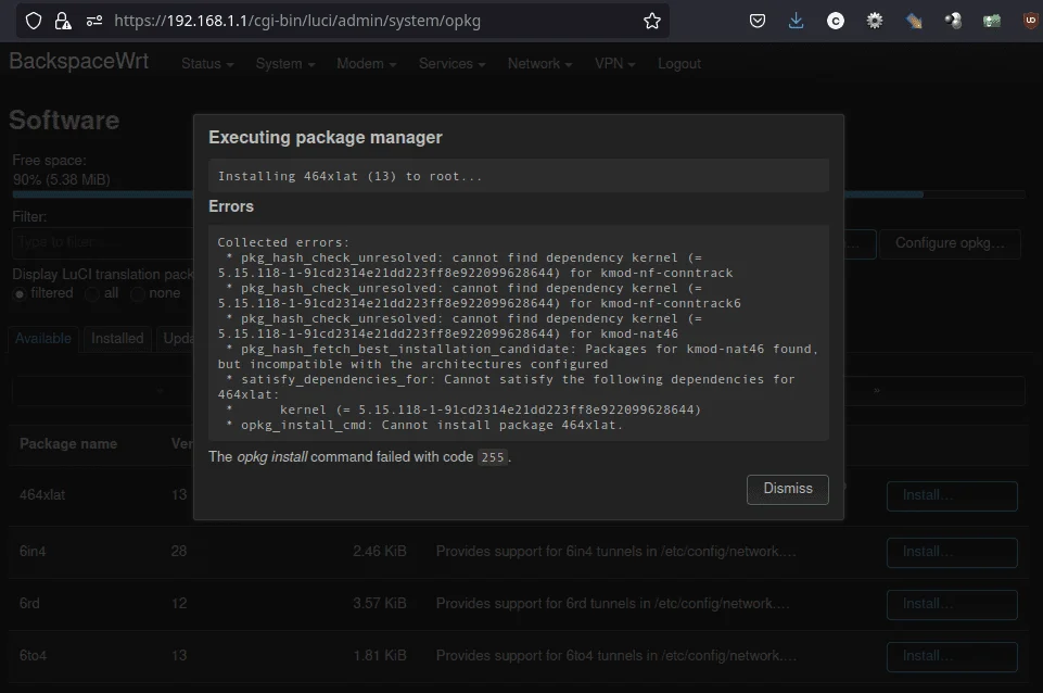

While searching for solutions on OpenWRT forum, I found another theory that might be causing my router's modem connection to failed; could it be something regarding IPv6-only network as mentioned on this post: You do not have permission to view the full content of this post. Log in or register now.
but I don't know if the package You do not have permission to view the full content of this post. Log in or register now. is included on this firmware... if not, I just hope it could be included on the next release...

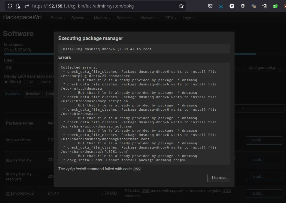

I've tried to manually download and install couple of packages (You do not have permission to view the full content of this post. Log in or register now. and You do not have permission to view the full content of this post. Log in or register now.)

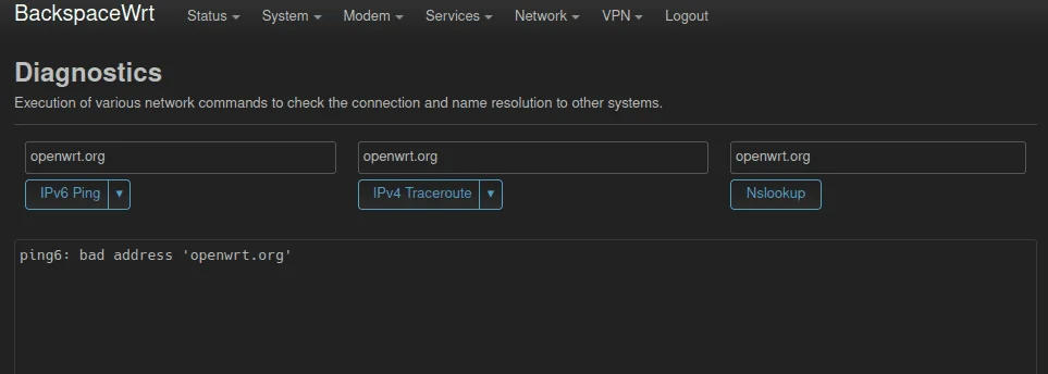

that might resolve my issue connecting on this IPv6-only mobile provider, but unfortunately installation failed with the following errors:

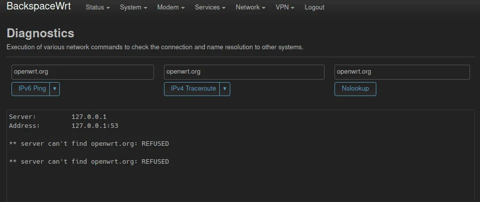

Reset the router to default and re-configure the modem:
Did not configure WiFi since I'm connected via LAN, although I cannot confirm either if the modem have connected properly or not due to the 3g-info-lite errors I've mention on my earlier post (but I can confirm that the SIM if working fine with my cellphone).
Ping test:
DNS / Nslookup:

Is eth0 the device representing the modem? If it is... I think it's getting connection but only assigned with IPv6 address??? please kindly correct and guide me since I'm not an expert, just trying to figure this out by research.
Also I notice and think that maybe the modem/router is not getting DNS:
Code:
root@BackspaceWrt:~# cat /etc/resolv.conf
# /tmp/resolv.conf generated by Unbound UCI 2023-06-04T13:22:38+00:00
nameserver 127.0.0.1
nameserver ::1
search lan.
root@BackspaceWrt:~# cat /tmp/resolv.conf
nameserver ::1
search lan.
root@BackspaceWrt:~# cat /tmp/resolv.conf.d/resolv.conf.auto
Again, please kindly correct and guide me if I'm not checking it correctly.
Hope that some of these could help improve the next firmware release.
Thanks and more power!

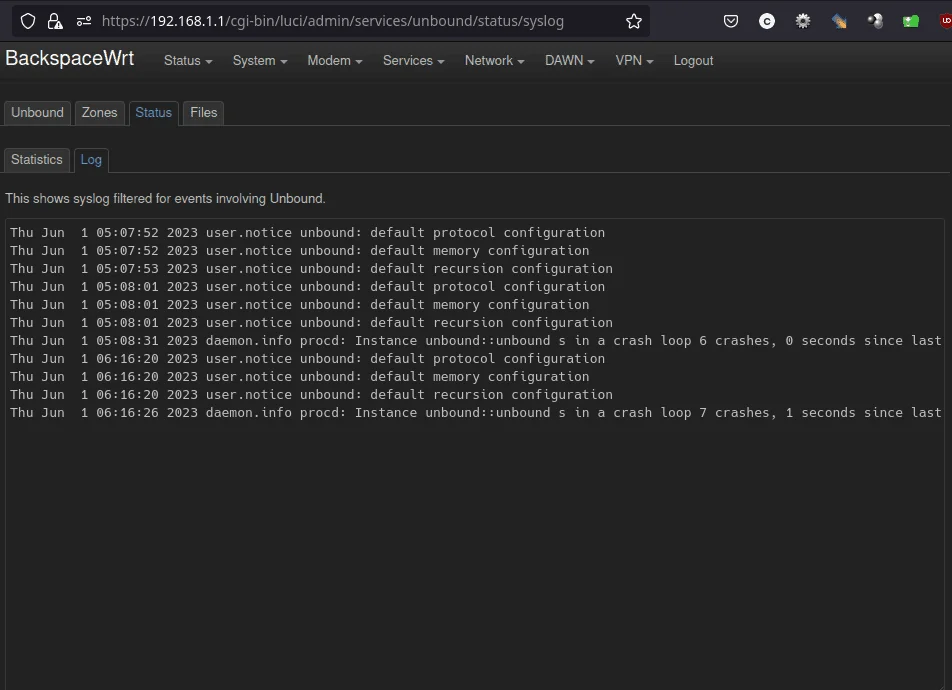

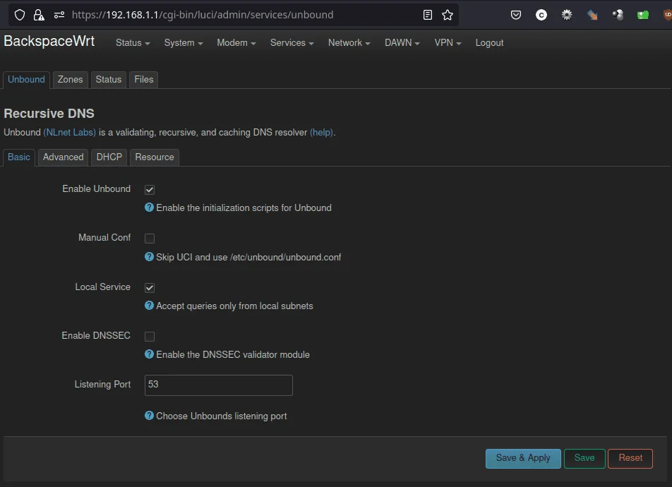

Some more findings... so this firmware is using recursive DNS - You do not have permission to view the full content of this post. Log in or register now.:
Unfortunately the service is going into crash loop:
I haven't change any configuration regarding this Unbound, so I don't know if there is a problem with the default configuration...
