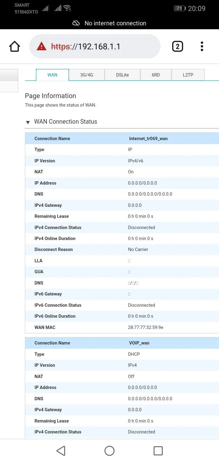

Also, can you access your 192.168.1.1?
Depending on what modem, it should have an option there na makikita mo ang optical information mo.
RX Power (or Received Power, in some modem) ang tignan mo kung ilan ung nasayo.
It should look like this:
oh, blinking PON means "high reading" yung nare-receive na RX power papunta sa modem. Usually, re-splicing lang yan ng mga SC connectors, both sa mga nasa loob ng bahay niyo at ung nasa NAP box.
Call 171, gamit kayo smart/tnt/sun sim para free kasi kung blinking PON yan, malamang wala ring dial tone ung telepono niyo at di rin kayo makatawag gamit yun.
hindi po ma access 192.168.1.1 at may deal tone Pro d makatawag....... try ko e call 171 free ba yon
