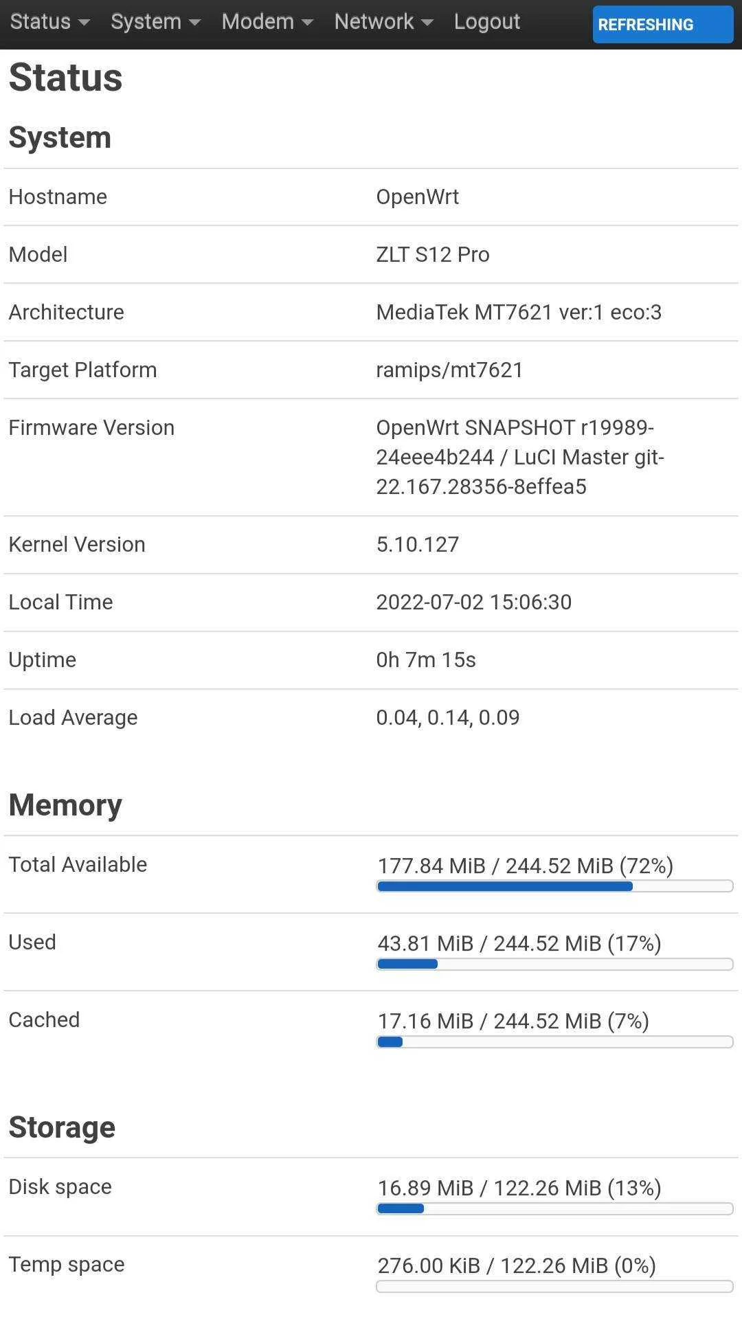

[TEASER] Openwrt support for ZLT S12 PRØ
Getting it booting is the easy part. It's just a standard mt76 device :)

Yep, you can do that. There might be just missing functionality (likely leds and anything controlled by gpio) but it "works". A lot of these mt7621 routers just have the ethernet switch on rgmii1 so it's pretty straightforward to do a device tree. We already have a fully working router (save for LTE) by the time this was posted (it didnt really take long since we have someone with experience on mt76 devices).

To answer your question, yes, bootup time is much faster now in vanilla Openwrt vs the custom one from the manufacturer. Wireless performance is great. 😊
