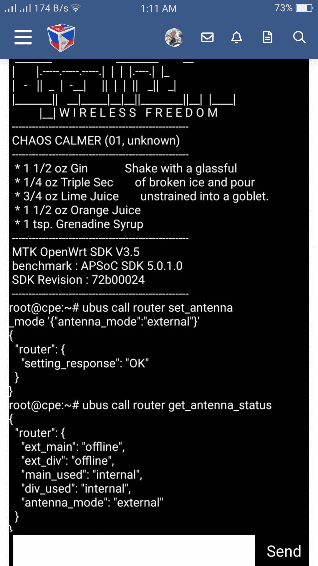

Oks Lods unlang, Baka need mo ung customized firmware Ameee.rus baka un ang Solusyon sa forced external antenna, Try mo Kontak mo nalang sya mukhang affordable naman ung gcash na 300
Kung sa free ka, Lods
Try mo apply ung Ubus command pang forced apply external Antenna
Try kuto

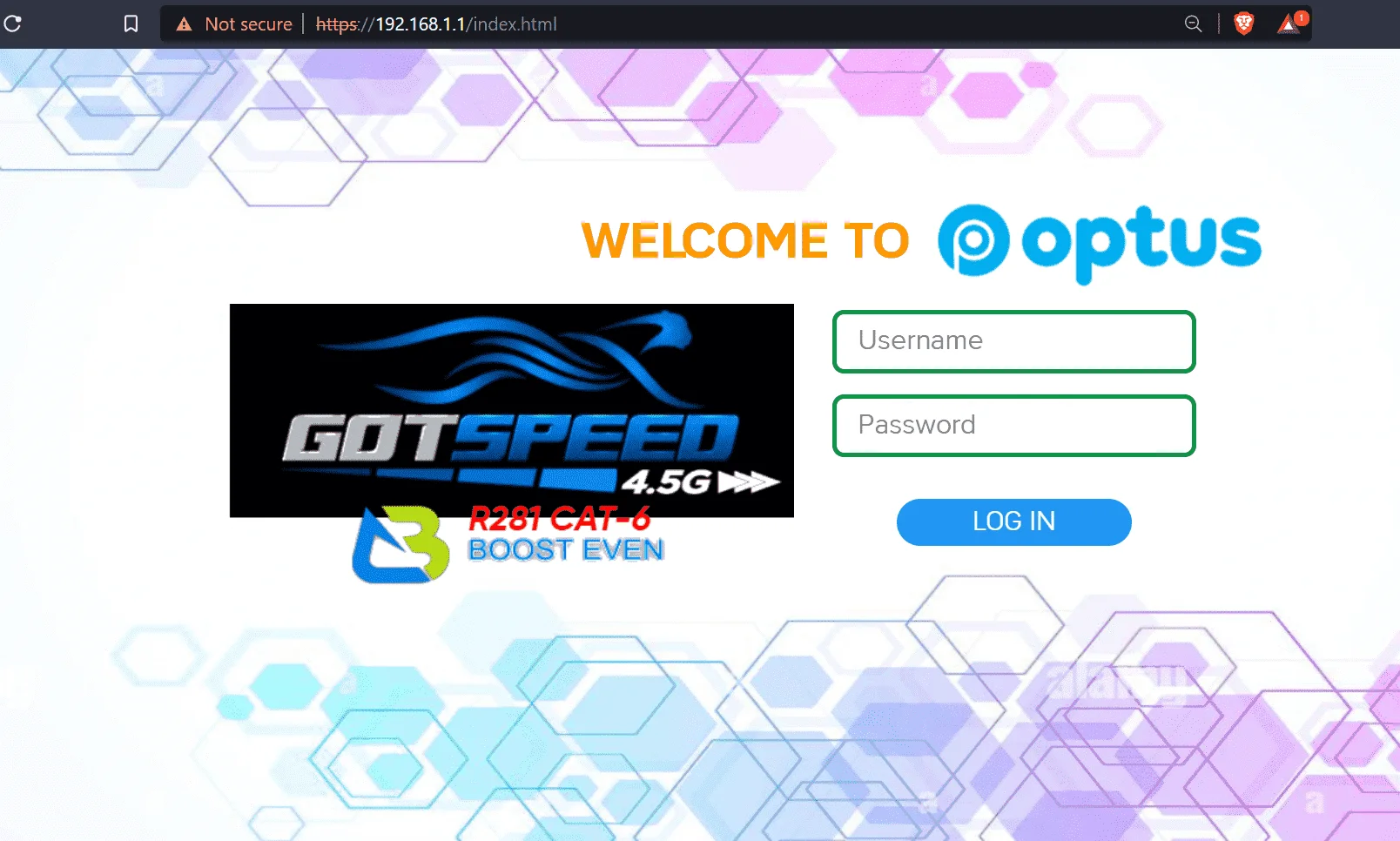

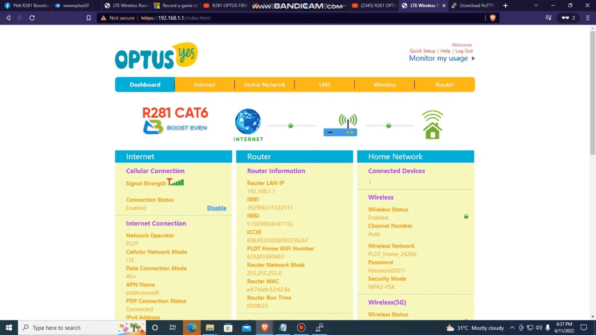

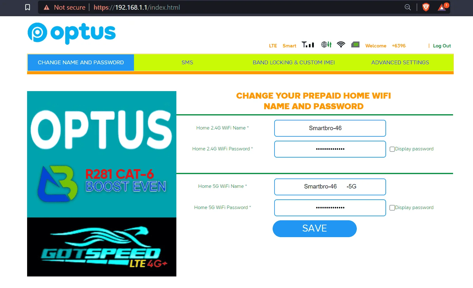

Ganda ng WEBUI
Simple at lite Gui yan Lods
Gaya dunsa gawa ni Lods, Ameee(Rus)

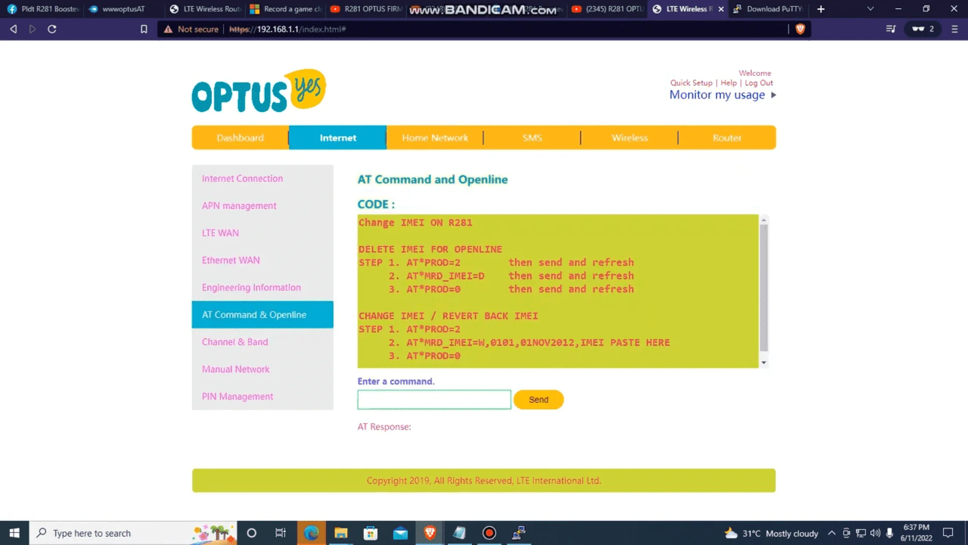

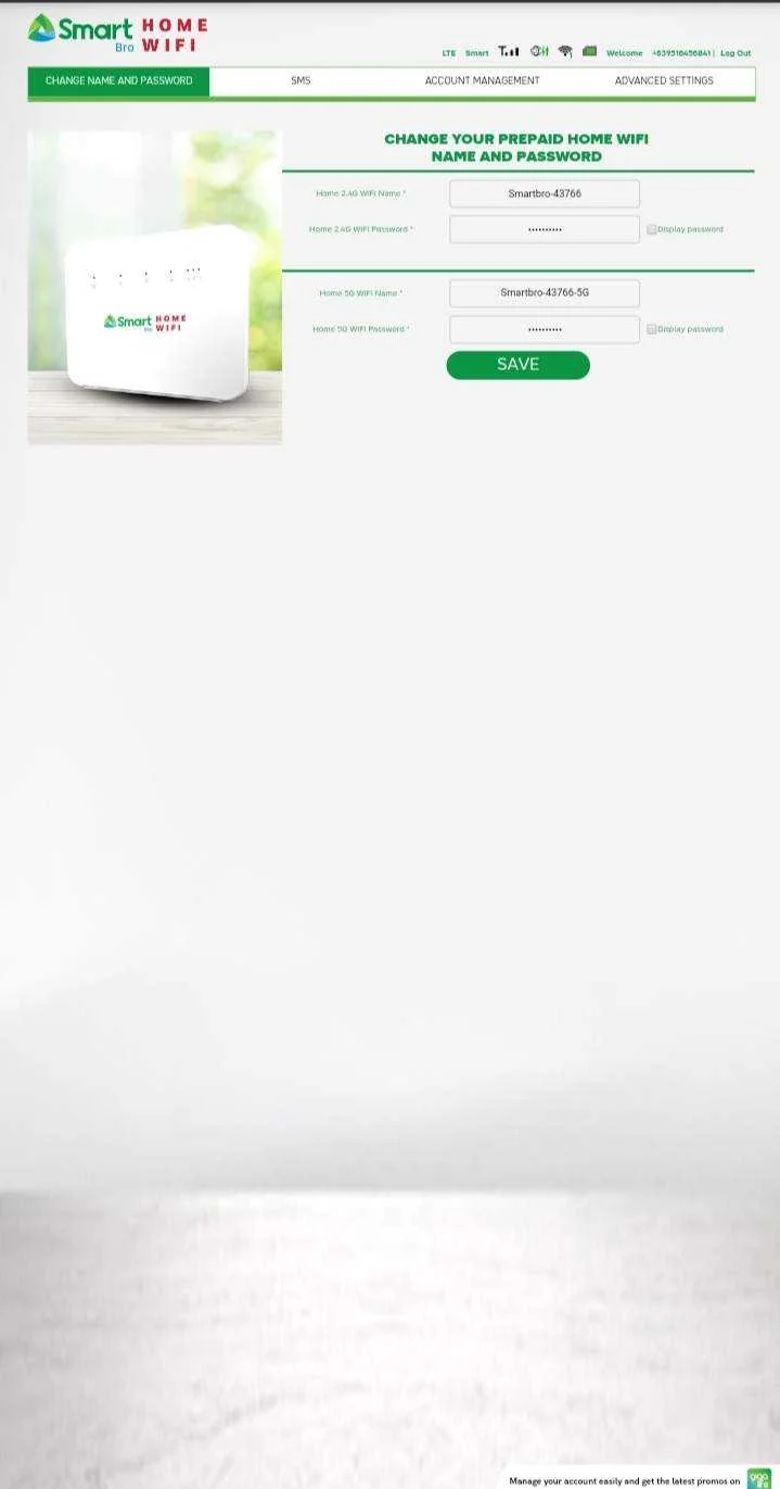

Maganda un kac may Signal Bar, factory unlocked with Imei pero may kunting Charged, yung Optus R281 Dashabord, Dark Notion Gui Dashboard at yung Lite Smartbro v52 baseband 3
Screenshot_2022-07-12-16-53-20-97.webp Screenshot_2022-07-12-16-53-49-77.webp
Buti pa, ibahagi mo na Lods kahit hinde pa factory unlocked with imei
Marami, matutuwa at magpapasalamat sa uGod Bless sa pagbahagi kahit images lang, hehe
Maporma at maayos Tingnan R281 Optus v2 na yan
TS, pa help naman hindi ko maiintindihan nangyari sa r281 ko? Ito po nasa ss. Walang home po. Hindi ko makita version.

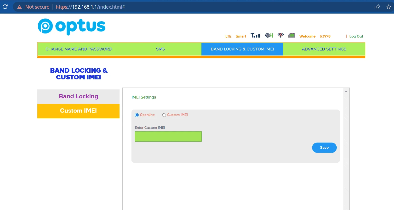

Muzta Lods, na try mo na yung r281 Dashboard na Optus from Rus(Lods Ameee at Lods Marukoy(Lucas Liam)
Lods Ameee, shared mo dinsa amin r281 modified optus Gui Dashboard
God Bless, sa dami ng free na nabahagi
di sakin yan galing boss haha
yung notion lang akin based diyan sa orbit pero may mga bug yan kaya di recommended kung gamitin natively
