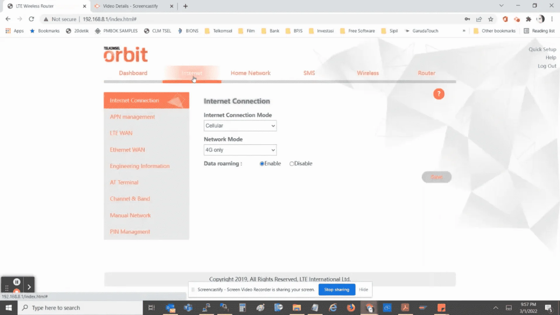

👨‍🏫 Tutorial R281 Modified Custom Dashboard Web UI Orbit PR0 Lock Band & Lock Cell ID with USSD
Xpmove12
Forum Veteran
Orbit Pro R281 Lock Band & Lock Cell ID on Web UI with USSD

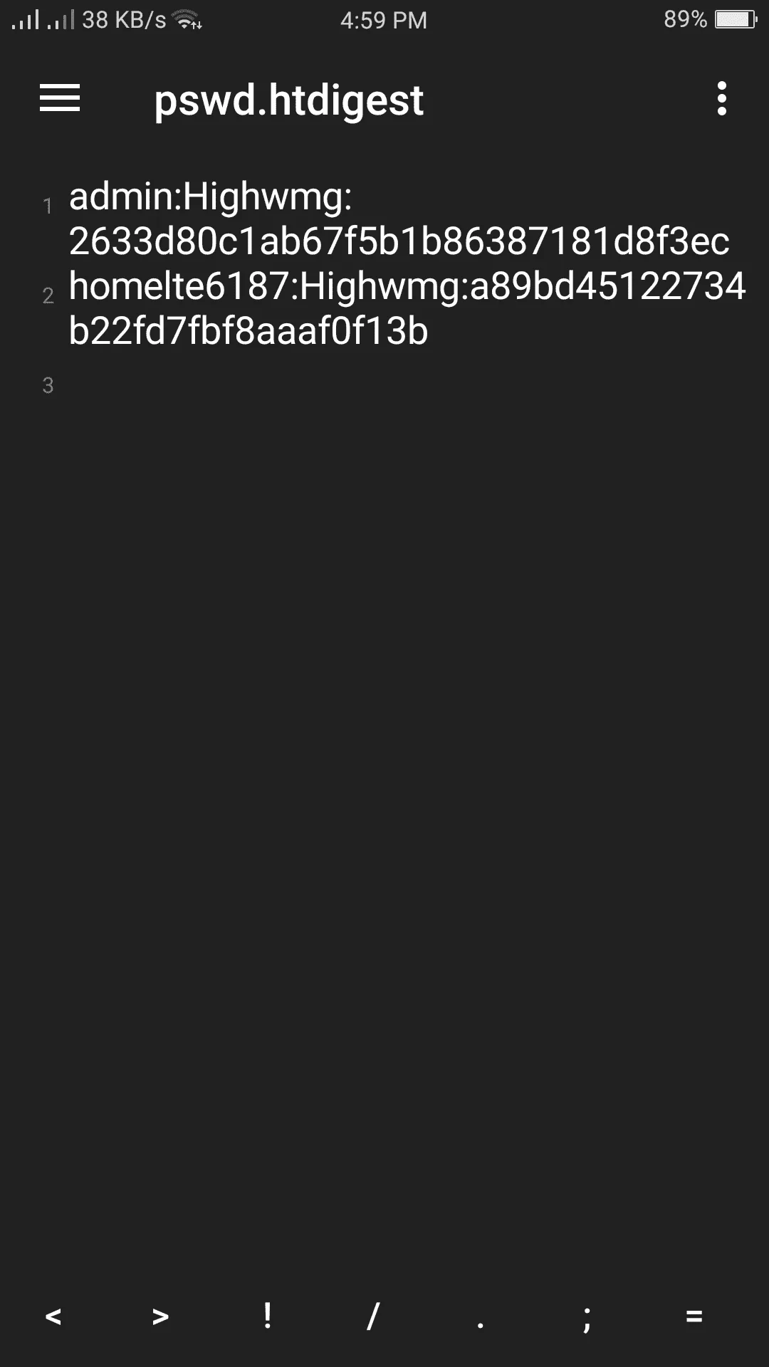

Dashboard ui pass and username
User: homelte6187
pass: admin
Recommended sa Pldthome R281 v43 Baseband 2.3
Smartbro R281 V52/v53 Baseband 22/V003/31
PC/Android Smartphone & Google Chrome are needed

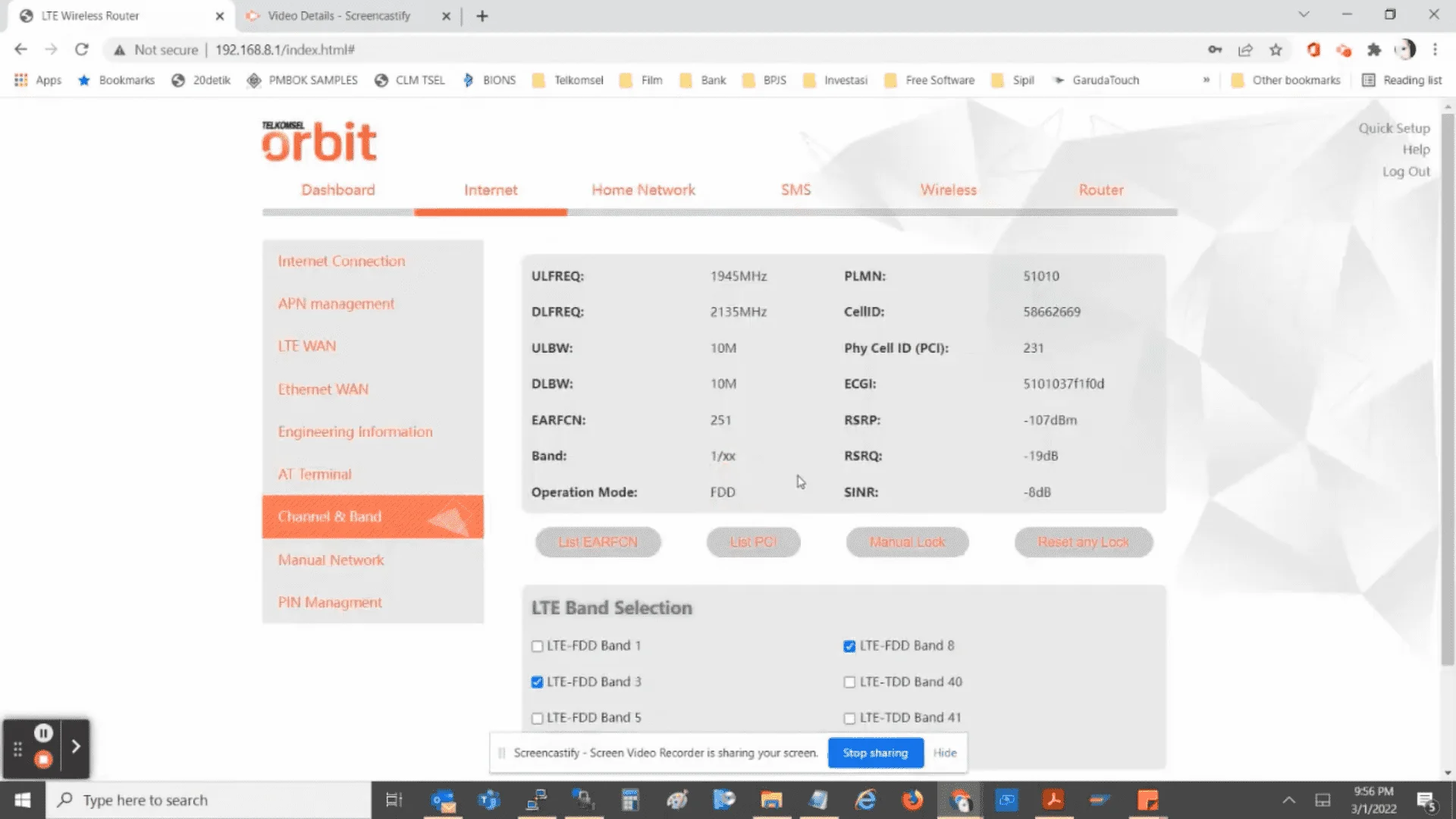

Add modified R281 webui ORBIT PRO with Bandlocking

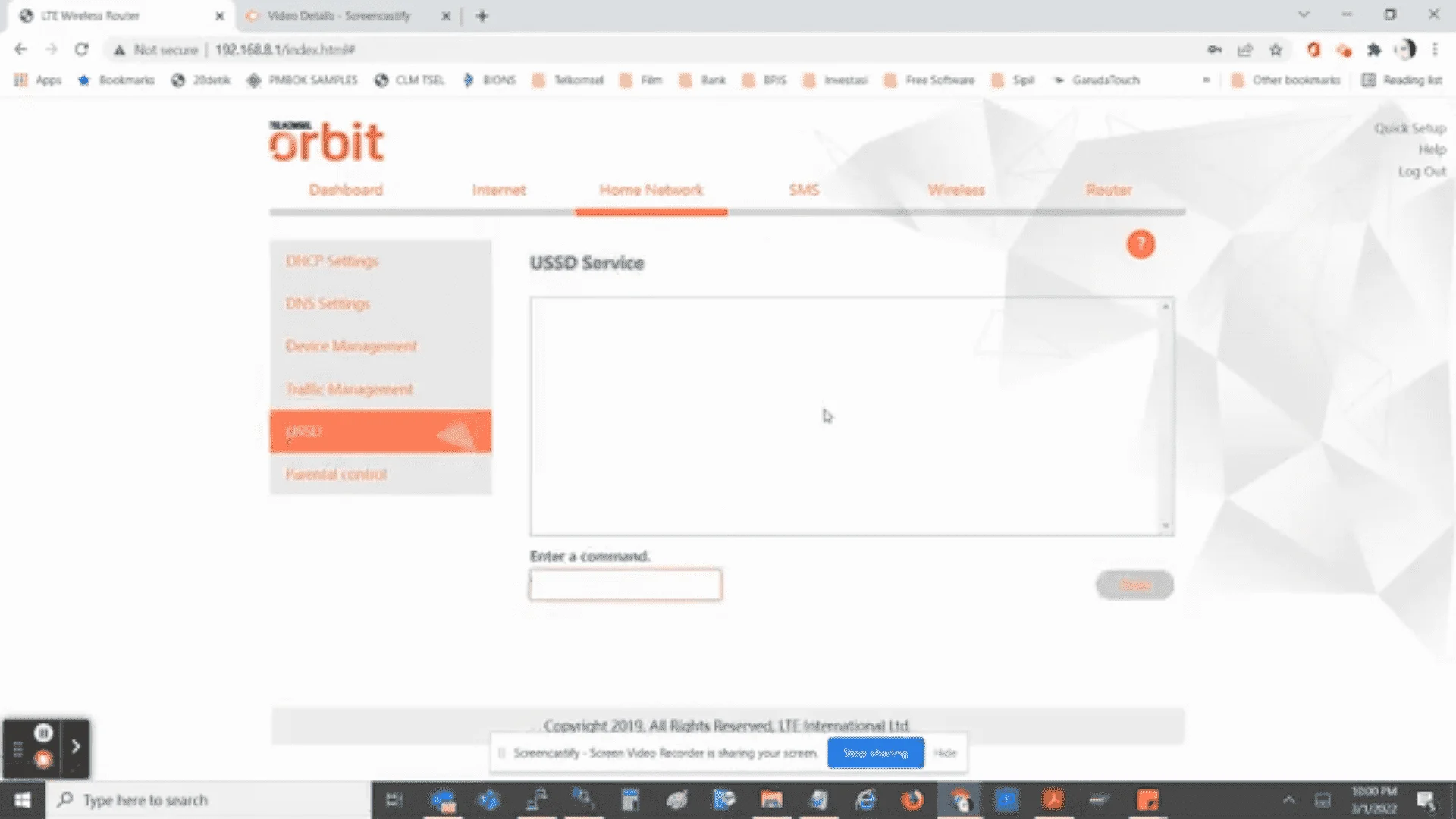

Pero sulit to Lods, may built in Ussd na
Inside dashboard ka na magre-register promo, Dial *121# sa smartbro/smart/tnt
Globe/Gomo Dial *143#

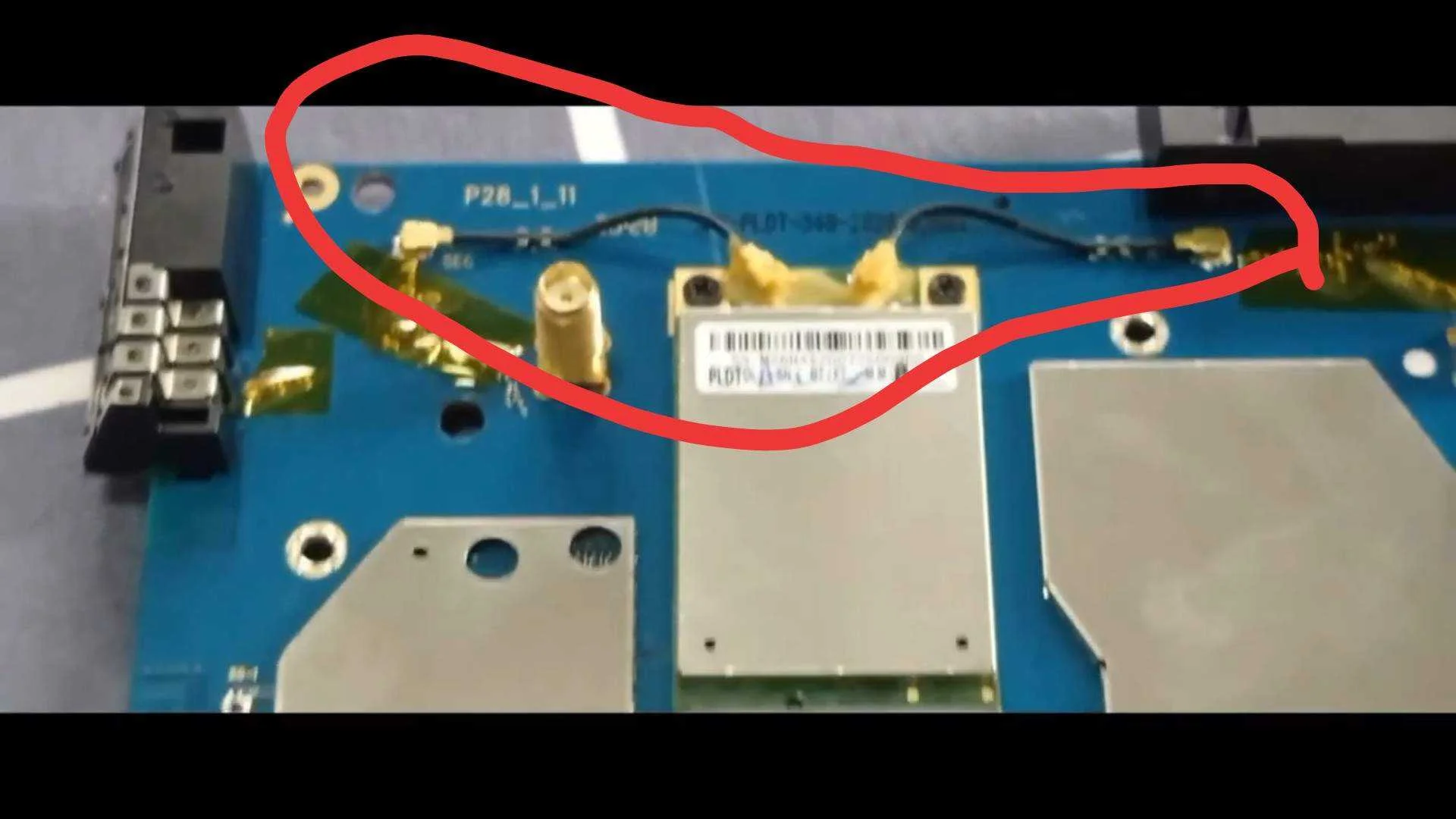

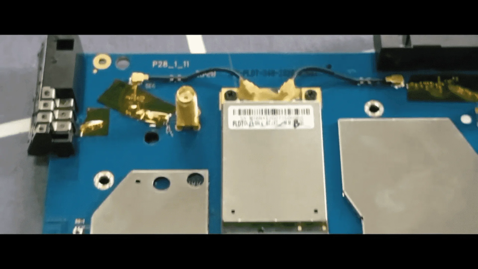

Yung antenna port ibig sabihin ko Boss😁😁 yung dinadag dagan nila ng antenna port mino modified nila tanung kulang kc kong saan yan ikinakabit sa board ng r281 yung antenna port bali hinde na nila ginagamit yung main antenna port. Wala kc ako makita na tutorial sa YouTube
Yung antenna port ibig sabihin ko Boss😁😁 yung dinadag dagan nila ng antenna port mino modified nila tanung kulang kc kong saan yan ikinakabit sa board ng r281 yung antenna port bali hinde na nila ginagamit yung main antenna port. Wala kc ako makita na tutorial sa YT vid
Oks Lods, direct daw sa module ung New modified antenna port ng r281, pero wla pa kac full Tutz. Hanapin mo sa Board ng r281 ung mga module, antay tau may maglabas, Lods
May narinig lang ako dunsa isang Yt vid Tutz, kac ung proof nya more than 23 hours no disconnection r281 nya, naka modified firmware din, permanent unlock with imei/factory unlock, Firmware v42, Baseband 20
Check yt ni Freekonek
Dunsa D2k, Lods direct sa module ung antenna pag nag modified ka d ba,, kaya quick na lang din gawin, ung r281 kac module to board ung pagkagawa ng built in antenna port
Tingin sa image, hehe
Alam mo na kung saan ung ida direct para sa r281 modified antenna port

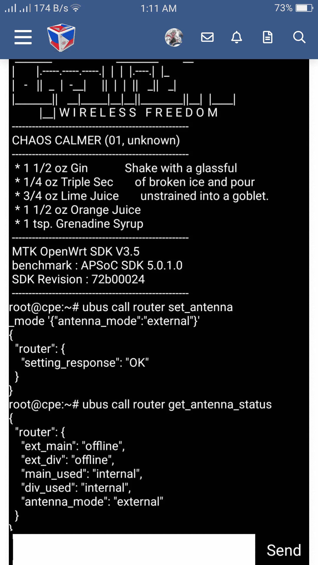

Nag try na ako Lods. Laging nakalagay internal antenna ayaw mag external 😂
Naka hybrid mimo antenna ako
Oks Lods, ano results kahit internal wala ba cdc, kung hinde magdi disconnect magdamag oks na, forced mo rin apply external sa ssh via edit codes
