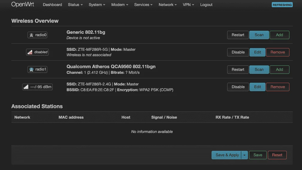

i have problem my 5ghz wifi not actived, how to active sir?
or any one can help me? Thanks
You should factory reset, press and hold the reset button for 5secs or more or go to System > Backup And Flash > Restore, then click Perform reset, if you don't know how to rebuild the config section for the 5Ghz WiFi via terminal.
Take note of your other settings before you do the above.
