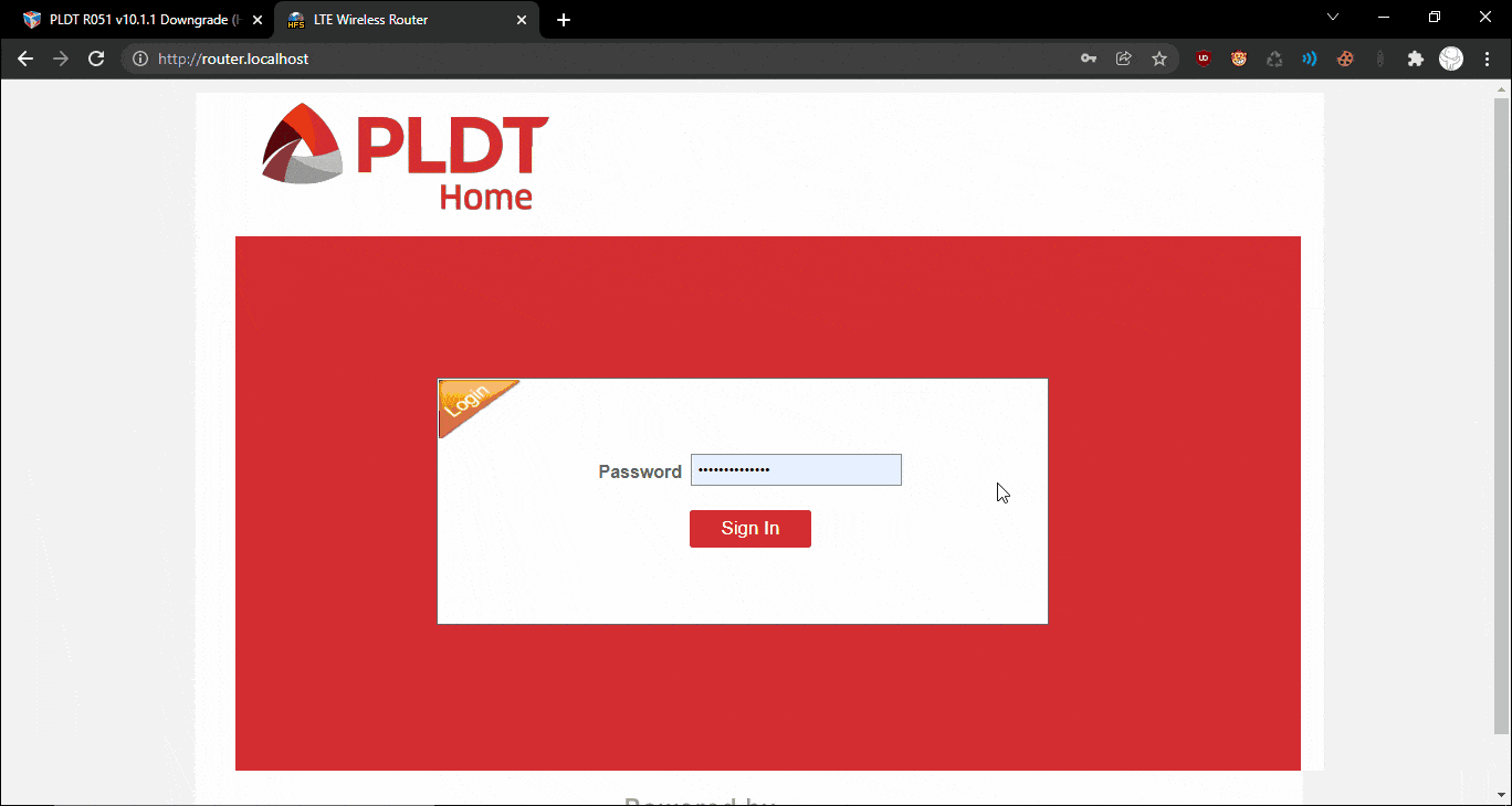

Baka meron na ditong nakapag downgrade ng PLDT R051, pahingi naman ng setup o kahit file nalang na gagamitin ako nalang mag eexplore ano gagawin. TIA.
Software Version: P05IPLDT_AP_R051_V010.1.1
Baseband Version: P05IPLDT_CP_R051_HS_V004.1
Boss anu steps nito same lang sa pag flash ng firmware? Separate file din ba ang pag down grade ng base band? Kasi downgrde ko na kasi to v8 kaso ung baseband 4.1
Kung nakapag downgrade ka, Lods.
Pwede ka mag login sa advance, papasukin mo Telnet, pwede ka mag flash full customized firmware using command mtd write
Kung may pldt firmware ka na pldt v1.1.0
Hanapin mo Lodi Impact2, nagko customized firmware un ng Free, pwede mo pagawa permanent para hinde na mag updates, basta openwrt firmware sisiw lang nya gawin 10 to 15mins, kung active sya tsambahan mo.
Kac nagshared sya ng firmware ng r281 permanent disabled updates with ez bandlocking, meron din mga 3 phc member nag request permanent sa r051, napagbigyan naman cla
Same openwrt firmware ang r051, r01, r281, kasama fx id3, id5 at iba, kaya try mo request s kanya

Cge boss thank po
meron yung customized firmware Lodi Impact2 , permanent V10 baseband 4
With easy bandlocking na un permanent unlock at permanent disabled updates, hanapin mo mga post ni Impact2 nasa r281 bandlocking un
for nginx setup at telnet enable from hawkeye punta ka d2 hxxps://www.YøùTùbé.com/watch?v=5xyLtoY2jqk
for ssh enable copy mo lang ung dropbear code galing pxa1826_cfg, bale dalawang file un /etc/config/dropber at /etc/init.d/dropbear make it executable chmod 755
for v8 file from sir jhowel hxxps://www.mediafire.com/file/1vsgy8e6tmm6v7k/R051_V008_Permanent_Unlocked_Firmware.7z/file
Sir pwede po mahingi yung command ni Hawkeye sa video YouTube nya dyan pag gawa ng nginx
