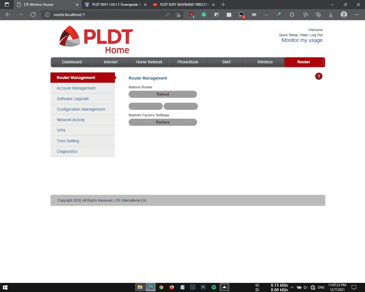

Baka meron na ditong nakapag downgrade ng PLDT R051, pahingi naman ng setup o kahit file nalang na gagamitin ako nalang mag eexplore ano gagawin. TIA.
Software Version: P05IPLDT_AP_R051_V010.1.1
Baseband Version: P05IPLDT_CP_R051_HS_V004.1
for nginx setup at telnet enable from hawkeye punta ka d2 hxxps://www.YøùTùbé.com/watch?v=5xyLtoY2jqk
for ssh enable copy mo lang ung dropbear code galing pxa1826_cfg, bale dalawang file un /etc/config/dropber at /etc/init.d/dropbear make it executable chmod 755
for v8 file from sir jhowel hxxps://www.mediafire.com/file/1vsgy8e6tmm6v7k/R051_V008_Permanent_Unlocked_Firmware.7z/file

Ganito lumabas
access denied kahit pinalitan ko na password sa root
Okay na ba to?
Yan kasi lumabas nong sinubukan kong buksan sa juicessh, tapos notion ginawa kong password
