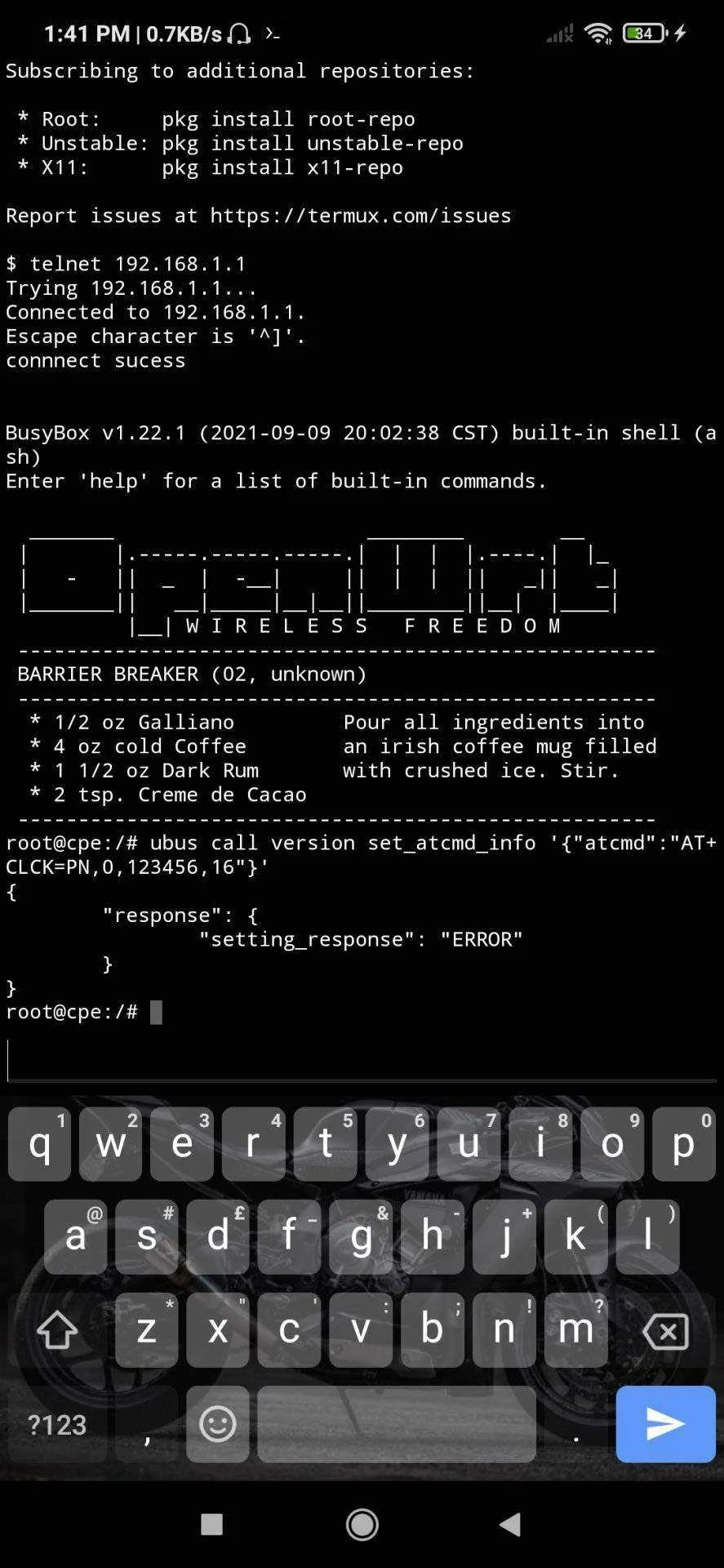

Baka meron na ditong nakapag downgrade ng PLDT R051, pahingi naman ng setup o kahit file nalang na gagamitin ako nalang mag eexplore ano gagawin. TIA.
Software Version: P05IPLDT_AP_R051_V010.1.1
Baseband Version: P05IPLDT_CP_R051_HS_V004.1
1. enable telnet using nginx proxy pass, tsek hawkeye youtube
2. lagyan mo muna ng password root account before enable ssh para maka upload ka ng firmware through scp
3. flash v8 firmware sa mtd5 partition

Lodi baka alam mo new pin ng r051 v10 ayaw kasi ma openline wrong pin daw 123456

for nginx setup at telnet enable from hawkeye punta ka d2 hxxps://www.youtube.com/watch?v=5xyLtoY2jqk
for ssh enable copy mo lang ung dropbear code galing pxa1826_cfg, bale dalawang file un /etc/config/dropber at /etc/init.d/dropbear make it executable chmod 755
for v8 file from sir jhowel hxxps://www.mediafire.com/file/1vsgy8e6tmm6v7k/R051_V008_Permanent_Unlocked_Firmware.7z/file

bale i extract mo lang yong pxa1826_cfg mkukuha mo don config file ng dropbear copy paste mo lang don sa router mo, wag kalimutan mag create ng passwod for root (passwd) bago e enable ssh or else di ka makapasok
Bakit ganito yong sa nginx? Sinundan ko lang yong sa video nya ng pag setup ng nginx
