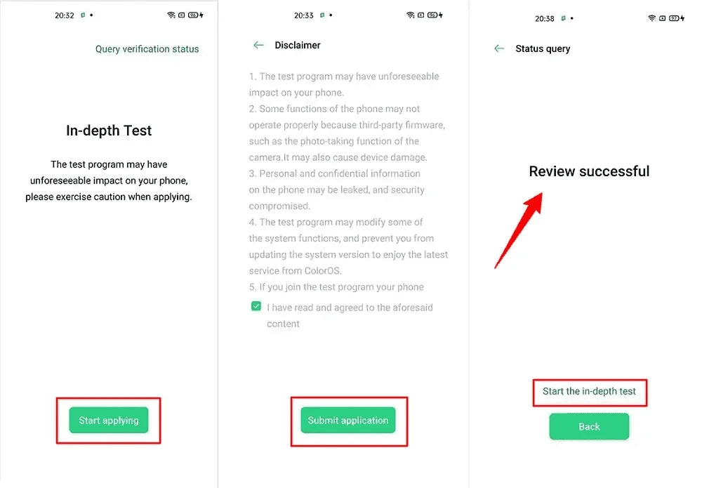

Open the app and Tap on “Start applying.” Accept the disclaimer and click on the “Submit Application” button.
The Realme server will check your application. It may take a few hours to show the “Review successful” message on the app.
Open the app and tap on “Start the in-depth test,” and the device will reboot automatically.

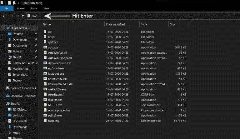

Go to Platform Tool folder.
Type cmd on the address bar of the platform-tools folder and hit ENTER.
Now a command window will open.

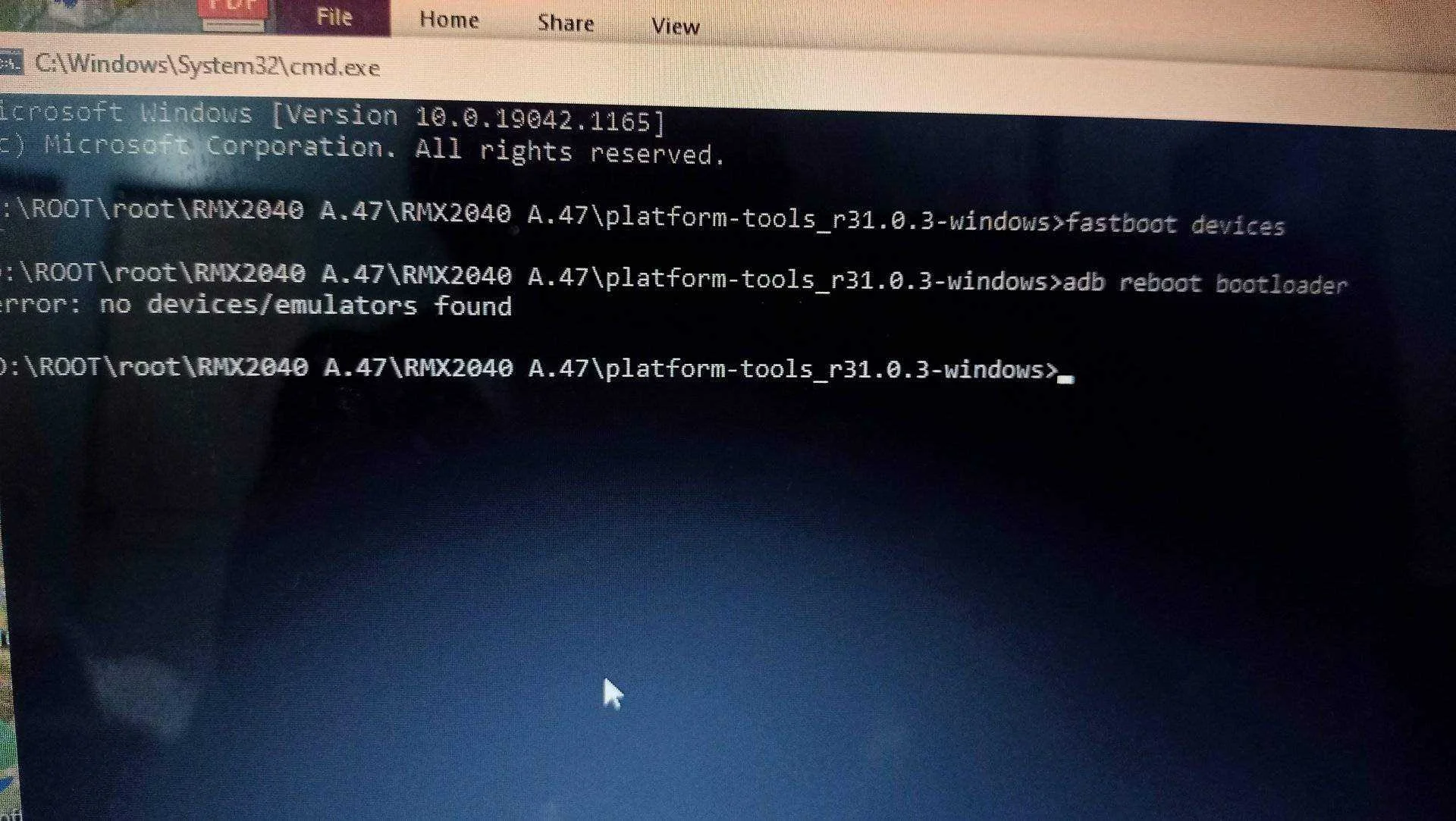

Connect the phone to PC via original USB cable. On the command window type the below command. It should display the connected devices.
fastboot devices
Hit Enter, Next type the following command to boot into fastboot/ bootloader mode.
adb reboot bootloader

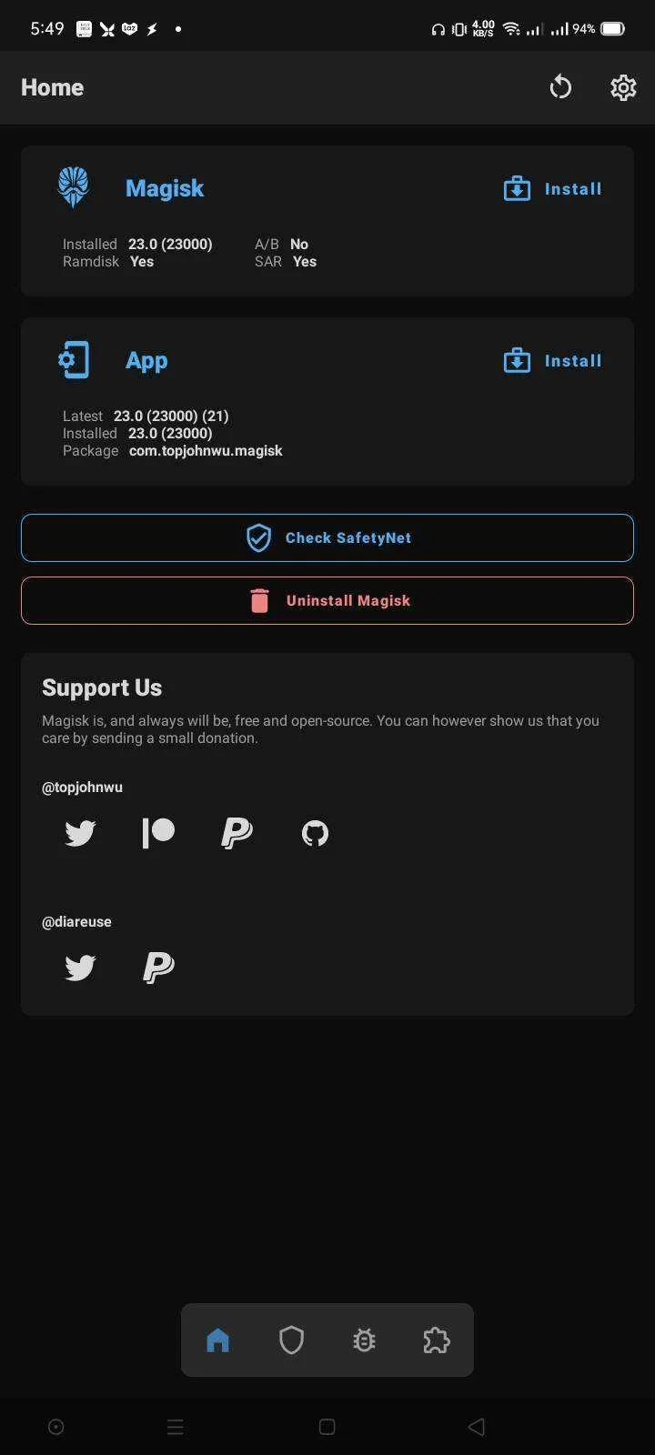

Open the Magisk App, it will ask you to download the full version and click Okay.
After you have download and installed the Magisk app. when you Exit and Open the app again, It will ask you to reboot the phone just click Okay.
After reboot, Open the Magisk App, and it should now show all green checks. and there's no issue in the phone.

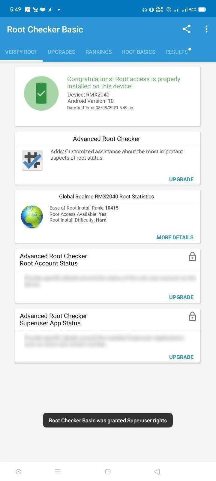

You can check if the root is working by installing Root Checker app in play Store
