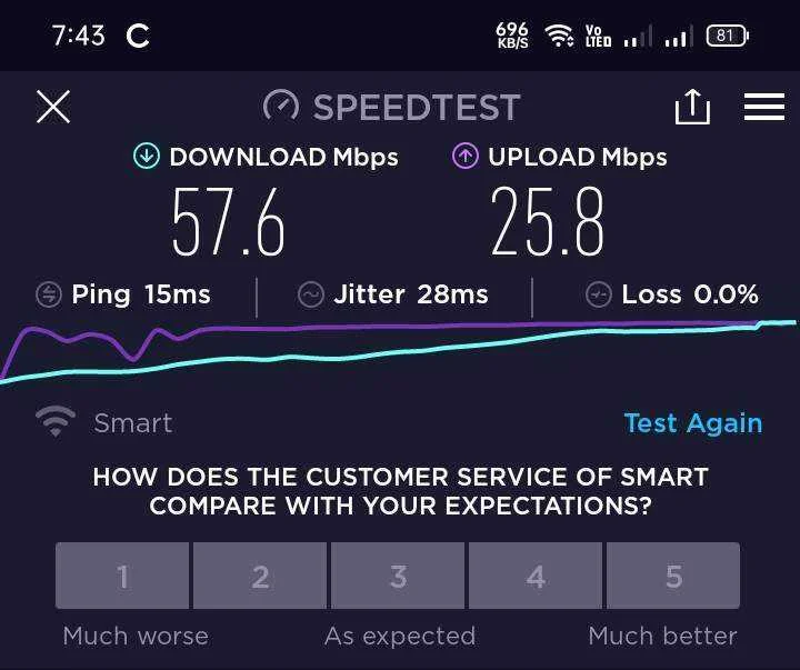

Same lods, kala ko ako lng may problema neto e, ung 3bars signal ko sa best band dto bgla nging 0bars nkkpgtaka
Mukhang nagbigay lang sila ng magandang tower frequencies nung ni- launch nila si Rocket sim. Pero diba hanggang sept 30 lang sya? Tinanggal siguro ulit nila? Lokong smart. haha
if same tower and band obviously may prob tower nyo or congested sa dami ng nagamit rocket sim ngayon
Kokonti palang dito sa province ang nakakaalam ng rocket sim, yung mga kakilala ko, dipa nila alam. haha. Tsaka biglaan naman ata if ever congested. Sana bumalik ang dating lakas.

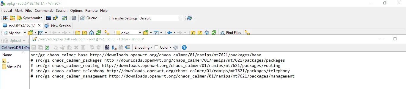

ito ba sir jerome? i mean ganyan po gagawin?View attachment 1648632
Eto sample ng command, Ka phc mtd write Via ssh command yan
” mtd -r write /tmp/firmware name firmware” [Enter]
firmware upgrade openwrt with putty OpenWrt Firmware upgrading process
While upgrading process going device will show “[W]” in last
firmware upgrade with telnet command in openwrt router
Eto full Tutz flashing bin file using winscp openwrt, ssh command
