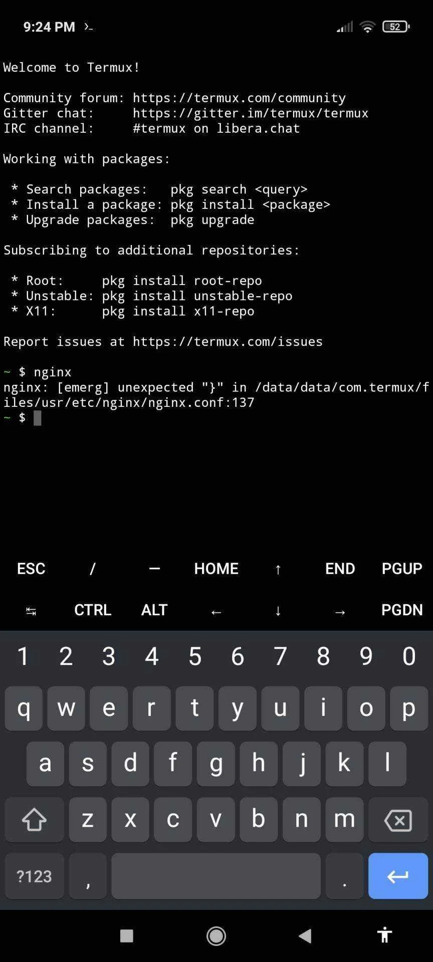

Ka phc Aimee may error dunsa Termux ni Lods, Edward. Paki tingnan sa image attachment, working ba nginx via termux sa firmware v4.0, d ba wala pa nginx non sa firmware v4.0
Nagkaroon lang nginx nong may updates firmware v4.1 at 4.2
Telnet at ssh lang gamit dati firmware V4 saka pwede rin huawei terminal, pero gagamit micro usb at pc, hehe

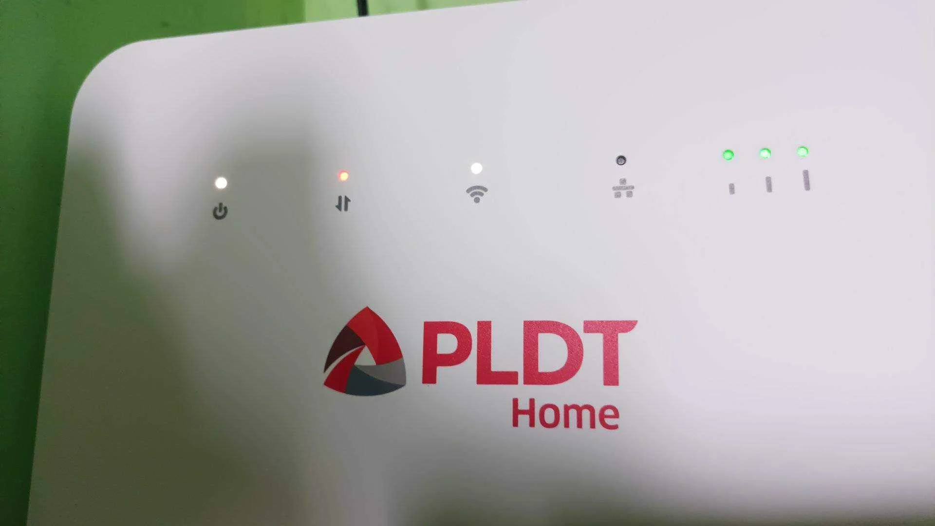

mga lods ako na kaya ibigsabihin neto kapag nakared ang data connection?...pero may internet connection naman ako kahit nakared yan

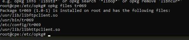

Issuing the command " opkg list-installed " revealed that tr069 is a package then "opkg files tr069" lists the config and libraries used by the tr069 package. So pano kung I uninstall ko tong tr069 na package? mawawala ba yung tr069 capabilities?opkg.webp sana may sumagot hehe.
umiilaw ba tapos yung tatlong signal indicator tas mawawala ulit?
ok na lods..napansin ko lang...kapag nagsspeedtest...dun nagkukulay red yung data nya....kase nakailang reboot nako ,tapos sabay speedtest after that nagrered sya...pero ngaun ok na ,blinking green na sya ,hindi muna ako magsspeedtest 😅
ano kaya kinalaman ni speedtest at nagkukulay red sya after magspeedtest ? 😅
