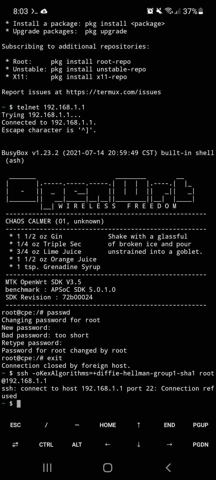

sa R051 mga lods..baka may tut kayo dyan? 🙂
Meron full unlock, jan Lods. I flush mo firmware from R01 from globe kaya lang hanggang 3G lang working, pero working sim Globe at smart, mukhang need ma edit pa firmware, kung may firmware lang sana kay r281 na upload, bwka pwede rin ipasok kay R051👍👍

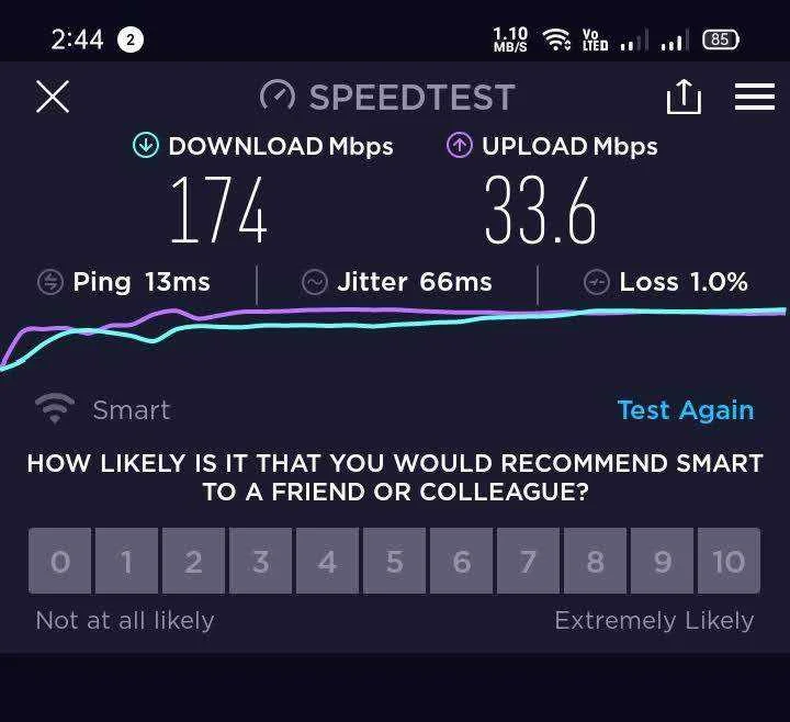

rx channel ata first band sa fdd lte 2ca. depende kung anong bilis hanap mo mas stable band 1 sakin kesa band 3 same tower kaya prio ko for rx yung band 1. band 1/3 din gamit ko eto speed test
A
Anong command po ginawa mo lods? para maprioritize ang band "1"? Ambilis nyan lods, sana all :)
prio band 1 talaga kasi mas malakas signal. sinr first check eh. mas mababa sinr ng band 1 sa 3. tapos znlockband lang gamit ko naka enable lang band 1 and 3 kasi 40 na yung isang band na binabato ng tower namin
