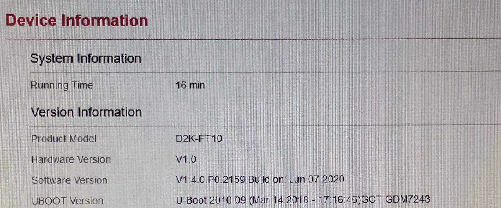

Ano version firmware mo, Lods. Depende sa version at baseband
Eto po ung version sir., hindi ko po alam kung
D2k naman pala yan lods. Swerte mo, inde pa nag updates may method na jan
