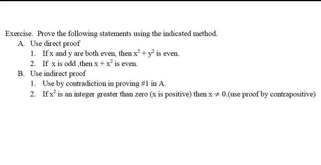

Hi. Idk how to formally write proofs but I'll try to help
A.
1.
Representing the even numbers x and y:
x = 2p
y = 2q
x^2 + y^2
= (2p)^2 + (2q)^2
= 4p^2 + 4q^2
= 4(p^2 + q^2) = 2(2)(p^2 + q^2)
Having a factor of 2, we can conclude x^2 + y^2 is even.
2.
Representing the odd number x:
x = 2k + 1
x + x^2
= (2k + 1) + (2k + 1)^2
= 2k + 1 + (4k^2 + 2k + 1)
= 4k^2 + 4k + 2
= 2(2k^2 + 2k + 1)
Having a factor of 2, we can conclude x + x^2 is even.
B.
1.
Suppose that x and y are both even and x^2 + y^2 is odd. Since x and y are even, then
x = 2p
y = 2q
for some integers p and q.
Thus,
x^2 + y^2
= (2p)^2 + (2q)^2
= 4p^2 + 4q^2
Then the preceding integer 2(2)(p^2 + q^2) - 1 is odd since we assumed that x^2 + y^2 is odd.
This is impossible since there are no two consecutive integers that are both odd. Because the supposition that x^2 + y^2 is odd leads to a contradiction, we conclude that x^2 + y^2 is even.
B.
1.
x = 2p
y = 2q
Thus,
x^2 + y^2
= (2p)^2 + (2q)^2
= 4p^2 + 4q^2
