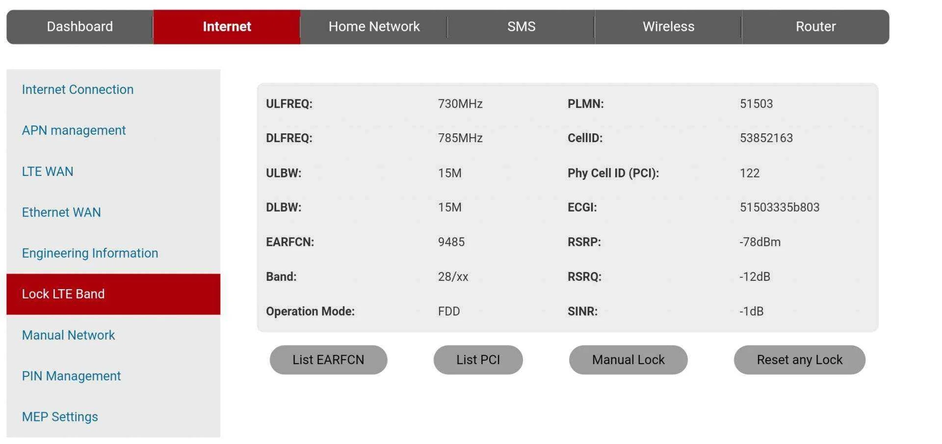

stable 1/3 yan kapag wala na ibang bands dun sa tower mo like 28. Para sa bug ng router na 1/xx dapat talaga active internet usage lang para di ma dc. Gamit ko pc ko para laging active eh send ping lang kahit saan. 1/3 dl speed below

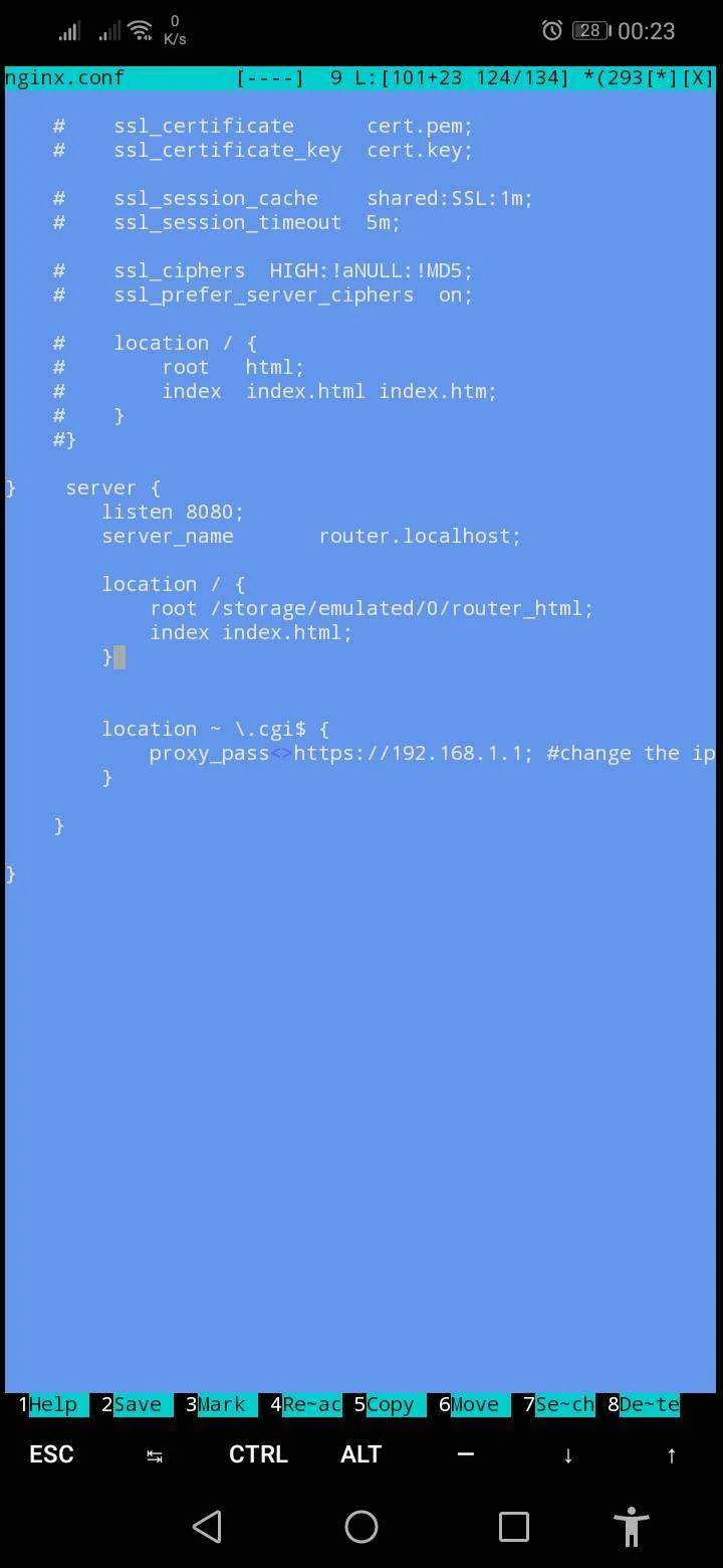

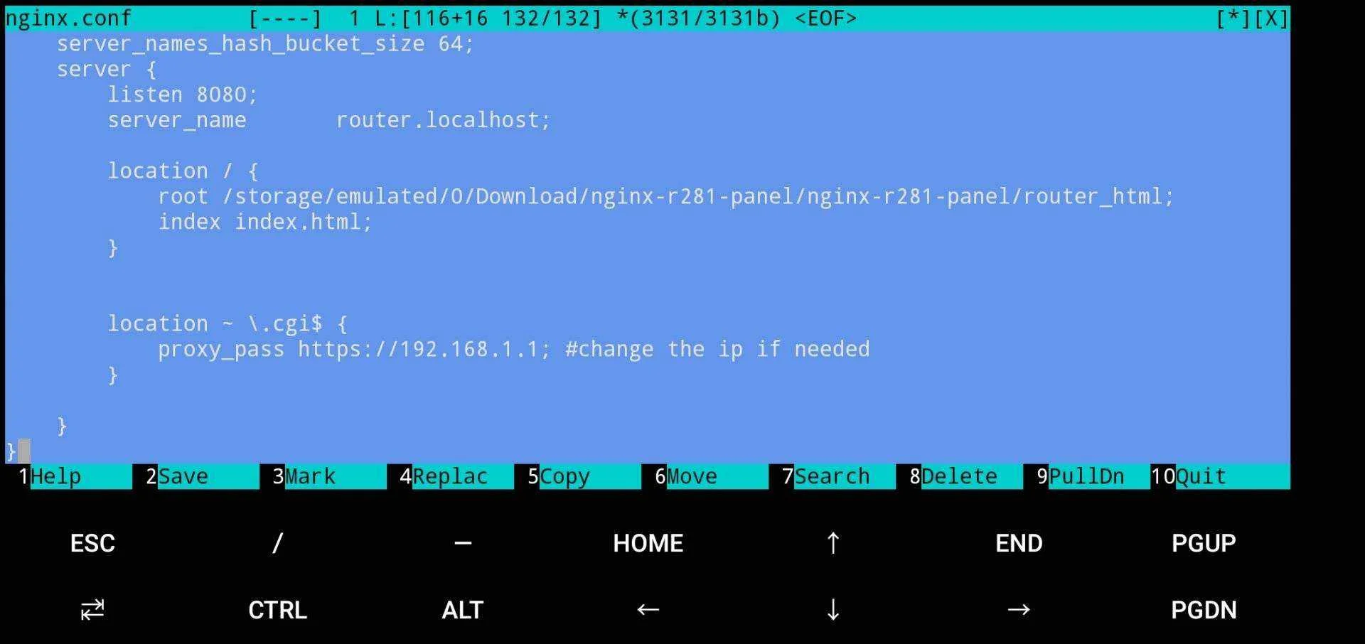

To those who are having issues accessing updated interface using termux if your extracted nginx file is save to your phone storage download files try to use this as root.
root /storage/emulated/0/Download/nginx-r281-panel/nginx-r281-panel/router_html;
I like to achieve an output like this with my boosteven model R281 software P28PLDT_AP_R281_V004.1. I tried the procedure of accessing admin via 192.168.8.1 but I was failed. This is my first time doing this crazy things. Not familiar with the term termux and how to access root in phone. How did you achieve this crazy output lock LTE band.
