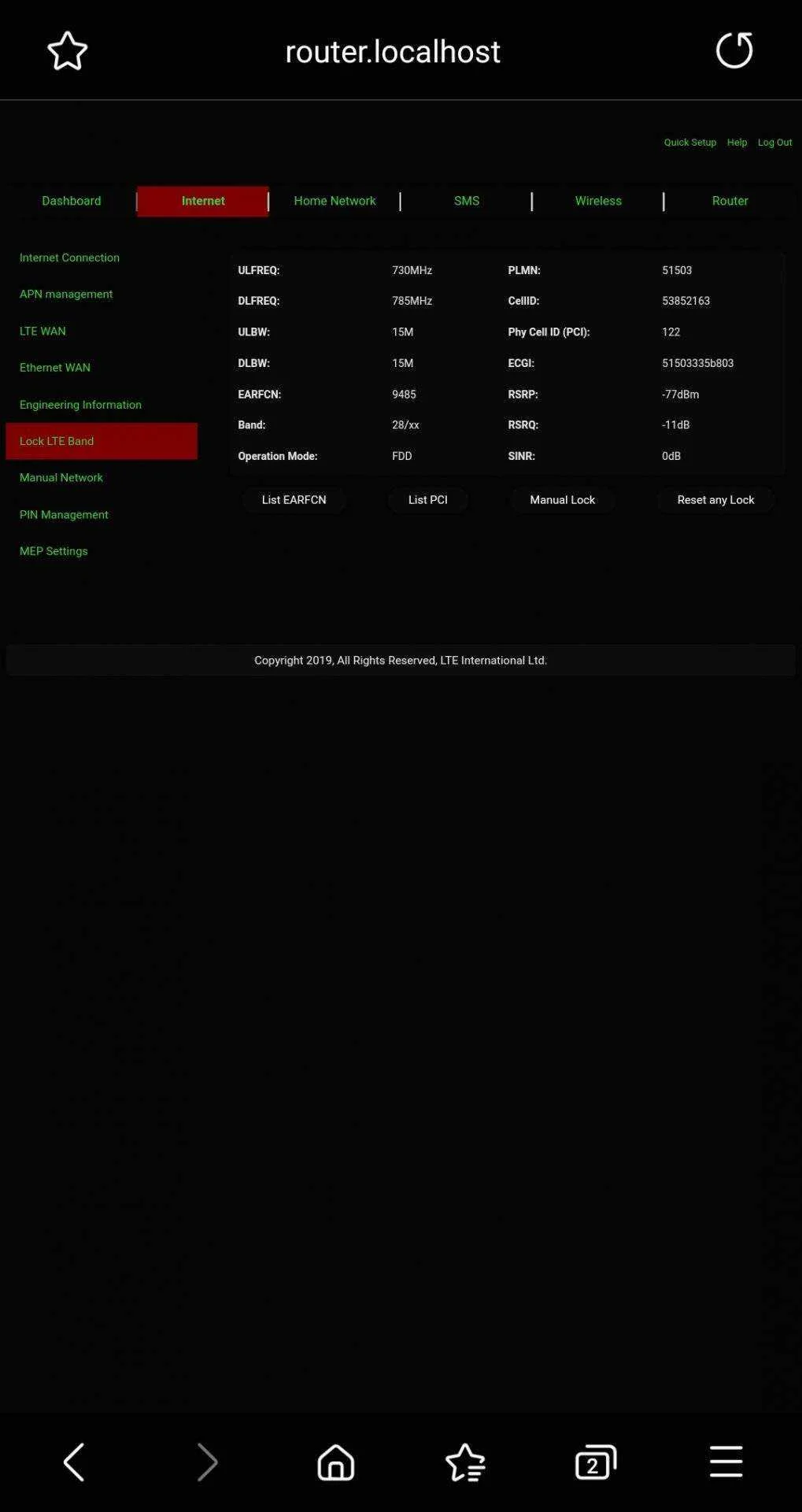

Nag update ang PLDT Home R281 and hindi na gumagana yung openline na AT+CLCK="PN",0,123456,16
Error na ang nakalagay.
Also, openline na sana ako kaso after the update RED na ang signal. Kaya nag system restore ako planning na i-openline ulit kaso error na yung AT+CLCK="PN",0,123456,16

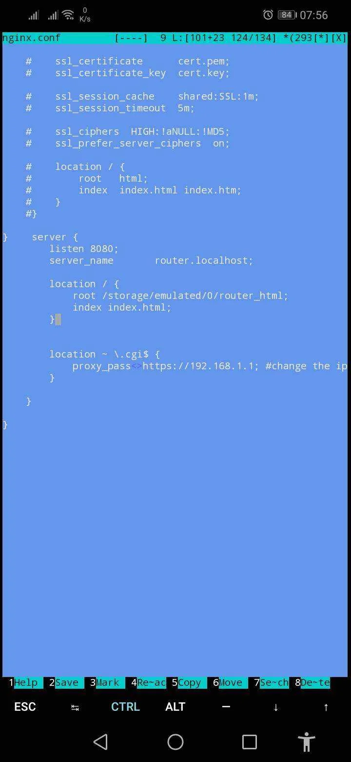

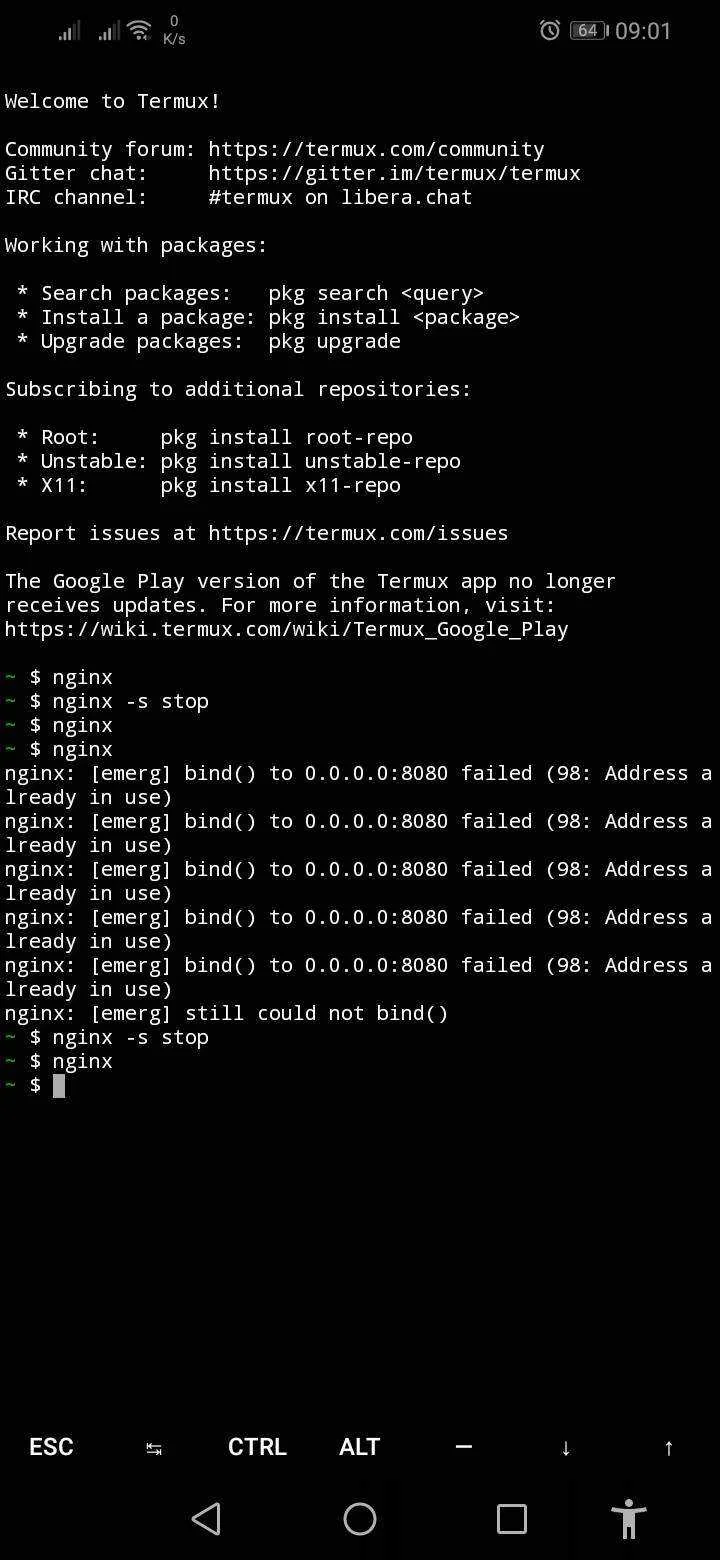

Save nginx extracted files to your phone storage download files and use this to your root.
/storage/emulated/0/Download/nginx-r281-panel/nginx-r281-panel/router_html;

Copy this but first save your nginx extracted file to your phone storage download file.

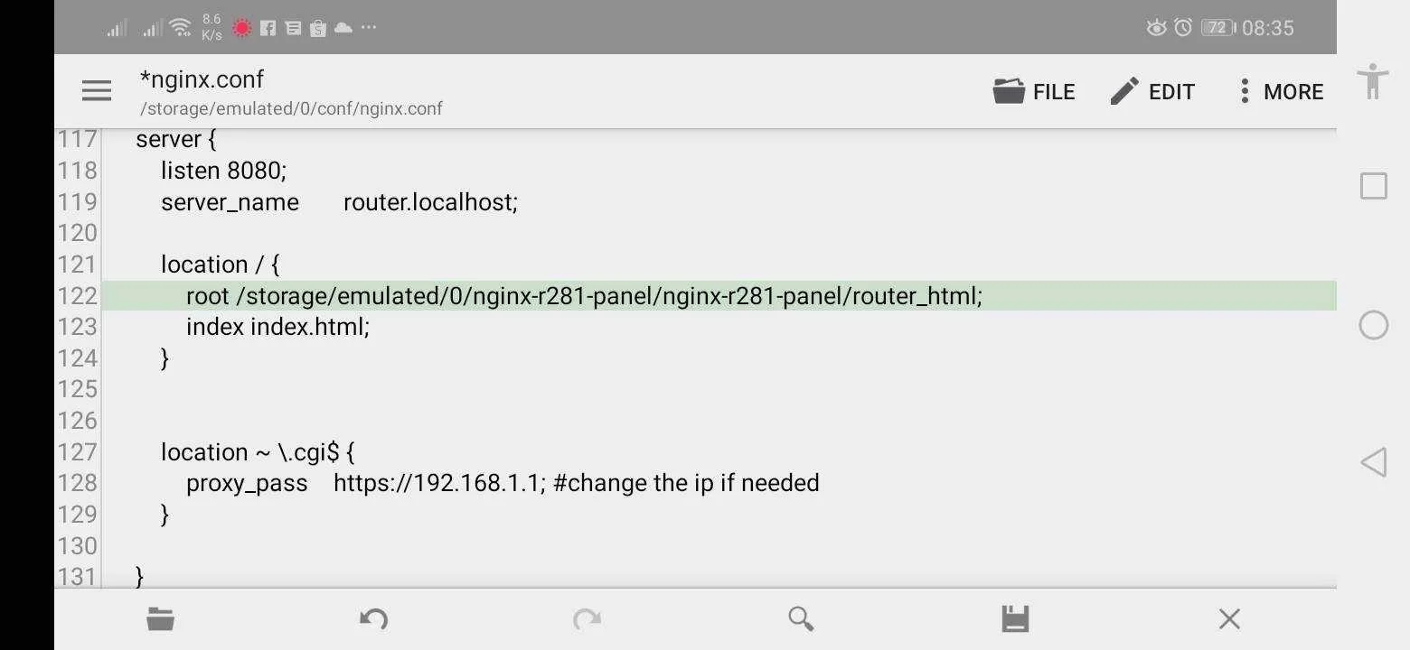

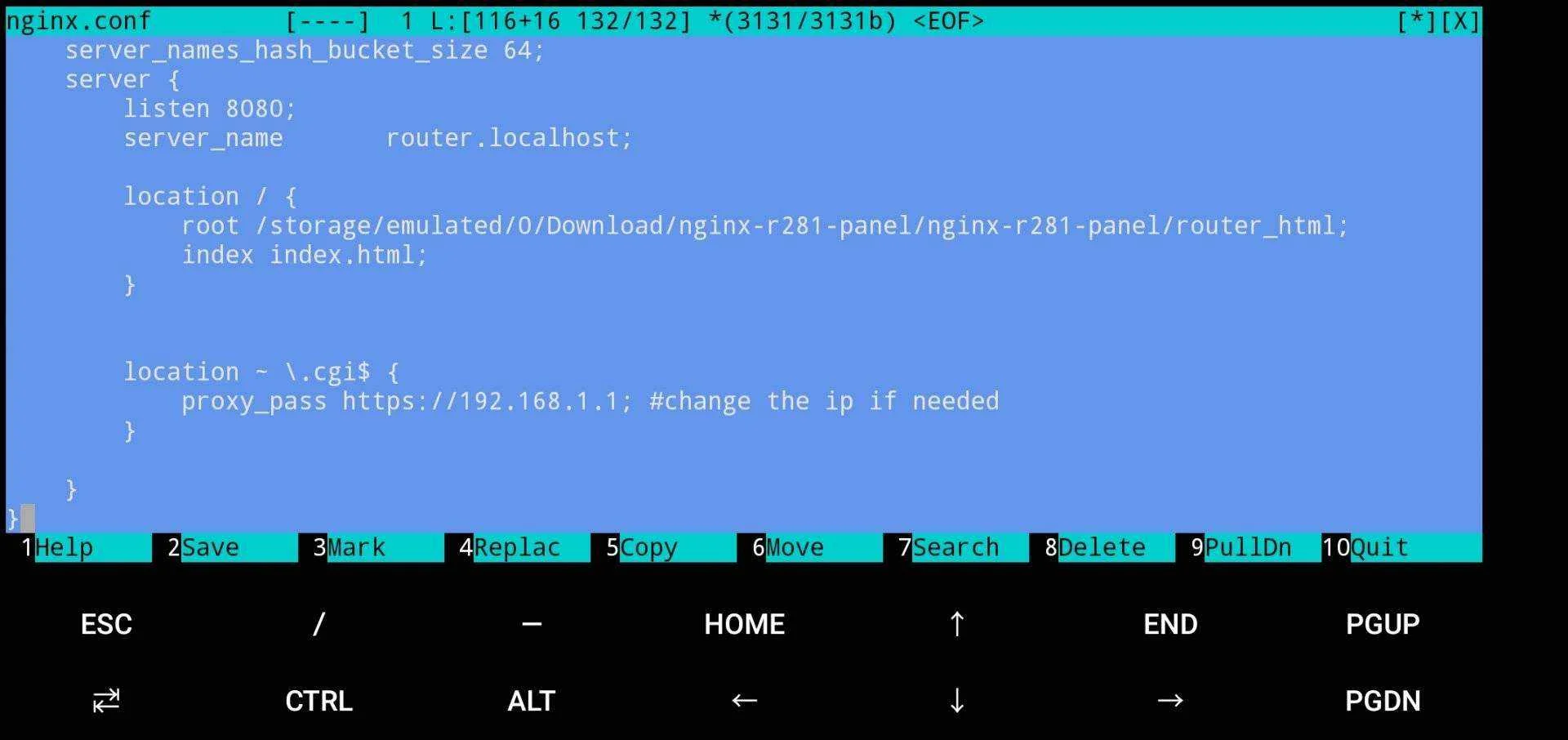

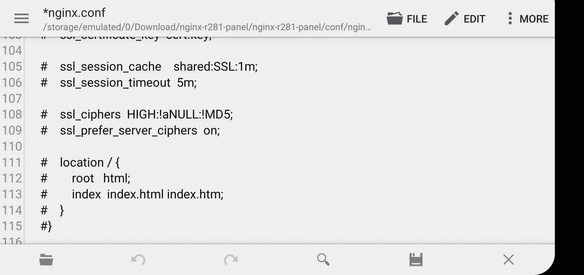

If you still have problem download quick edit then open nginx file for me to give the exact command path just like this command path is on top.
server_names_hash_bucket_size 64; server { listen 8080; server_name router.localhost; location / { root /storage/emulated/0/router_html; index index.html; } location ~ \.cgi$ { proxy_pass https://192.168.1.1; #change the ip if needed } } }
