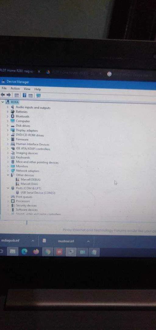

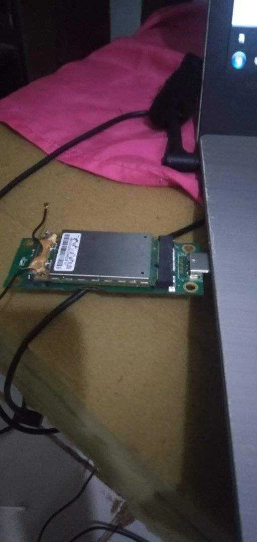

sir, Eugenekey your all our answers of unbricking the R281, I have tried using it mini pcie adaptor but same problem in modem, after a moment, it restarts (bootloop) same in mini pcie, i can access the pic below, after 1 min it restarts and over and over again. hope you can help us or pm me in messenger
donz lequin.
