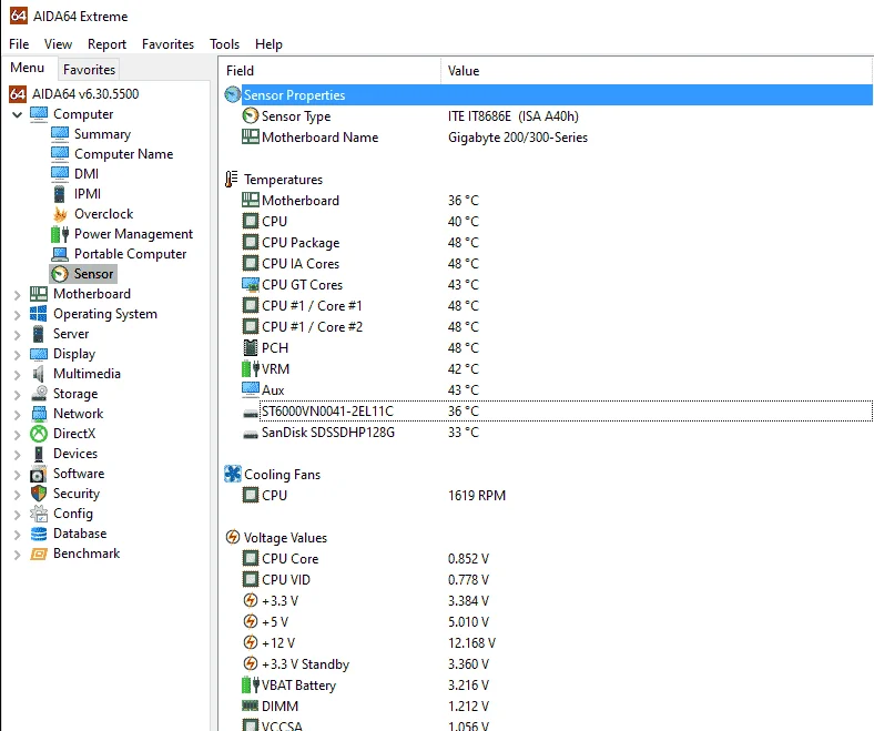

I have a comparable system na ginagamit ko for downloads only, 24/7. It uses a 54-watt Intel Pentium Gold G5400, 1 SATA SSD, and 1 SATA HDD; housed in a Tecware M1 micro ATX case with only 2 120mm system fans. Ang pinakamataas na temps niya ay nasa 54 C lang in a non-airconditioned room. If I remember correctly, nasa 120-140 watts ang konsumo ng buong system when I measured using Omni Digital Power Reader. Kahit isang exhaust case fan lang, sufficient na siguro yun. For comparison, yung PC ko with a 370-watt GPU and a 130-watt CPU uses 7 x 120mm fans plus 2 x 140mm fans for the radiator. More power, more heat, better cooling needed.
Check your temps @ idle and on-load using HWiNFO or AIDA64 and compare with mine @ idle. Kung stable ang system ko na naka-on 24/7, albeit @ idle most of the time, most likely kakayanin rin ng system mo kung di nagkakalayo ang temps natin.

I can't say for sure kasi di ko naman nakita ang pic ng generic case na tinutukoy mo. Di ko rin alam kung ano ang workload/use case mo at kung anong temps. Kung pwede mong lagyan ng multiple 120mm fans sa front, top, and rear, like my Tecware M1 case, then okay yan kahit rear exhaust lang muna ang fan.
