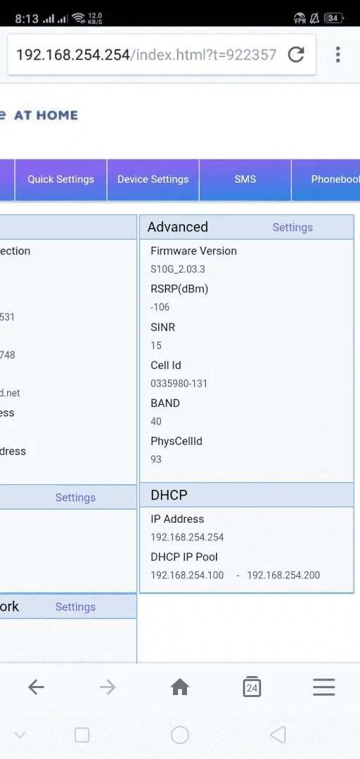

Device settings > Advance settings >
tap DHCP 3x to make sure na activated

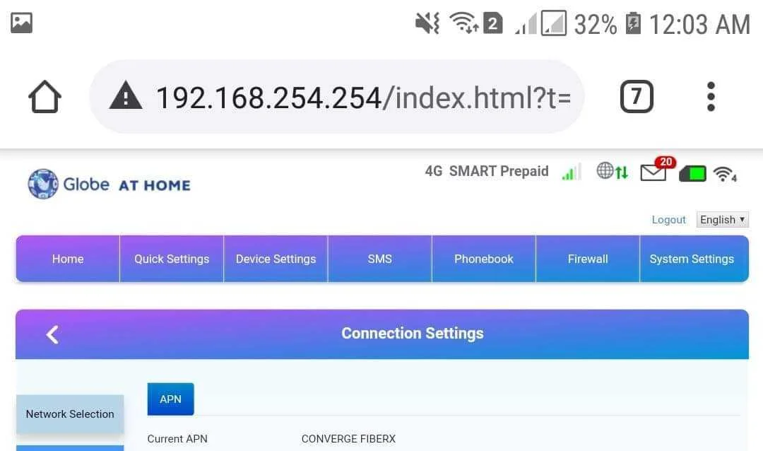

APN MANUAL INPUT
tz_web_special_func=1f
cbange value 1f to 1t

Lods yung bagong firmware ng s10g di mo na ma-access yung admin settings. Yung nabili ko yung ver. nya is s10g_2.03.3. Di ko ma-access yung hidden settings. Na fix na ata ni globe yung firmware.
boss sa part na to tuwing papalitan ko ung #router_setting to #frequency e bumabalik pa rin sya sa #router_setting, tried tapping DHCP thrice pero ganun pa rin, bakit kaya?
