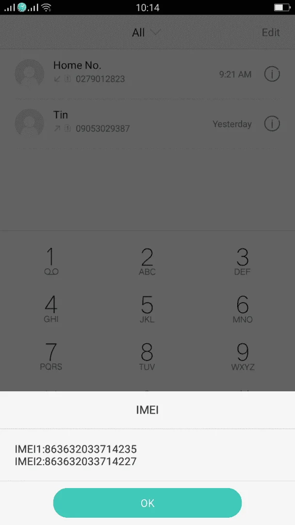

then patayin mo phone mo punta ka recovery mode press mo lang yung power button tsaka low volume button, then iinstall mo sya pa manual
Tapos iinsert mo yung imei via engineering mode.Screenshot_2020-08-16-10-14-16-41.webp
