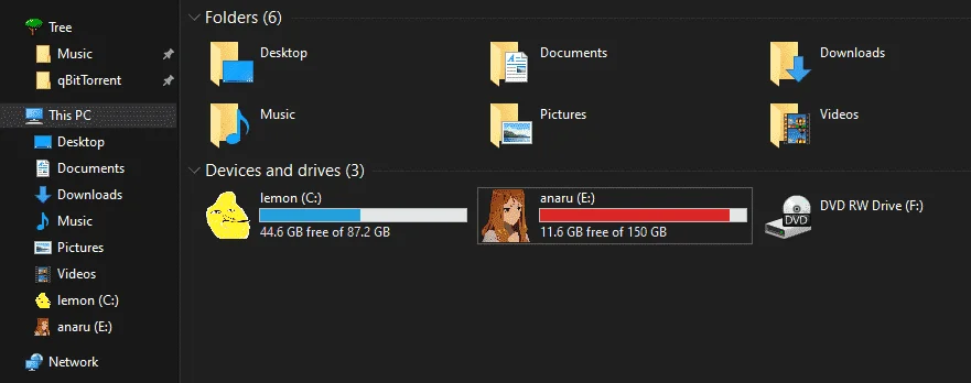

At Oo, 250GB is certainly not enough para sa katulad natin na madaming anime, haha. An external hard drive is a must have talaga, that's the issue with SSD's, ang mahal! Ginawa ko nalang is I separated the OS partition from my personal files, pero as you can tell from the redness, di sapat.

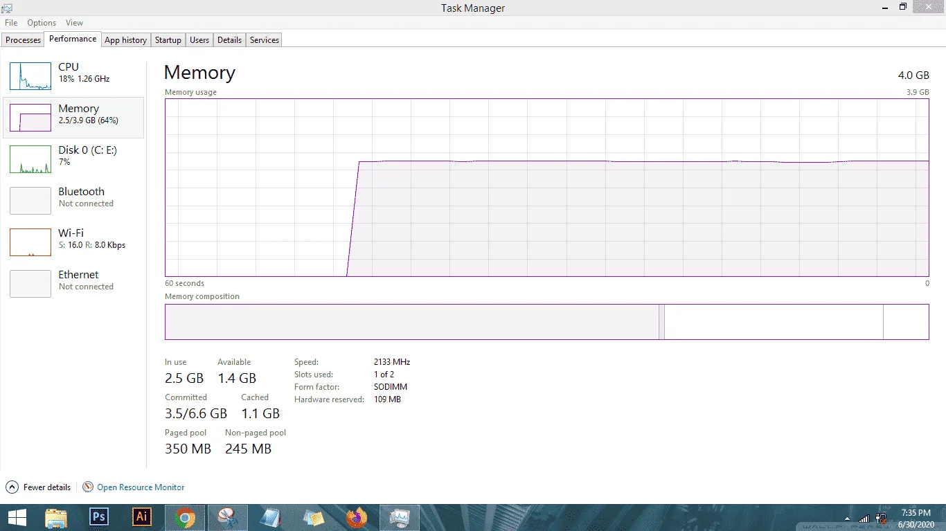

Add ka pa ng 8gb ram if upgradable . kasi sakin naka ryzen 5 laptop ko pero naglalag padin pag marami naka open sa chrome kasi 4gb ram lang kaya planning to upgrade din ako 1500 nlng ata ung 8gb, then tama na mag add ka ng sdd para faster bootup.
how to know if upgradable si Ram ko hahaha.
wala ako makita kay google >.<
If ever na Windows 8-10 ang gamit mo, check mo task manager then Performance then Memory. Sa lower right may "Slots used" doon. Doon mo makikita kung pwede ka maglagay ng another 4gb of ram or more. Sana makatulong. :)
slots used : 1/2
hahaha pwede lagyan ito diba <3
Problem ko na lang pala if compatible or fit ung bibilin ko na Ram hahaha.
Yep pwede dagdagan yan. Kung gusto mo malaman overall specification ng system mo dl ka ng Speccy. Simple lang yon pero makikita mo lahat ng info even RAM brand etc. It's best na same brand pero kung hindi, okay lang rin as long as same frequency and CAS latency. :)
Thank you po sir ♥️
